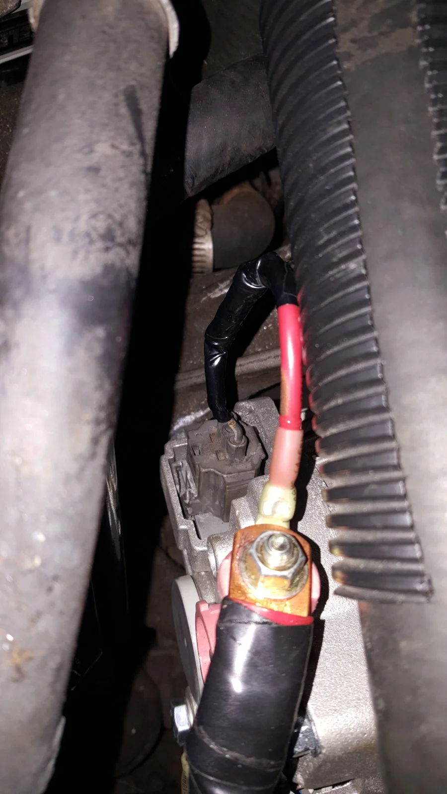

If it is this wire, than I believe it is connected, at least the part that is out of the harness. I had a leaking rear main seal that I replaced but it slung oil all over the back of this engine. The ring terminal is caked with dirt and grease but it is connected. It seems like it is connected to the back of the block or one of the heads tho.

I have a dead green/red alt wire. I rigged my 6g swap as seen in pic, like a 1 wire. I'd like to re do it but can't find this resistor to check it.

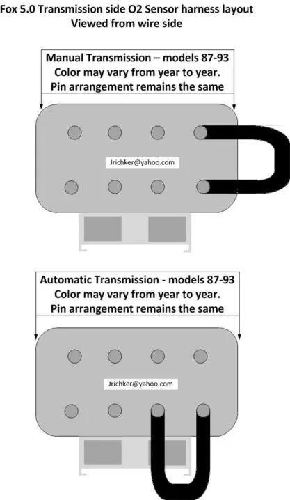

You need to first confirm the jumper wire is in the correct location as there is differences between Manual and Auto transmissions. This connector should be on the passenger side typically under the MAF or on the side of the strut tower.

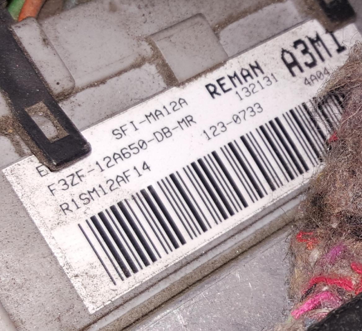

Can anyone tell me what stanglx2002 was getting after here? Do i jumper and then pull codes or test with meter across the shown ports? My computer is from a 93, is that ok?
The jumper wire should already be there. I just wanted you to confirm that it is in the correct location for a manual transmission. People all the time just swap in wiring harnesses and not know there are small differences. Normally the jumper wires is a purple with yellow stripe.
