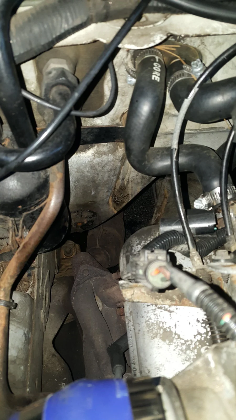

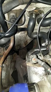

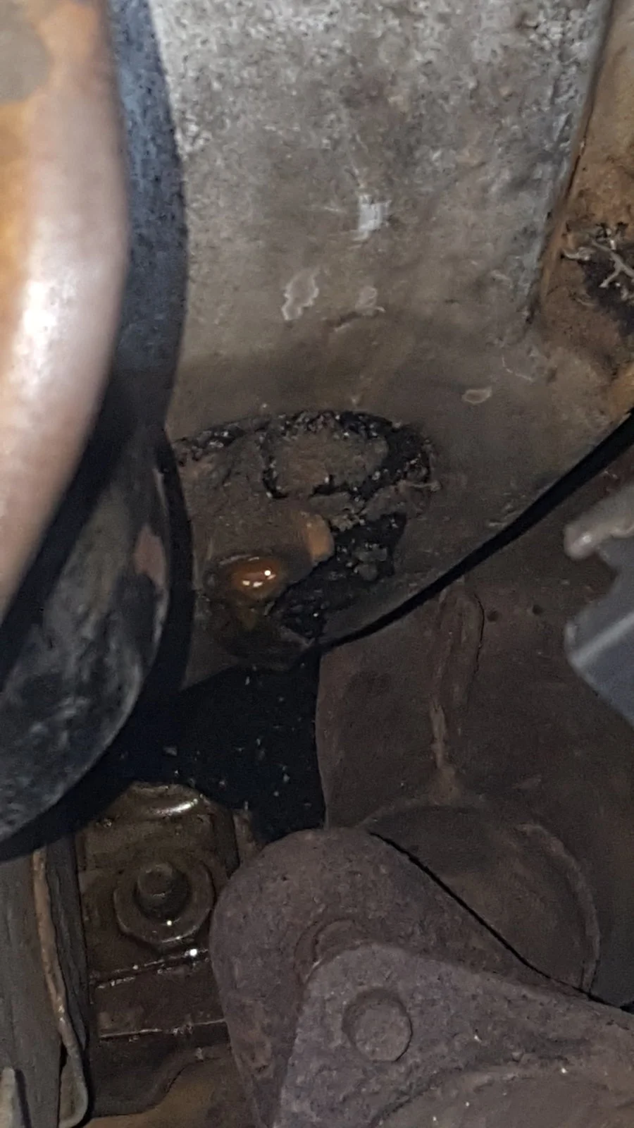

Anyone know what this hole is and why it is leaking so much coolant (distilled water)
