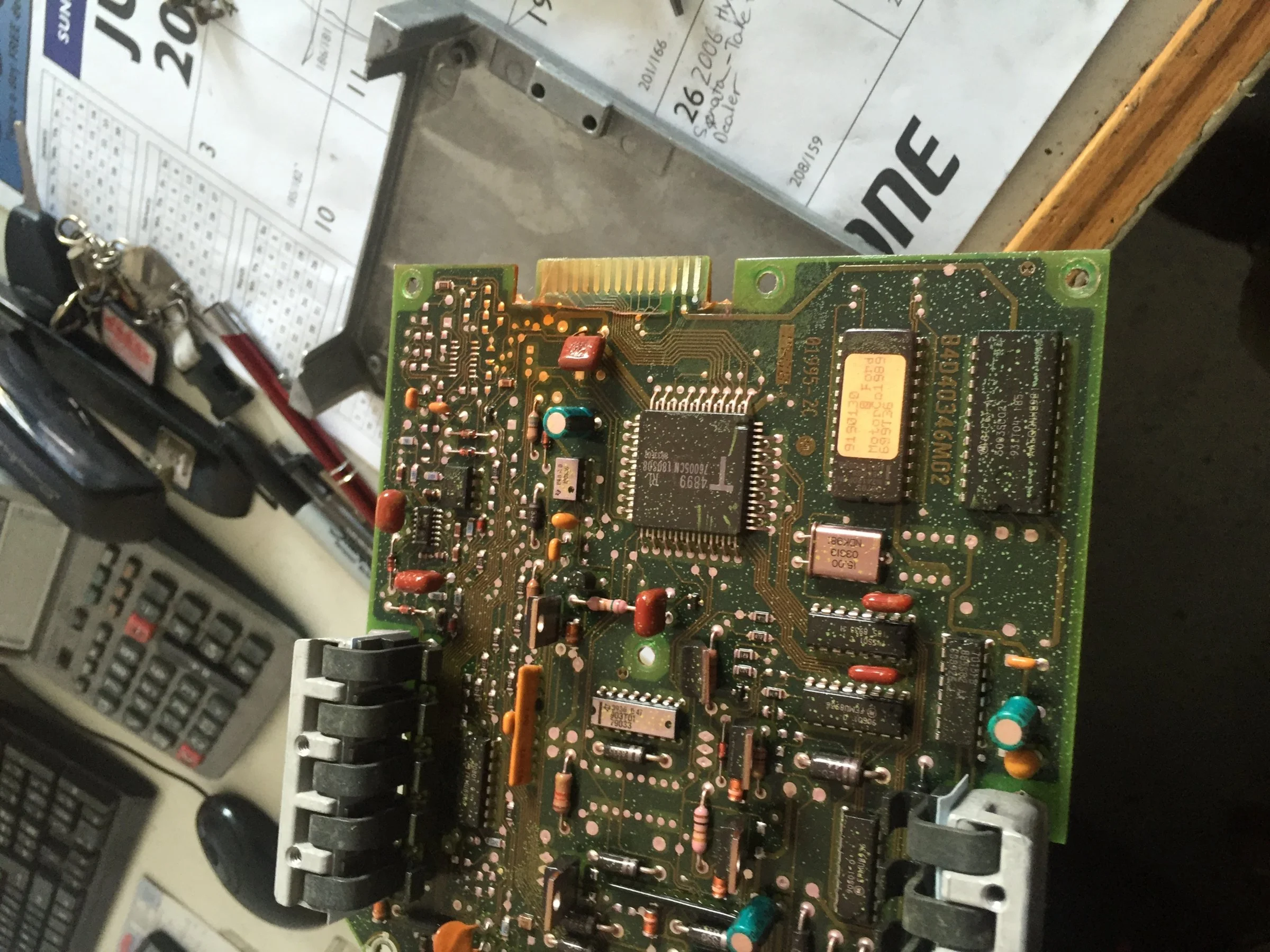

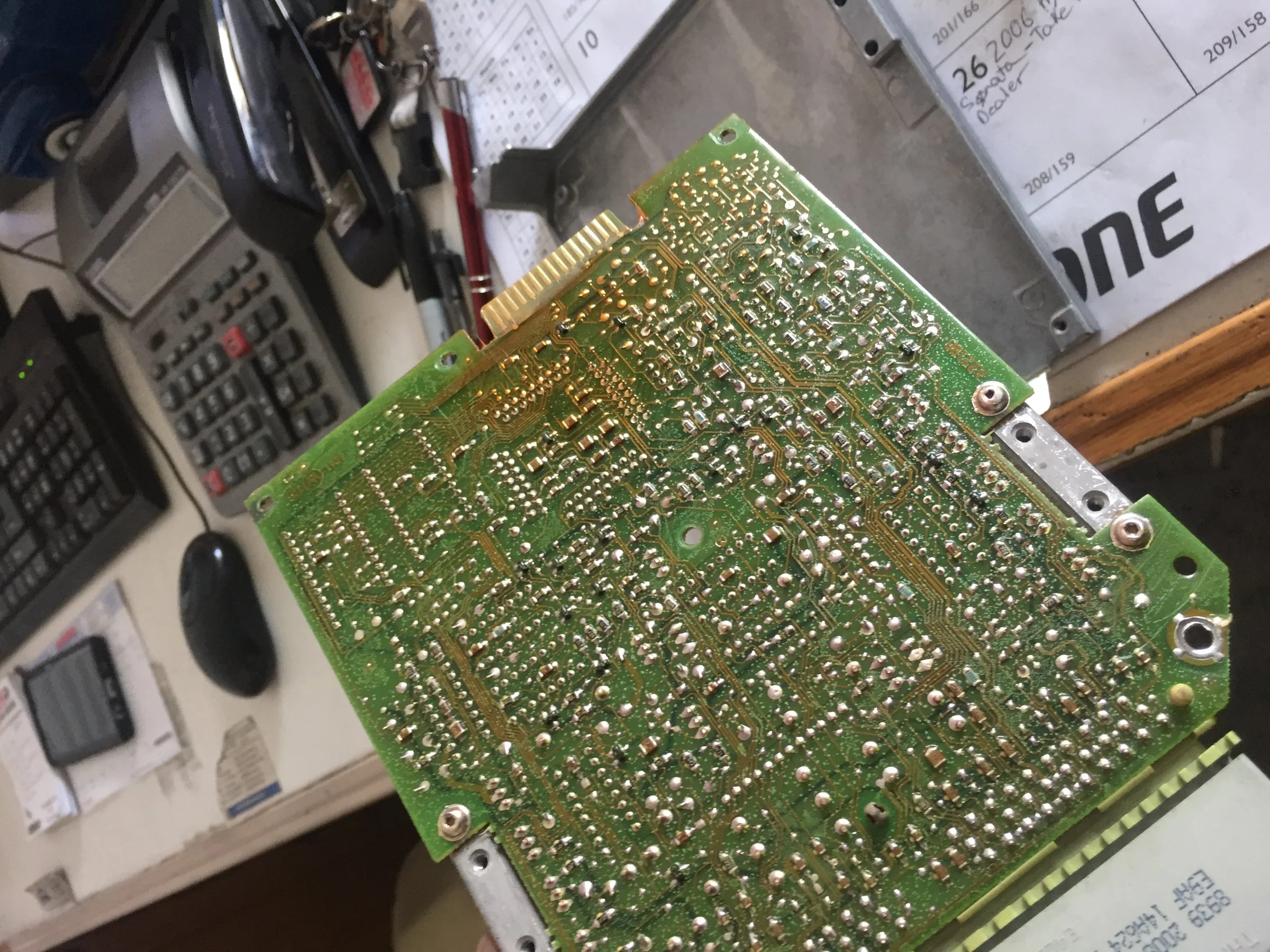

It has a cold air kit 75mm throttle body and the MaF to for it, i will do the noid light again. And recheck, computer is only 120-160$ so not to bad, gonna get one coming just in case.
Put a noid light on the injectors - it sounds like either a loose connection or the computer is flaking out.
The stock 5.0 used 19 LB injectors, the 21 LB injectors aren't going to work well unless you have some sort of custom tune chip.

Well look at this
