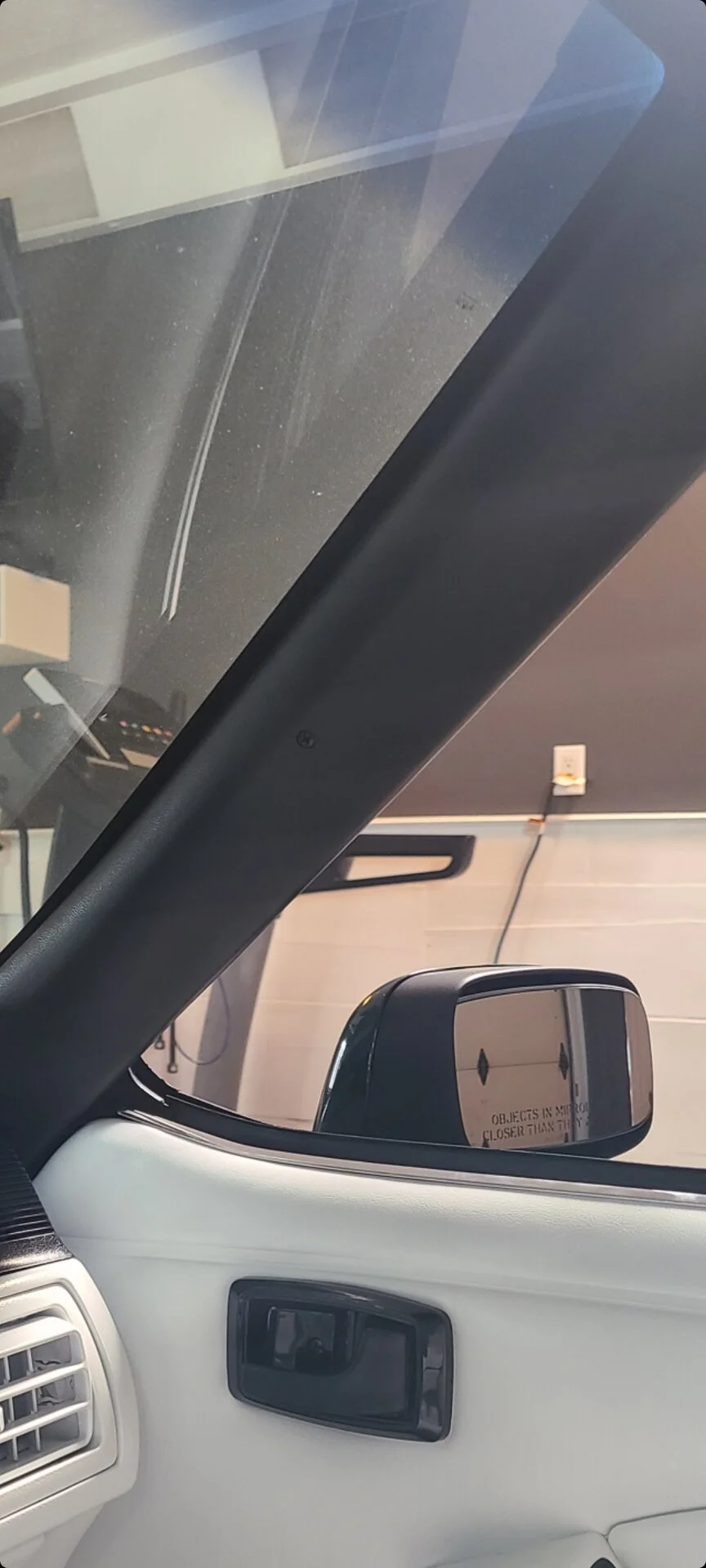

Looking too repaint the interior windshield trim on my 90 vert but need too know the correct color, doesn't exactly look black too me.Thanks for the info Cheers!

It is black. I use SEM Trim Black for mine. Looks factory when done.

Hard too tell in the picture, but it is clearly different color from the exterior windshield trim which is satin black I beleive from the factory.

It's hard to say what has happened over the last 30 years, it could have been painted, I'm sure it has faded and plastic pieces can have a different look than metal parts (your exterior windshield trim). I have never seen a 90 have anything other than black for the inside windshield trim. I could be wrong but I am pretty sure it is black.

Interior Two Tone Color???
My 89 Mustang has Smoke Gray Interior, but the top of the dash, door panels, and around the 1/4 windows was a darker color. I thought it was a dark charcoal gray, but sales guys at both Late Model Restoration & CJ Pony Parts told me the color was "BLACK" and that mine was just faded. So I...
