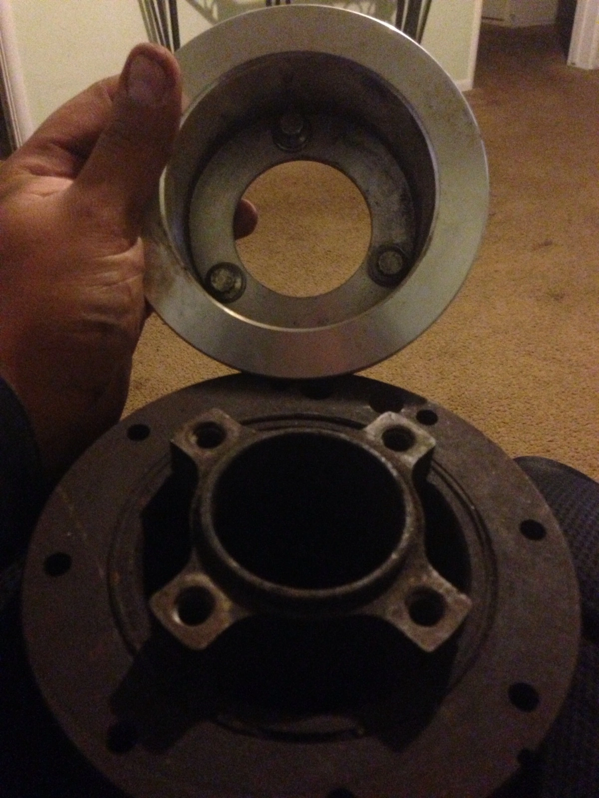

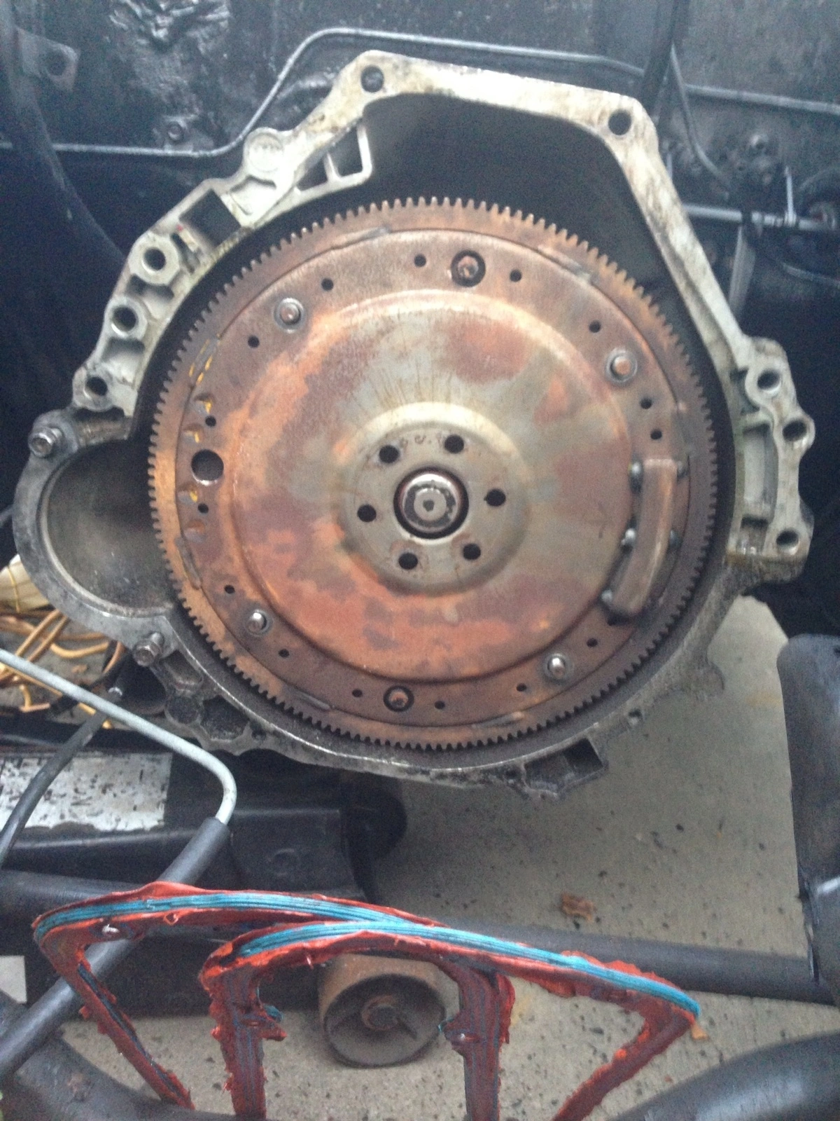

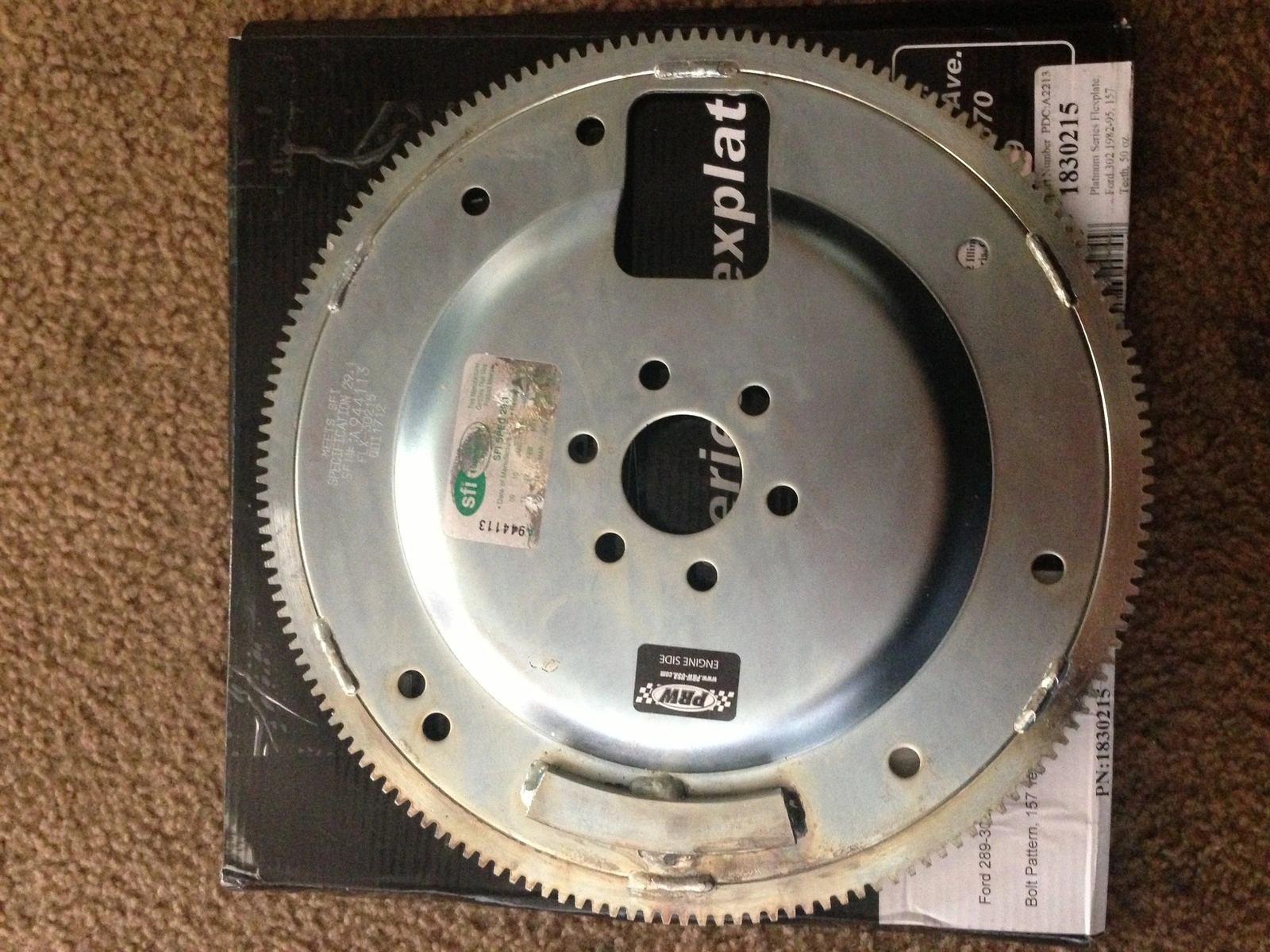

So I'm getting my new 50oz flex plate to fit my transmission today. Excited to finally get closer to completing my project. Another thing I noticed was that I would be able to use the old aluminum 3pc ford racing pulley set because the crank pulley is 3 bolts and the 90s motor has a 4 blot harmonic balancer. :/
I sorry I meant I would not be able to use the old pulley set

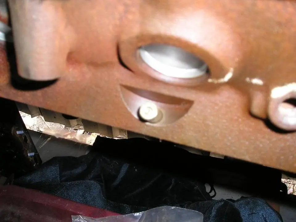

Don't forget the redneck solution to blocking of your origional dip stick hole when fitting the early sump, a .38 S&W cartridge shell.
Mine has been there for 11 years. Pardon the blured pic.
Tip, ensure its not live.:rolleyes:

Great idea! Thanks, I was just thinking about how I would clog that dipstick hole.
Thanks for the pic too
