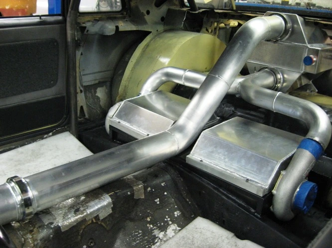

Thought I'd share these with you, this is a car built by Bridge Engineering they are near the top in the Modular world and do top notch fabrication.
Obviously the yellow car seriously intends to compete in a legal class of competition. TWO of those deadly turbos( :rolleyes: ) encased in what is clearly light ga. steel w/aluminum tops. w/ the cold sides both hangin' outside of the aluminum boxes. I'd follow this car if I were you 90stang to see if he encounters any difficulty getting passed through tech. For those concerned that your 1/8th steel plate isn't adequate, or just plain dangerous, this may be the model to quell those concerns. I spoke w/ one of my friends still currently in the circuit and he said that you'll see a bunch of this starting to show up next year as these guys attempt to balance the considerable weight of (2) 88-101 mm turbos by getting it off the front end of the car. This whole damn car reeks of cool, obviously pro-built.

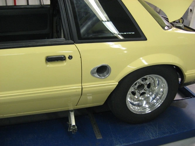

Love his side intake.:nice:
Bet you didn't know that you were on the front edge of a trend, did you?
This is in the top 1-2 cars I have ever seen built with a rear mount outside if the STS shop.
Note how the wastegate is @ the bottom of the bend on the pipe, just the way you would want it.
The exhaust pressure will help push the wastegate open and allow it to work very efficiently. Neat set up and use of the water to air intercooler too.
Great picks and work quality. Rick 91 gt is right, top notch.
Still, my hats off to 90stang5speed for a great build ,thinking outside the box, especially for doing it all outside in the driveway.

With out a doubt, that is a Bad A** car! I would love to have done a twin set up like that but this single is braking the bank as it is. Maybe in the future:). I wanted to leave the compressor side out of the box like they did but with all the concern for safety I decided to box it all in. I think what I might do after seeing that is build a divider wall between the hot & cold side but keep it all enclosed under the box I have now. It feels good to know Im not the only one to pull this crazy idea. It's sucking the originality out of it though lol. Still an awesome car. I hadn't seen all these cars at the time. I wish I had, copying the idea would have been easier than trying to figure it out.
I agree but, the more I look at that twin set up, the more it makes me want to flip my turbo around & route it in a similar way. I can see a few benefits to doing it their way and only 1 disadvantage. That is a pure track car I'm sure. Mine will see street time & maybe some 500 mile trips to KY. I need to be able to run an air filter when not at the track. my setup leaves more room for a filter box. They have two 90* bends for the air intake where my single setup will be more of a straight shot. I doubt that will make much difference though. I Really like their setup. I will most likely finish what I have started but, if I ever go twin, I might have to copy that.

I didn't want to run the risk of sucking some road debris in through the side scoop and damaging the turbo. Eventually that debris would make it to the engine & tiny pieces of grit inside the cylinders would be a bad thing. Even at the track for just a 1/4 mile I will probably use that screen idea so I don't suck in something.
