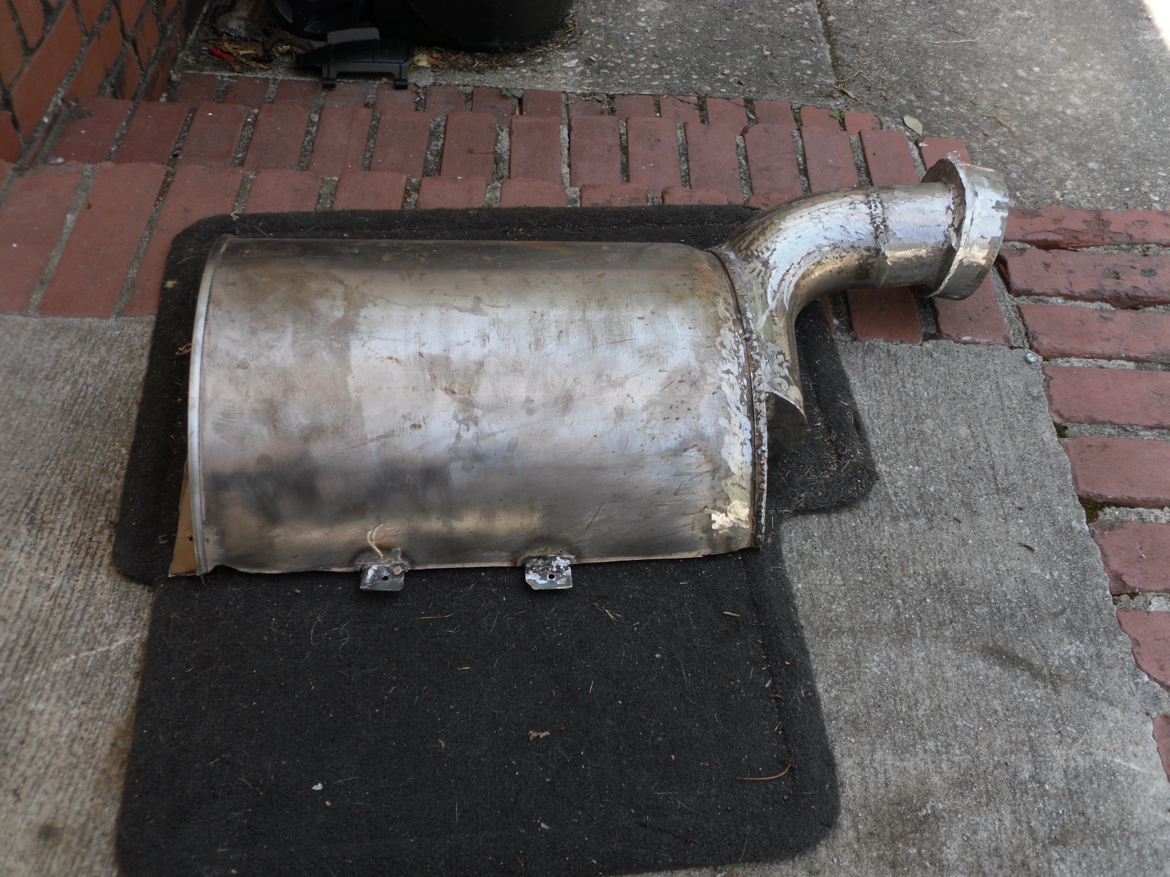

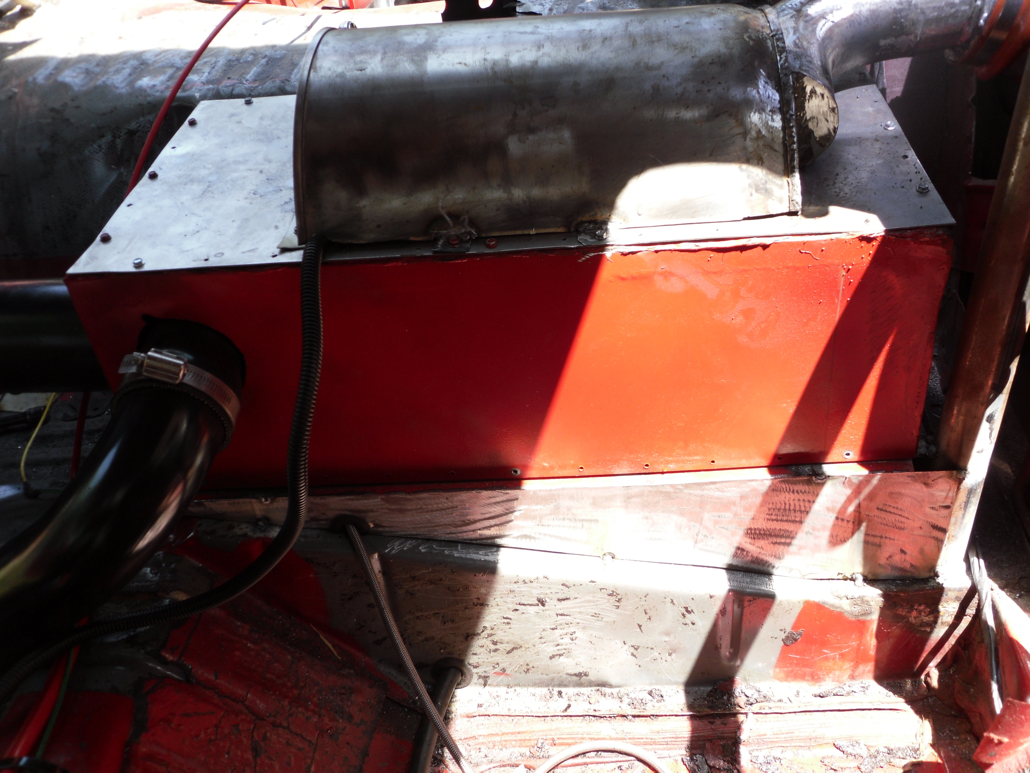

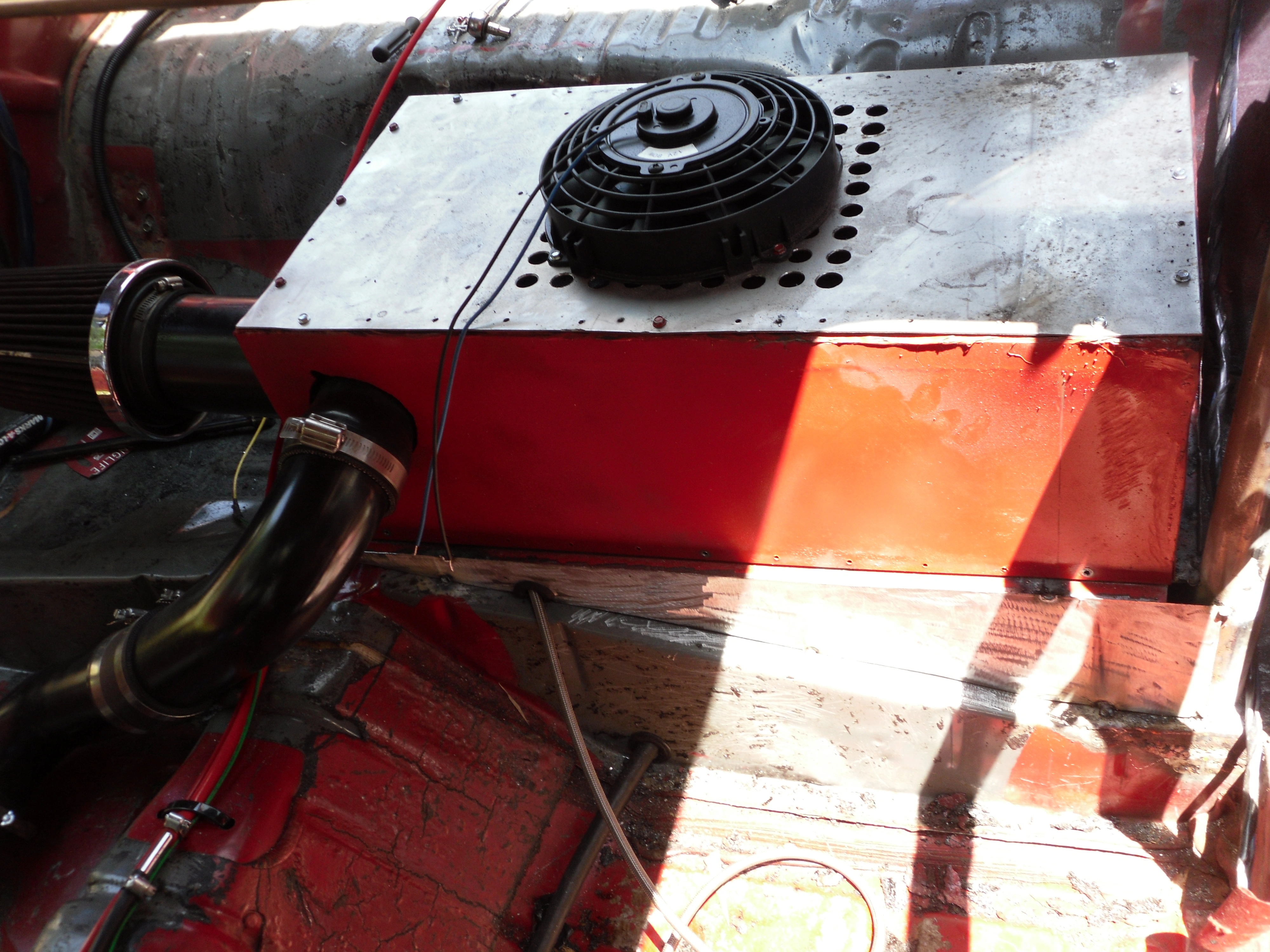

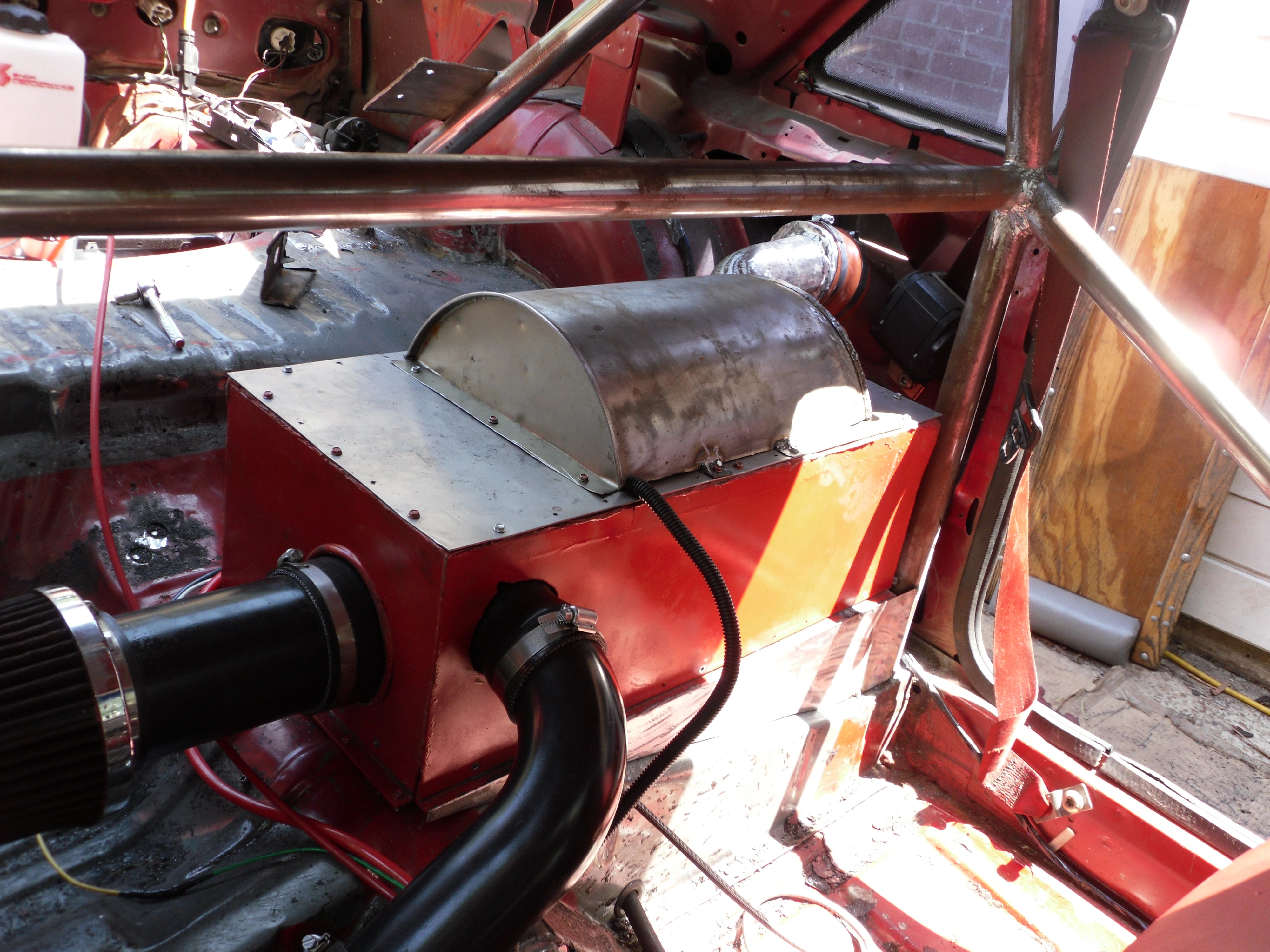

I was able to get a little work done on the Scatter Shield / Heat Extractor. The lower section of the Scatter Shield is only tacked in Right now. I put a gromet around the oil feed line & relocated the oil return line with a gromet for that as well. The Heat Extractor fan isn't wired in yet & the ducting needs to be sealed up but, I wanted to get some pics up. Im going to try to get the tune up loaded and get a sound clip posted soon.
Here is the fan mounted to the Scatter Shield
Here is the Heat Extractor duct all welded up.
Here is the lower section of the Scatter Shield tacked into place. You can also see the gromets for the oil feed & return lines.
And Here is the Heat Extractor duct mounted to the Scatter Shield.

I have a question, and forgive me for asking if someone has already asked but,....How hot do you s'pose the top to your box will get?
I'm thinkin' melt the hell out of plastic hot.
Granted, running the fan will force the heat out rather than let it rise, but what happens after you turn the fan off? I'm thinking that (here I go thinking again) you're gonna have to run that fan for about 5-10 minutes after ea. run to blow the heat soak out of that turbo
