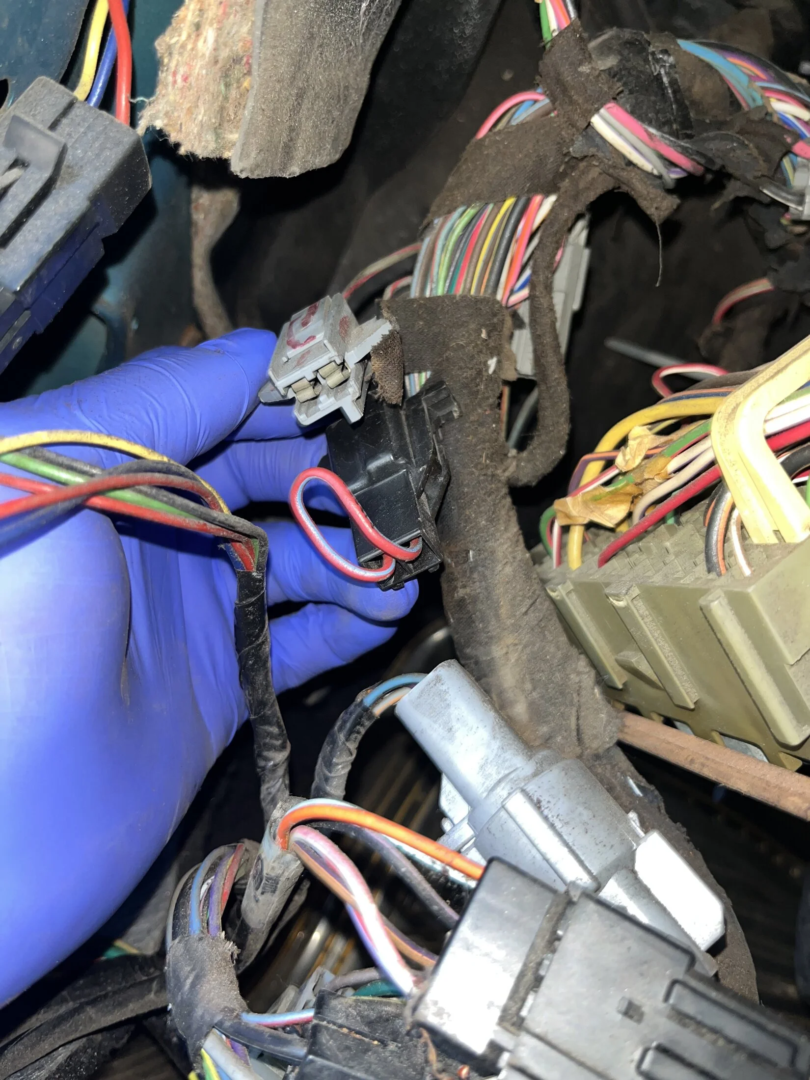

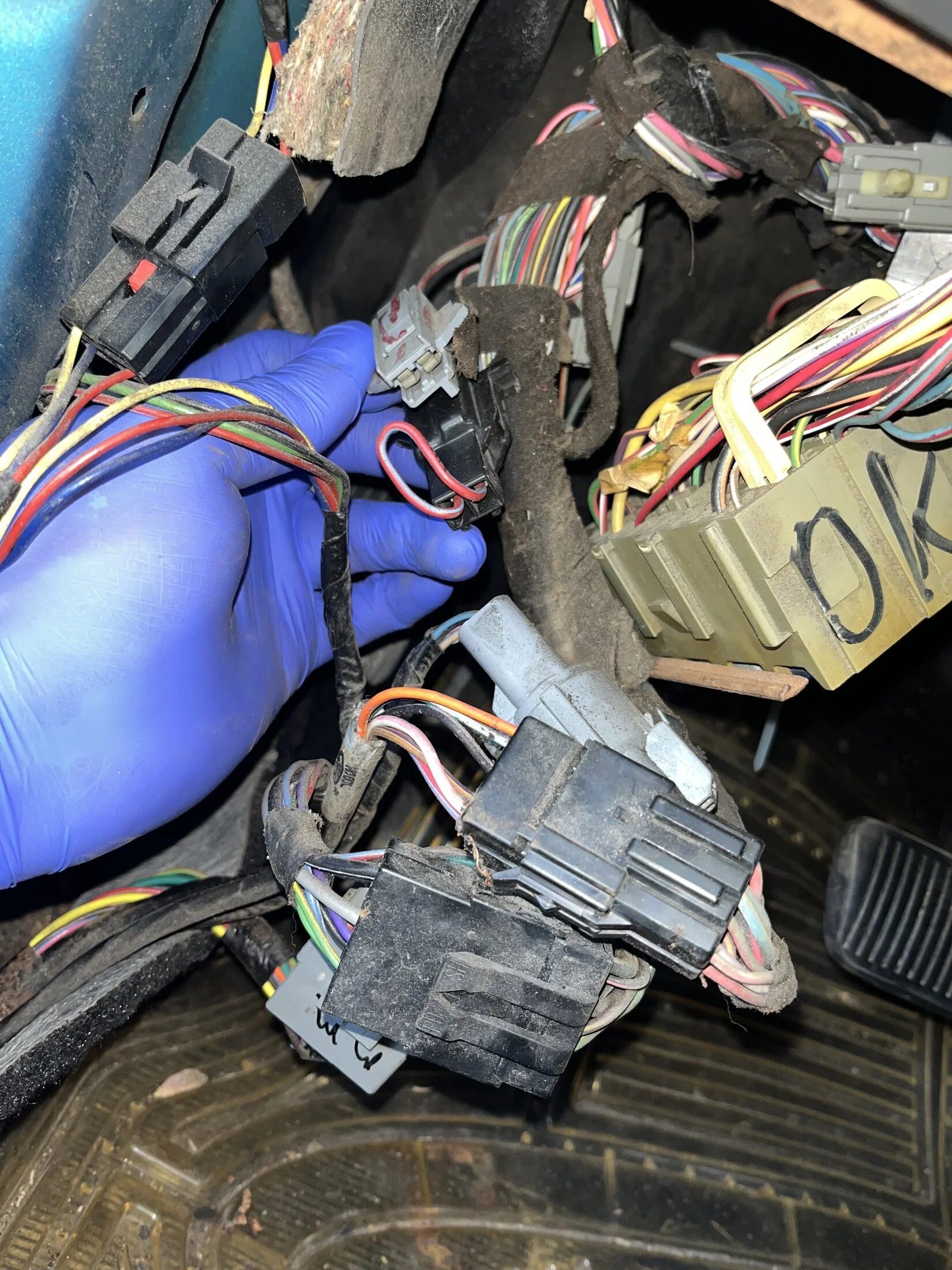

I will study this but my 1993 4cy is auto, this thread addresses manual t5 4cyl cars that don’t have plug for ngs because they didn’t have this plug from factory.. but my 4cyl is a original auto car and I will be converting to t5 , so maybe I have this plug in passenger kick panel I will see .. ford did so much changing up and I really see no rhyme to reason, only confusion and lots of that but I will get it because it is what I do. Ron Francis does sell the t5 manual transmission harness and so does lmr but again where does it plug ona 1993 4cyl auto car once I convert to manual and 5.0? I haven’t looked yet but I will be pulling kick panel and seeing if there is a empty plug for such a harness..
As far as I know from 91 thru 93 Ford stopped putting this harness in the 5.0 AOD cars and all the 4 cylinder cars but the 5.0 T5 cars will have it.
So for your 93 you need a 92.5-93 ECU harness, 87-93 manual trans O2 harness or repin an AOD harness (believe all those years will work but double check), 87-93 injector harness, and the NGS harness. You can make the headlight harness work with the V8 alternator location or just get the V8 harness.
I pulled everything from a 93 manual car (with the exception of the NGS harness) so it was plug and play when air swapped mine 21 years ago. They were a bit more plentiful then.
I have the 1993 5.0 convertible donor so if I have to I will use the alternator headlight harness if need be..
