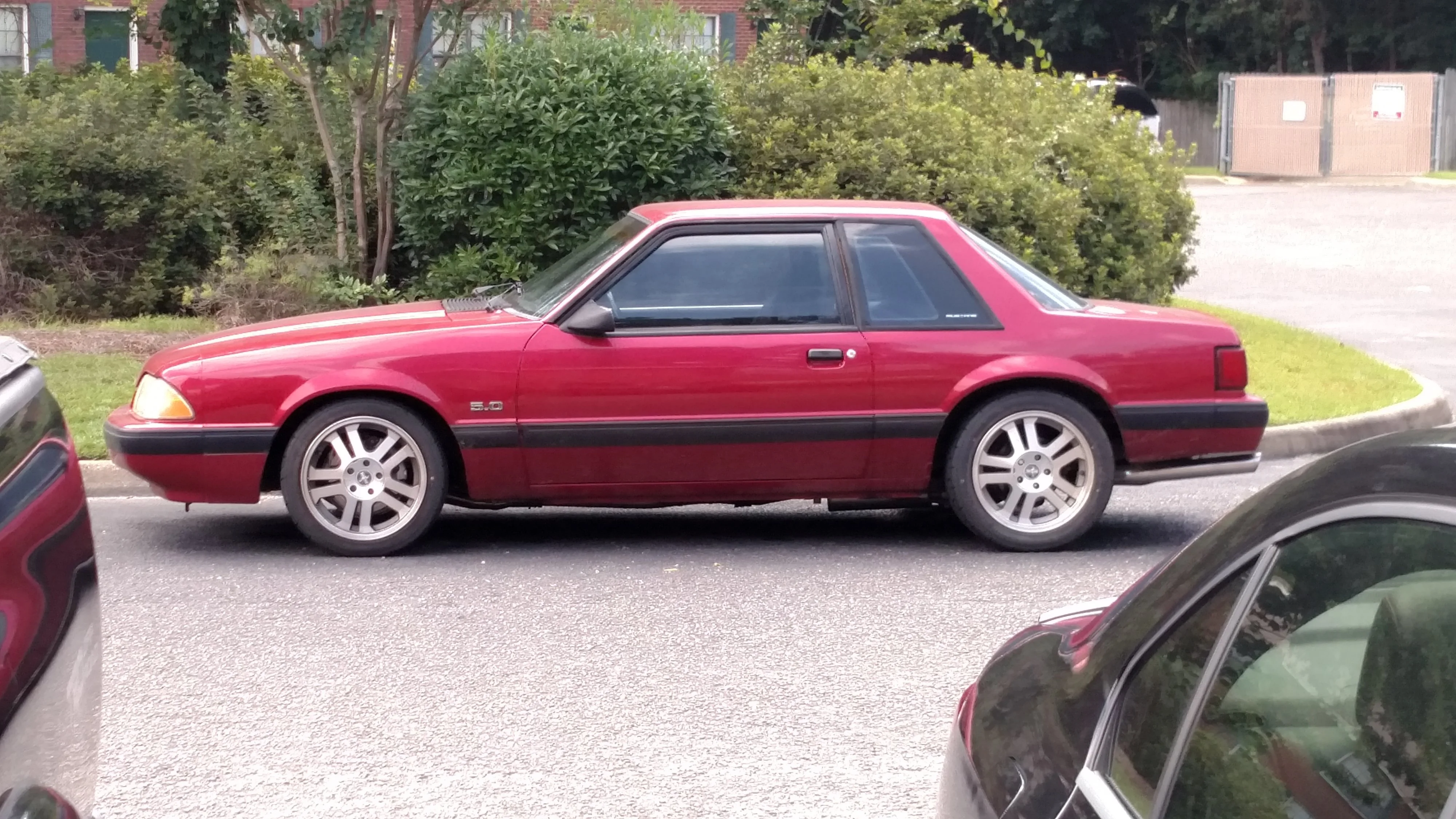

Here is my 91 that I have owned since 06. For the first 9 years it was my daily driver and only car. The next two years it was parked simply because I didn't have the money to fix the things that had broken. Over the past year to year and a half I've been working on fixing it back up into good, driving condition. This is the most current picture, and it doesn't show how bad of shape the paint actually is. I'm back to driving it on a daily basis now though there are still some things to fix. I will update more later after work.

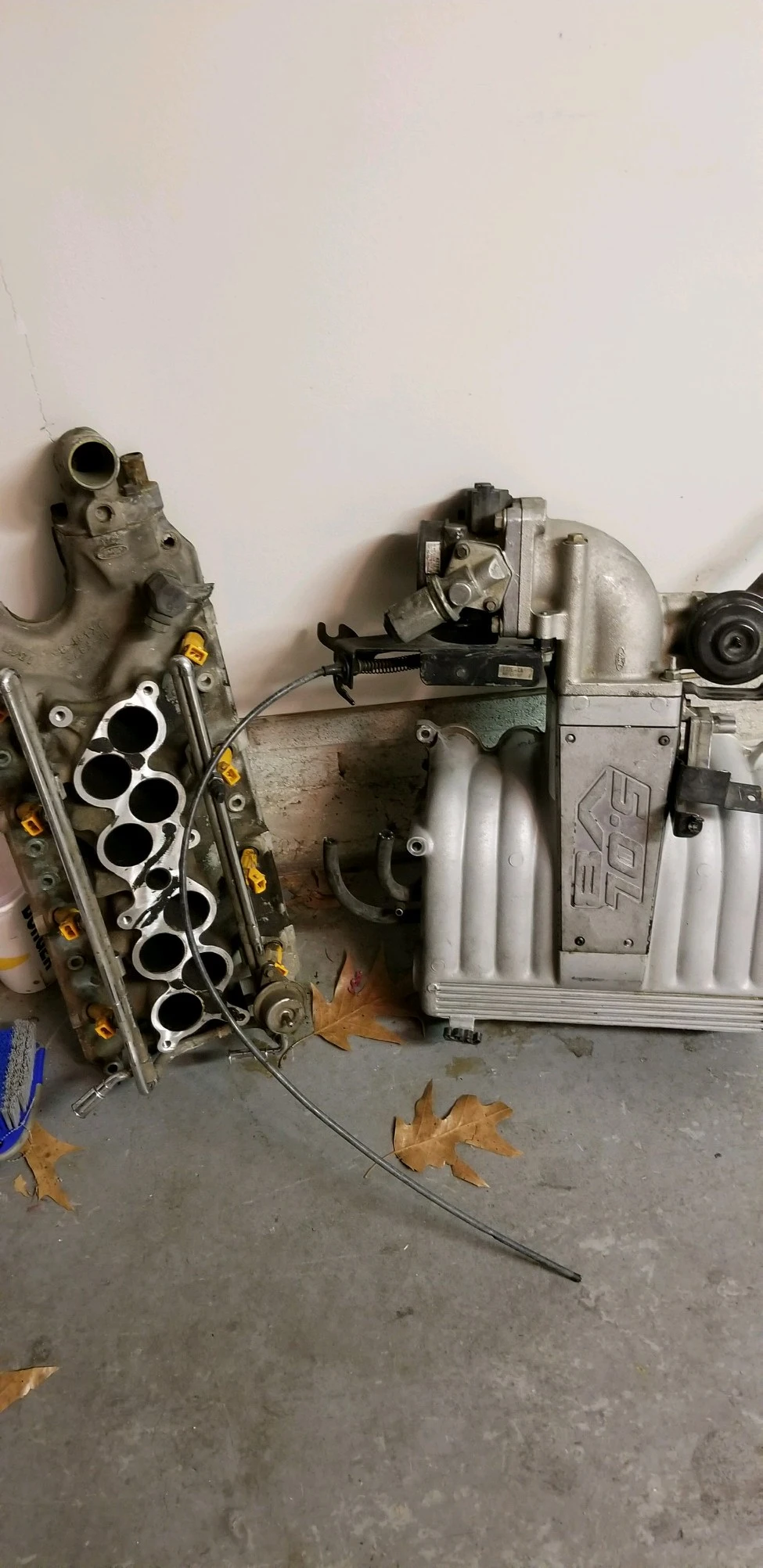

Got a good deal on this intake yesterday. I've never ported one before but would try it out if I can't find some one good to do this one for me.

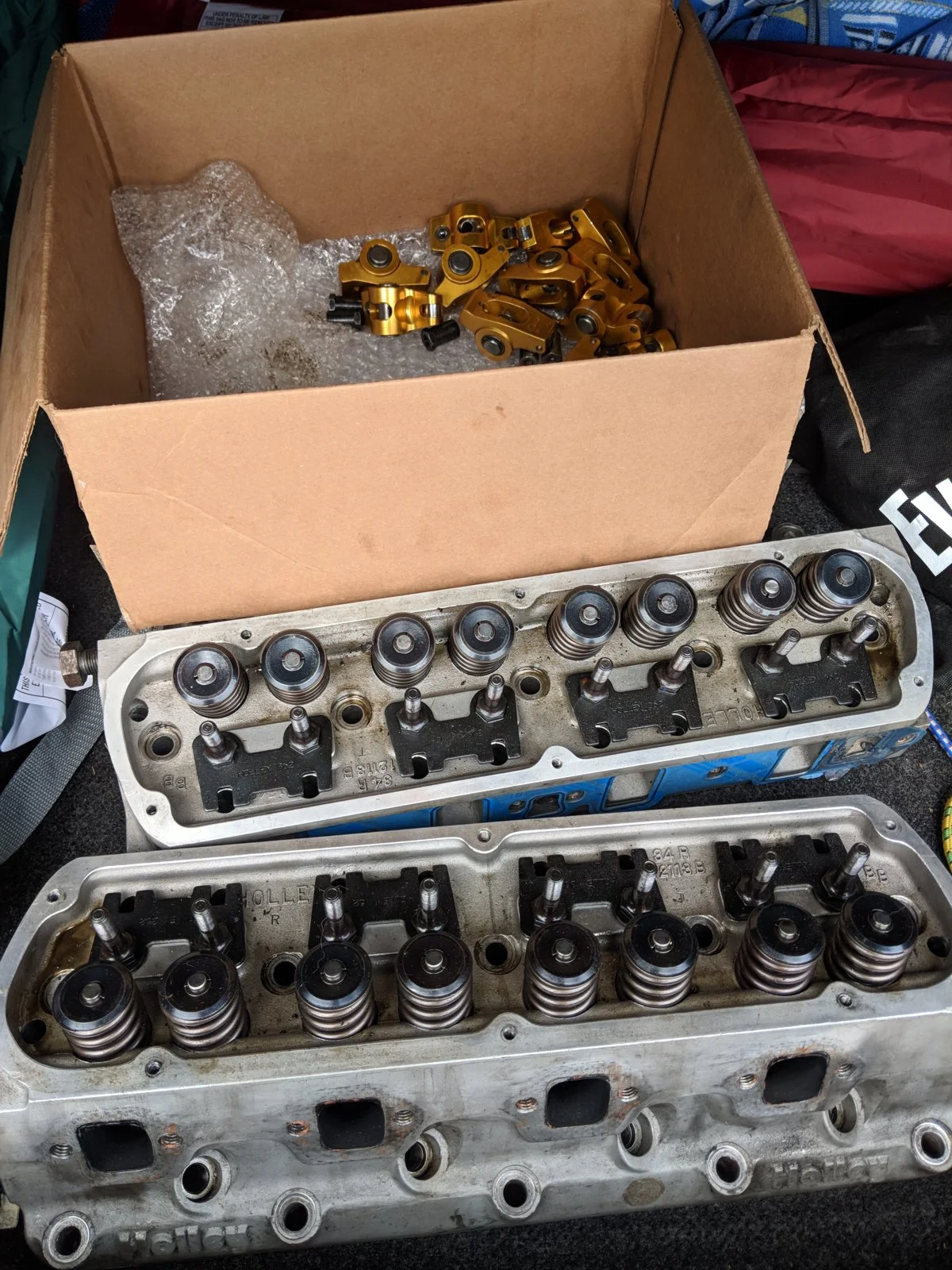

Just picked these up at a good price. Holley systemax 2 heads and crane gold 1.6s. Can't be too picky when working on a tight budget. Would anyone here know if I can reuse the factory valve covers or will I need to find new ones? Still on the checklist are to get the lower intake ported, buy arp head bolts, a phenolic spacer, injectors, gaskets, and potentially valve covers.

I haven't posted in a while because I've been busy with a few different things lately but I finally have all my top end parts I'm going to install minus gaskets. Can anyone recommend head gaskets to use with Holley systemax 2 heads and gt-40 intake?
