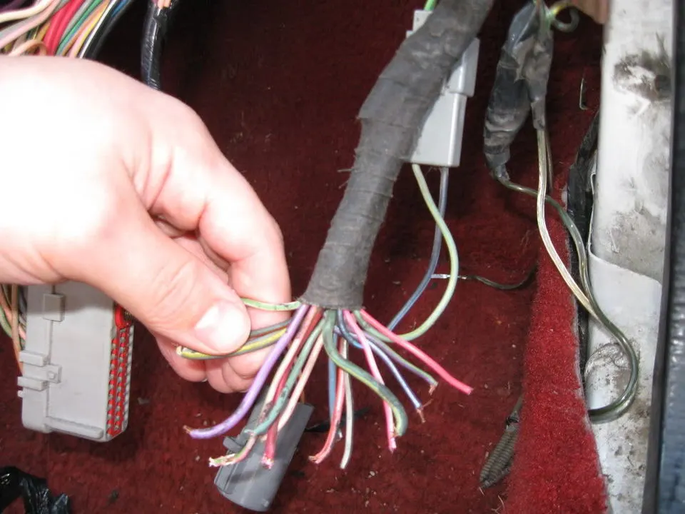

well the guy most likely lied to me it was through ebay, and he said it was from a 1991. everything plugged up under the engine bay to the t. its just on the end of the harness right beside the computer connector on the passenger side kick pannel is where im runnin into the problem! there are the two connectors that i have no clue to were they run. and it cannot be to far off as far as the year of the harness for the shear fact that it has the plug for the maf and the bps. i can take some ill post em shortly

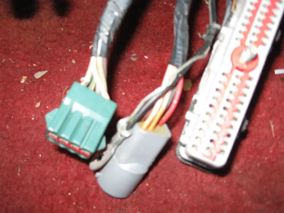

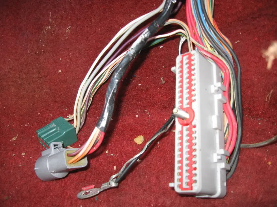

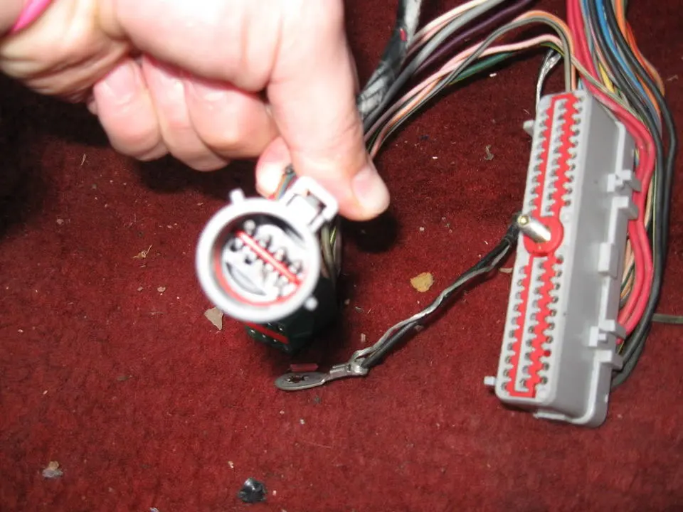

okay i think i did that right. i added some pics or links to em, and the green and the grey connectors are the ones im questioning about! and the picture of the group of hacked wires is what comes down out of my kick pannel, and IDK what they go to. i figured possible the mates two the two connectors!

ok,it looks like your is missing the other green connector that would run from up and behind the dash?or are the cut wires the ones that run inside the kick panel and run to power the windows and door locks in the door?I have and extra harness I will look at tomorrow,sorry it's at our shop

well im almost positive that it isnt the window or door locks for the shear fact that they work when the power is hooked up. i think its the dash harness.

The wires run into the dash harness,wires also run to the ign switch.If you can't find the green connector, I'll give you one just pay for shipping
