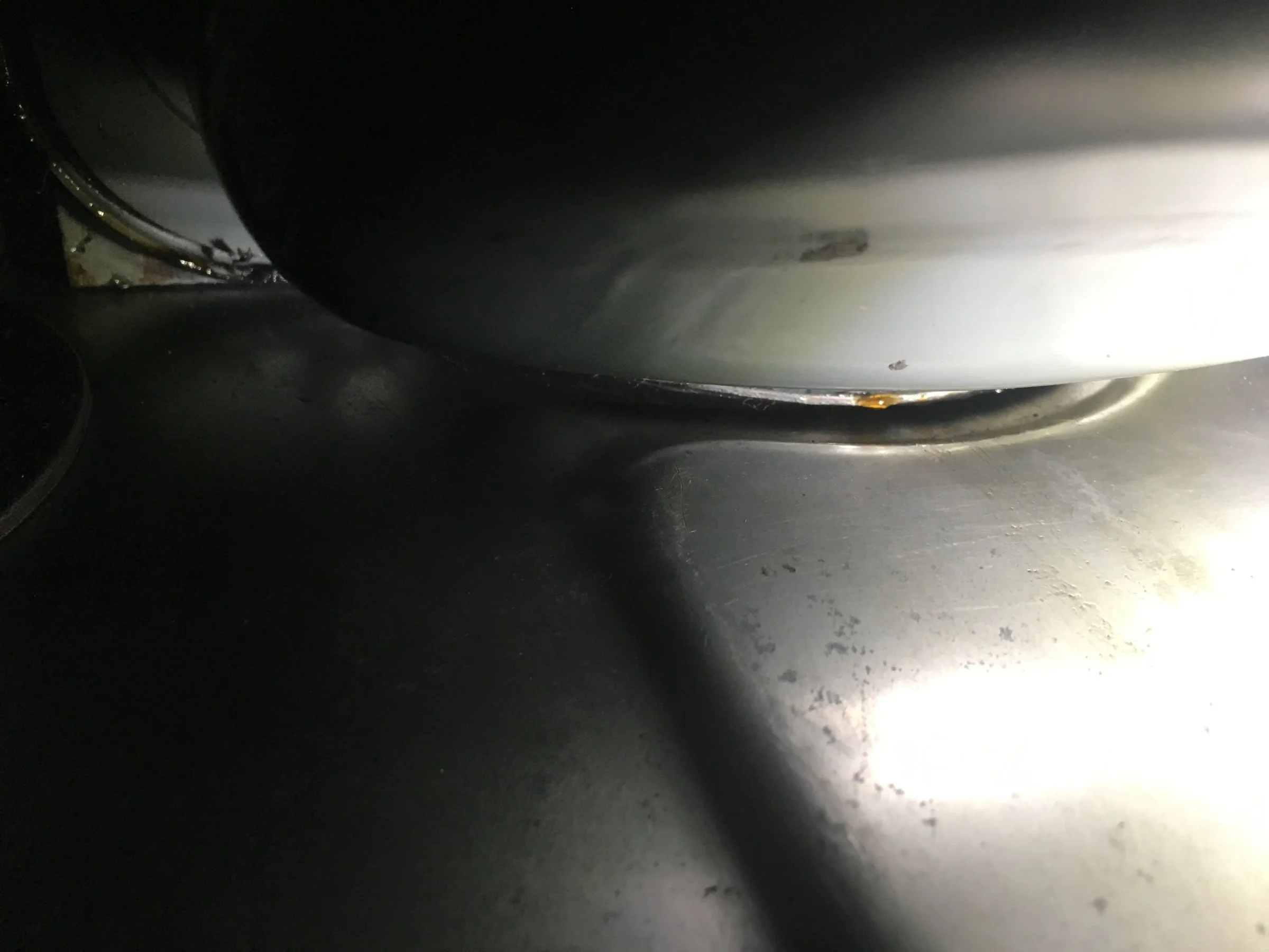

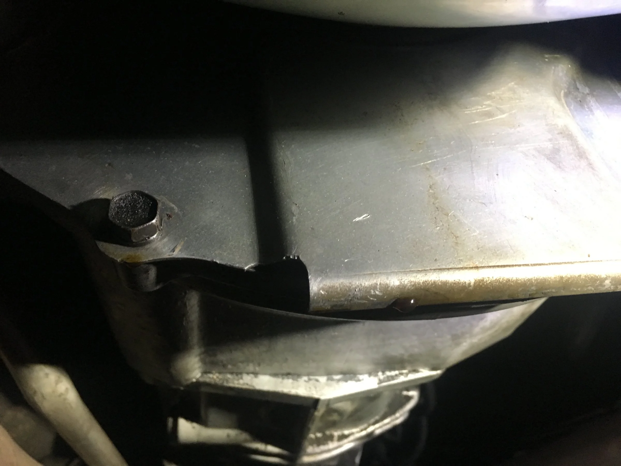

Still fighting this stupid oil leak...cleaned PCV valve and screen, oil pan gasket with new moulded Felpro and I had the Rear Main Seal replaced. Still small drip from the bell housing and the one but beside it...take a look at pictures and let me know thoughts.

I'm not too sure...the motor is a built 306 with roughly 25k on it. I do see a little wet oil from the back of the valve cover on the drivers side...maybe that's the culprit.
I just bought the car about a month ago...it's had 2100kms put on it in the last 8 years.

How do I even go about diagnosing either option without pulling the motor?
Fingers crossed its just the valve cover gaskets...but not sure if it would cause the drip at that location.
Oil will run down the path of least resistance, like water, it looks to me to be a rear main leak, watch to see how severe it is. The seal could have been installed dry or too much time between install and start up.
I bet it's the seal. My replacement seal leaked way worse than the original one. I ended up replacing that one with the expensive Felpro Teflon that has to be installed dry. That fixed the issue.

Engines invariably are tilted rearward, thus making nearly any leak near the top rear come down the backside. Any leak point between the engine's rear and bellhousing must be accessed with the transmission/housing removed. Eng. need not be removed. imp
