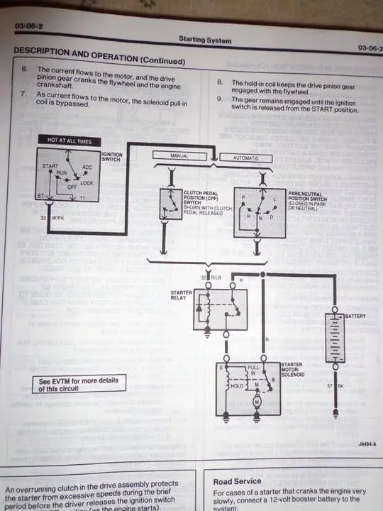

This Spring I went to start my 92 fox for the first time since September the previous year. It wouldn't start with the key. I was however able to start it by arcing a screwdriver across the starter solenoid studs. After starting it like that for a few months I finally got tired of looking ghetto. So I did some research and replaced the ignition switch. It still won't start with a key.
When I turn the key, I noticed a beep from my MSD-6AL. When I did some research on that I found a lot of people experiencing this beep were installing their ignition and trying to turn it over for the first time. My setup, however, has functioned previously.
My primary question is this: since I can start the car by shorting the studs on the starter solenoid and run it for hours, what can I rule out? I'm not an electrical guru on these early EFI engines but it's obviously not the distributor, plugs, MSD ignition box, starter, or wires so I'm hopefully looking at a cheap fix. I'm thinking it is the starter solenoid itself. But can I rule out the coil? Anything else I can rule out? Thanks.

Pretty much your ignition. As long as the key is in run position with a functional ignition you could technically push start the car. If its a clutch. The key in run gives everything power. All turning the key to start does is the kick out the gear and turn the starter.
Maybe ask someone for a wiring diagram of the ignition circuit. Someone might have a better one than this. This one is from a 93 5.0 service manual.

Maybe check the micro-switch for the clutch pedal. It won't let the starter engage if it thinks the clutch is in.
Since you said you replaced the ignition already I would venture thats not it. Diagram shows after ignition you have the clutch pedal switch, starter relay and solenoid. I would say one or a combination of those three might be bad. You know the starter works already.

Forgot to mention the car is a stick...I drove the car with cruise control on and pressed in the clutch. Cruise control kicked off. That rules out the clutch pedal switch. I'm probably going to replace the starter solenoid even though it's only a few years old just because it's the next cheapest part and easy to replace.

Update: It was the starter solenoid. Got it at Autozone for less than $25 and it has a 3 year warranty. Same thing I bought from one of the online mustang part suppliers and cheaper too.
