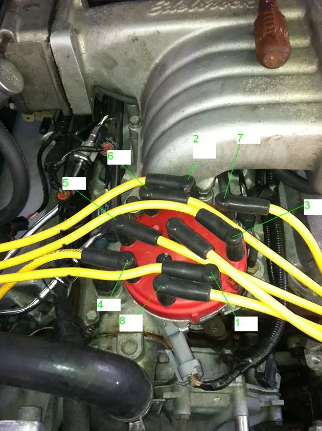

- I went to check the timing again and traced #1 and noted that it appears to be 180 degrees out give or take. So, I checked em all. I think the previous owner put the distro in out of whack. See attached. Presuming I am not blind, I recognize that 1-4 are pass. Side, 5-8 are drivers side, front to back. That is what I used to trace this. They appear to be on in order, just almost completely 180 degrees out. So, I presume that maybe the previous owner put the distro in backwards and just adjusted the plug wires. Not sure how that would impact me and the issues I am having, but it doesn’t explain the fact I have put a couple thousand miles on this car since I got it in June and then ALL OF THE SUDDEN at one stop light it started doing this. Maybe I am wrong. Again, see attached image. I am having a hard time wrapping my brain around this one and what it could possibly mean. Guy claimed to have put an e303 in here not too terribly long ago. I am REALLY starting to question him knowing what the hell he was doing… (See dizzy.jpg)
Hope this all helps. I am at a loss here. Thank you all for your help. I am sure its probably something stupid and simple that I am overlooking. I just want to get her running again so I am have a stable base to work with.

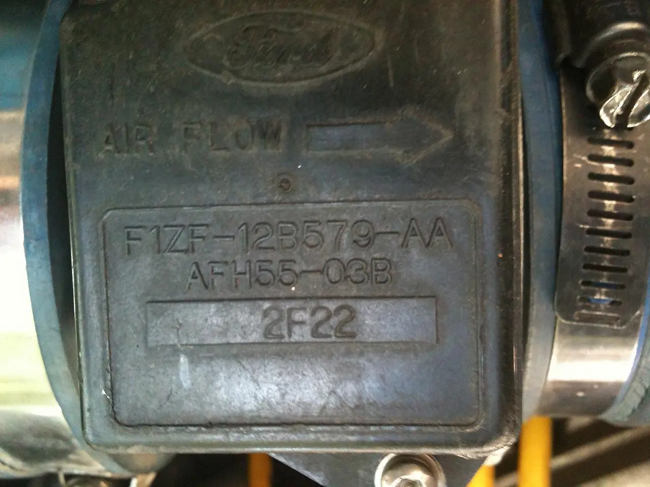

F1ZF-12B579-AA. Below that I see AFH55-03B (does this mean 55mm?). If so, is it safe to assume that they are NOT matched? I have no idea what the computer is adjusted/calibrated for. It looks like its been pulled out before, but I have done nothing more to it than give it a quick look see, without moving it.
Having said all of that, is this something that would cause the sudden total un-driveability issues when it was at least functional before...?
Image attached.
