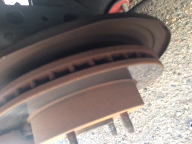

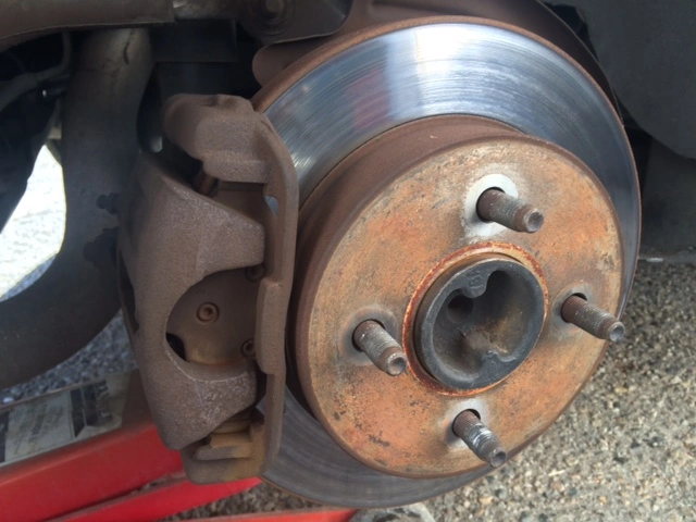

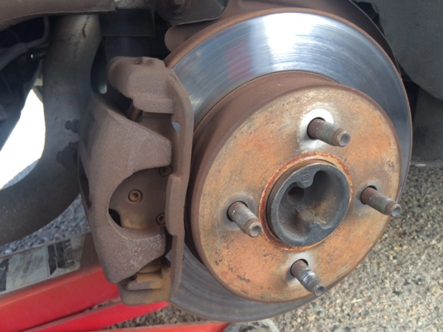

Here's some pics.
87-88 Thunderbird turbo coupe / 1993 Cobra rear disk brakes.
VERY popular retrofit, and a few vendors packaged kits for these (SSBC was one).
https://lmr.com/item/LRS-2552APR/1993-Cobra-Rear-Caliper-Pair
If the conversion was done correctly, a 1" bore MC and a larger booster should be in the engine bay. A closer look at the MC might reveal some adapters used for the brake lines to swap from the OEM MC.
Hopefully, they didn't leave the OEM MC in the car..if so you'd have soft brakes
