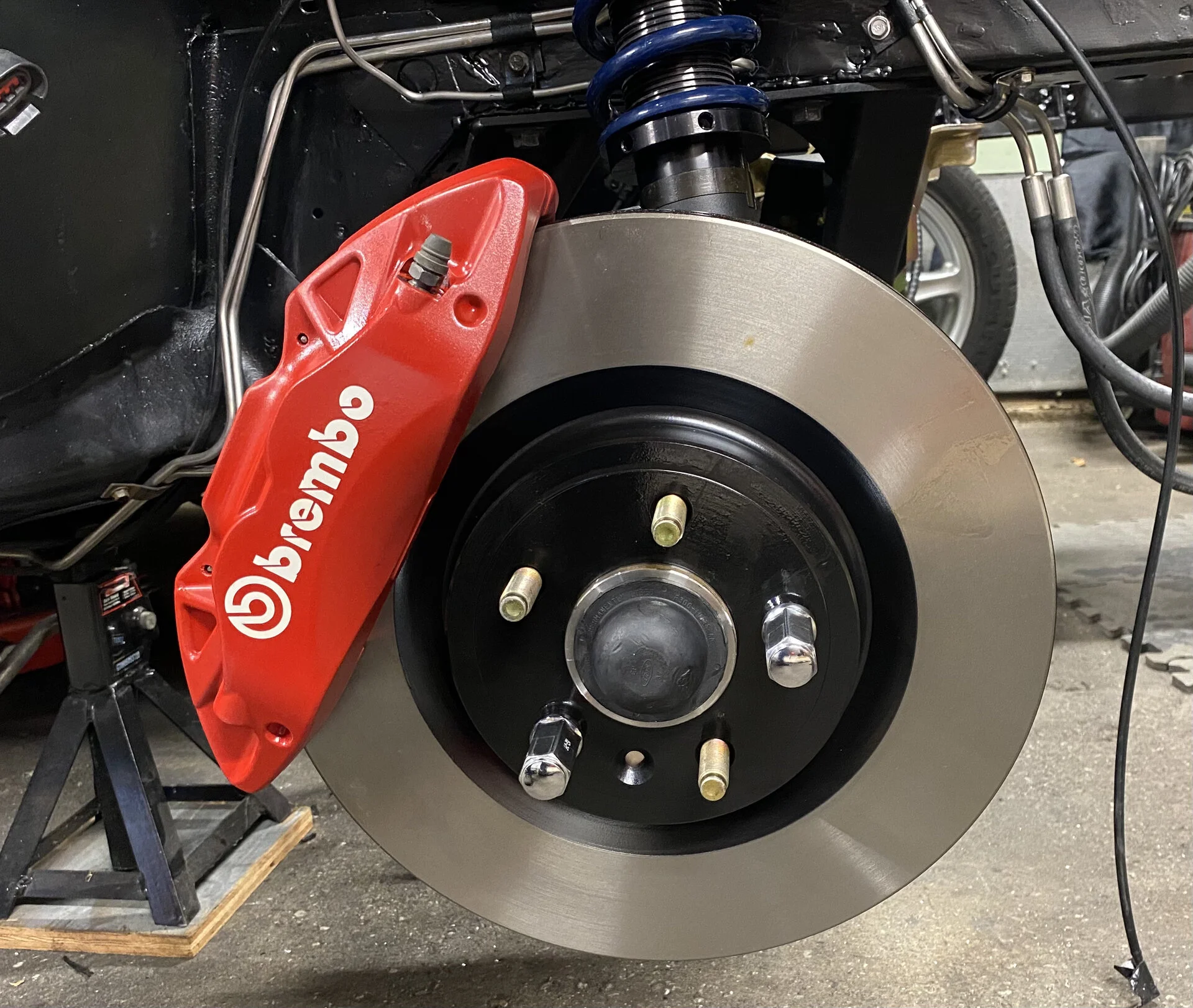

any pics of your setup?

Thanks for responding. Mine is completely stock 95 parts nothing to look at but I'll post some pics of the car later though. I am working on it at this moment and it looks like my tie rods from the fox may be a little short because it was toed in pretty far. I have to use the brakes off of the SN95 so I think I will need to address that issue later. What I meant by the strut moving around a lot was if you off center the bottom location then the strut pivots differently than it was intended. Maybe I am worrying about nothing. I am going to keep on going until something doesn't work right, thanks again
