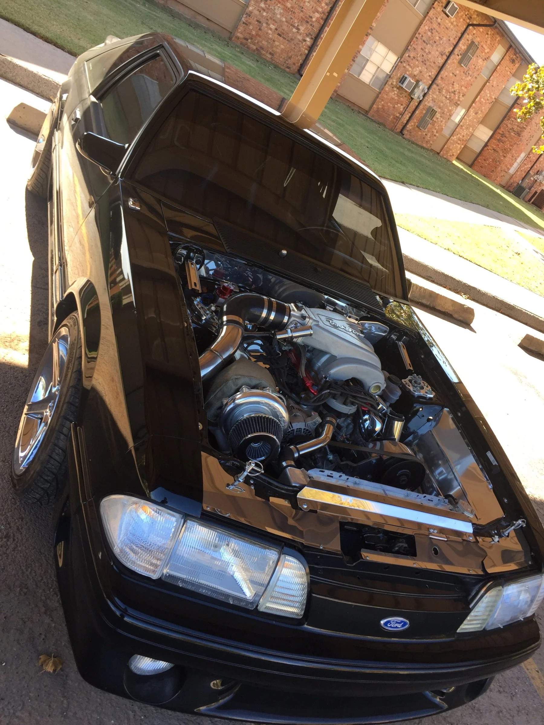

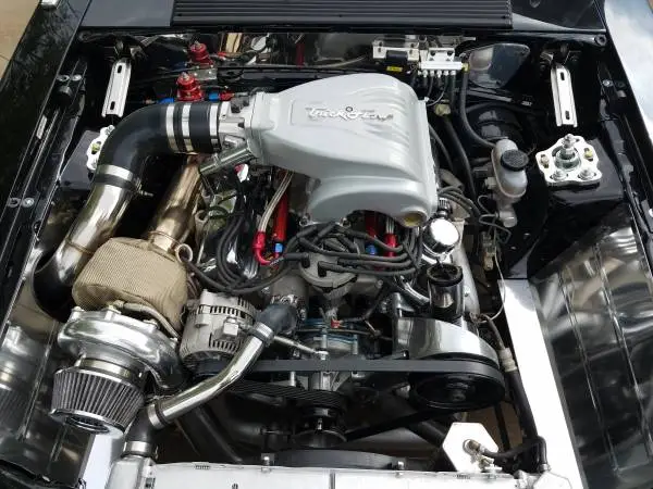

I picked up a 1992 fox with a 351/393 and a 75mm on3 turbo, with a looooong list of mods.
Long story short first couple of days drove fine till it warmed up the wouldn't start after it was hot. Now I'm not able to get it idling, will fire a few cylinders then stall, sometimes I get lucky and it will idle and stall very shortly afterwards.
I'm new to foxbody and need help on we're to look first. I know it has 80# injectors and it hasn't been tuned, which should be where most of the issues stem from. However before I can take it to be tuned it needs to be a least running

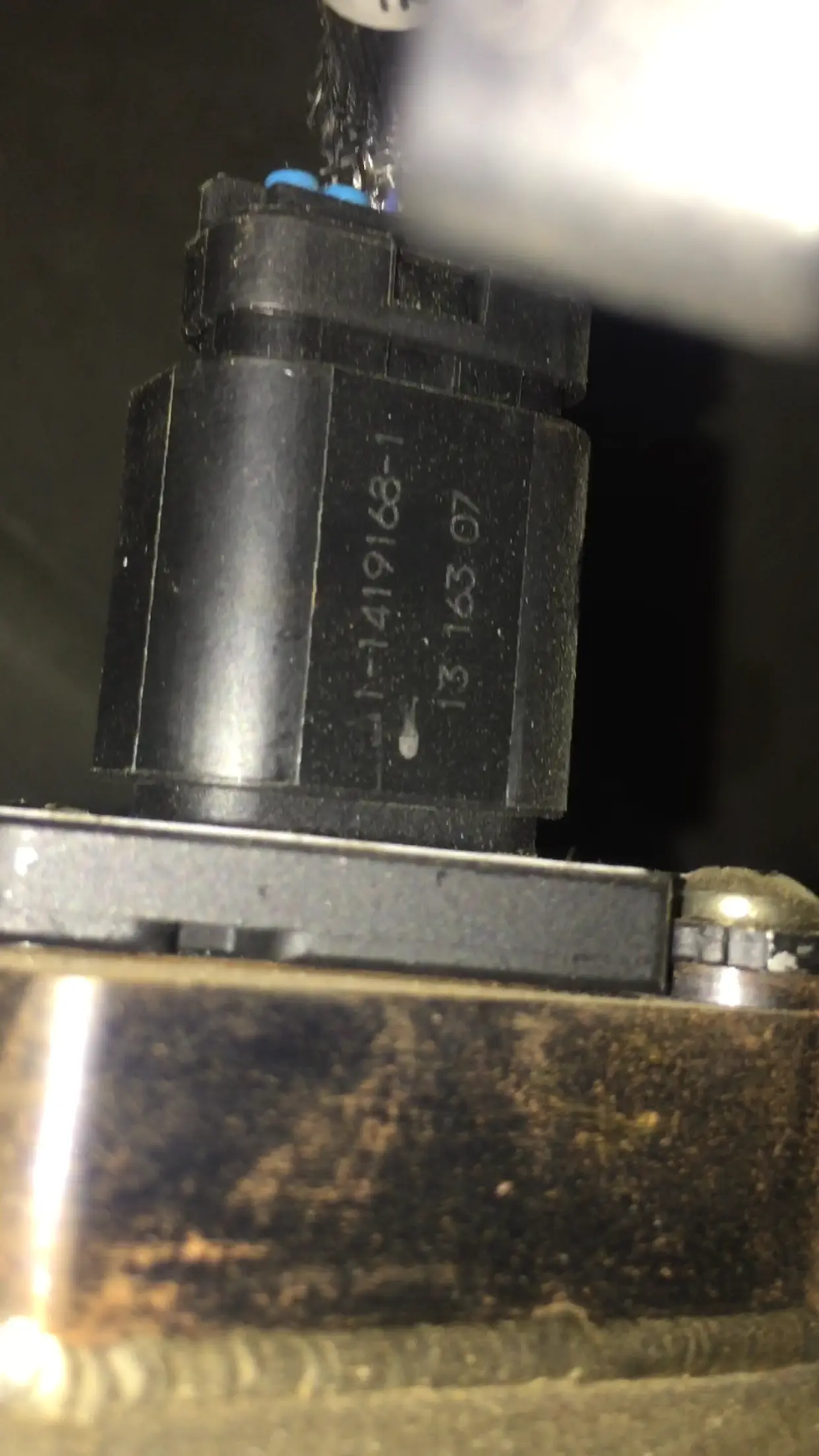

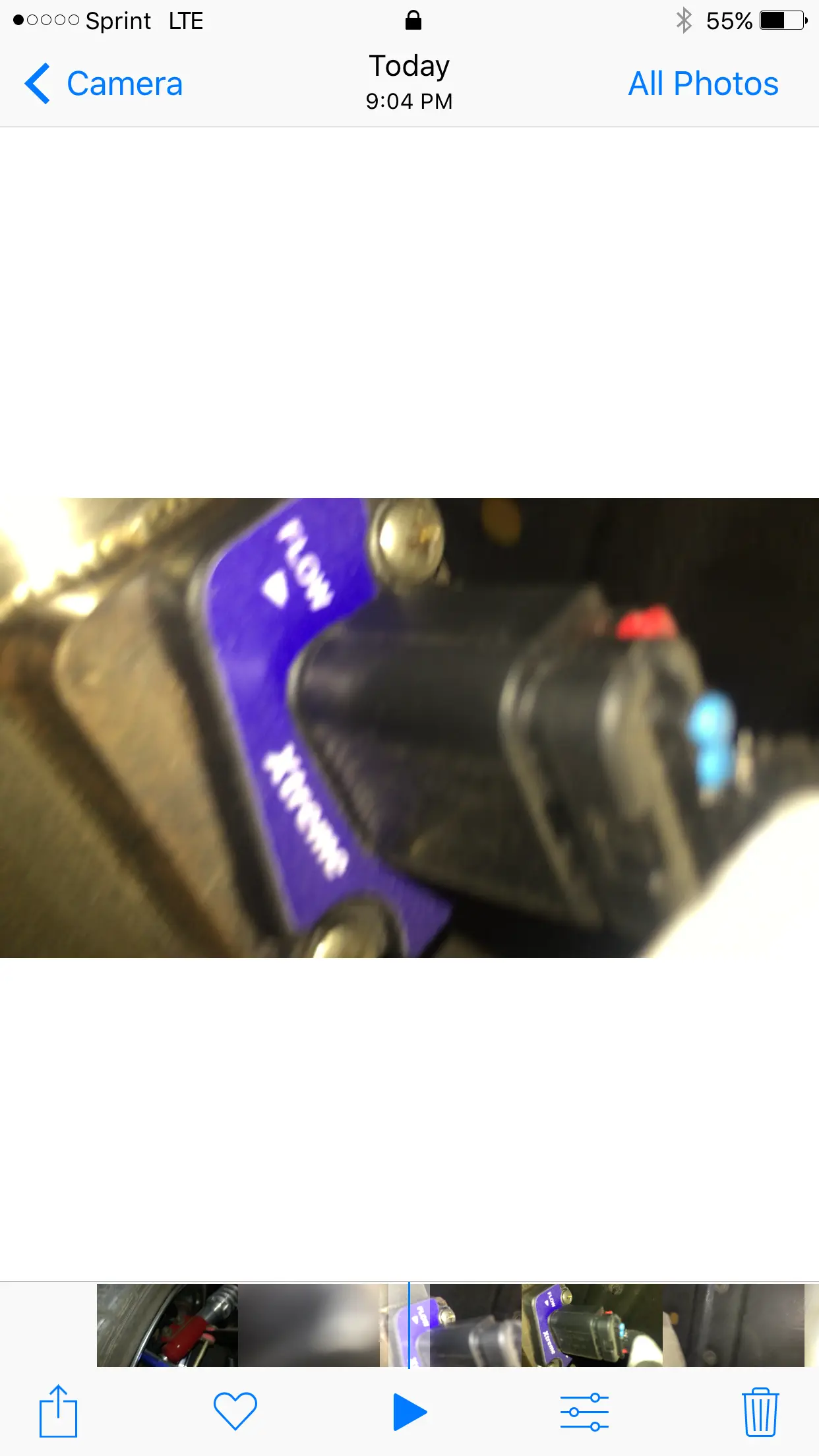

Deka Injector numbers on side are: A172A00178 each one seems to have a different last couple numbers maf pics attached computer will have to wait until morning
I have another computer that he had laying in a box that has a square cut out of the metal casing
OK, that would be where the chip/tuner would stick out.
I would imagine you'll find something sticking out of the ecu that's in the car.
Looks like you have a slot style maf but can't tell much more than that.
I believe a slot maf doesn't come pre-calibrated for an injector size, meaning it has to be
configured in the tune.
