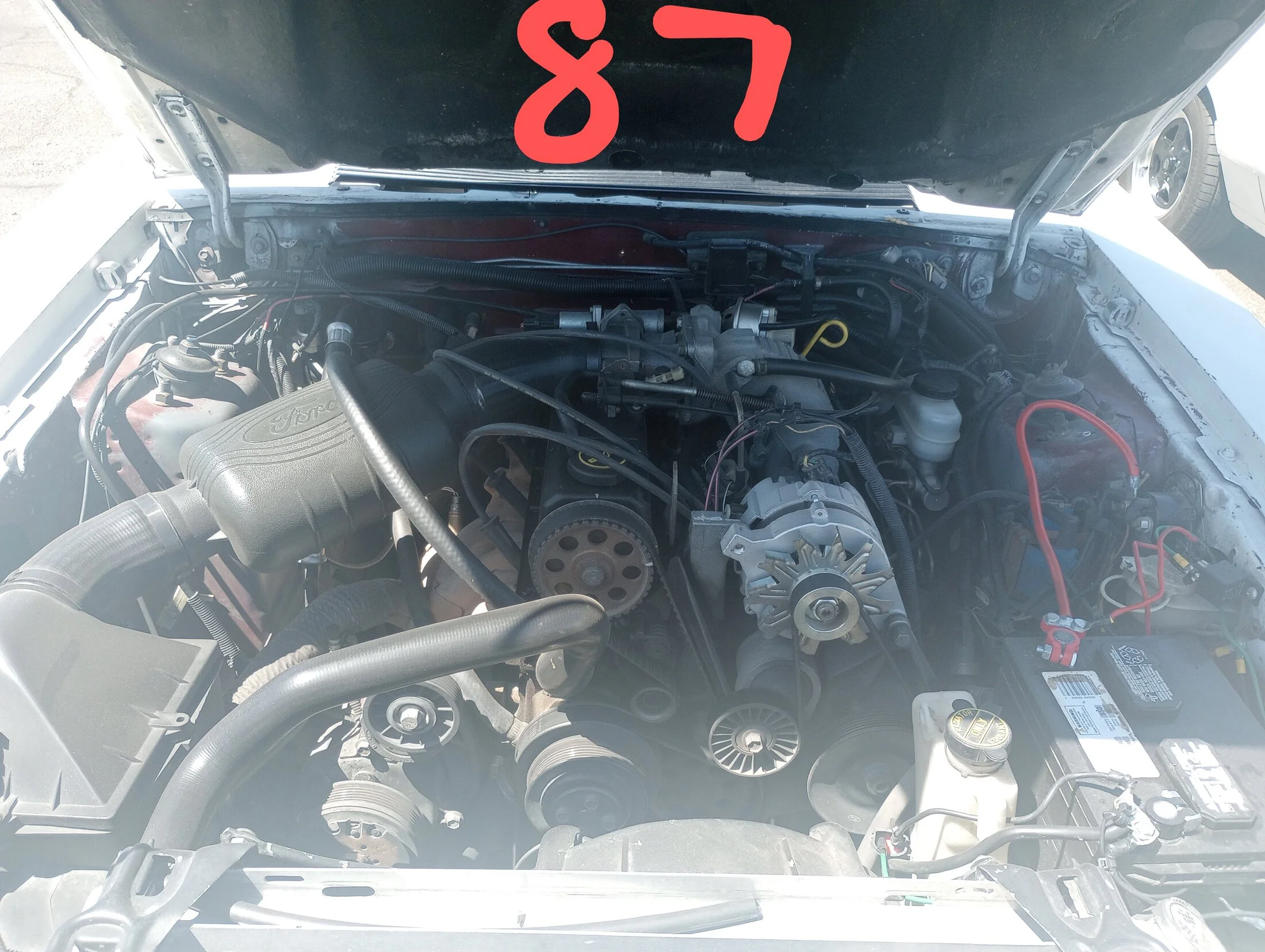

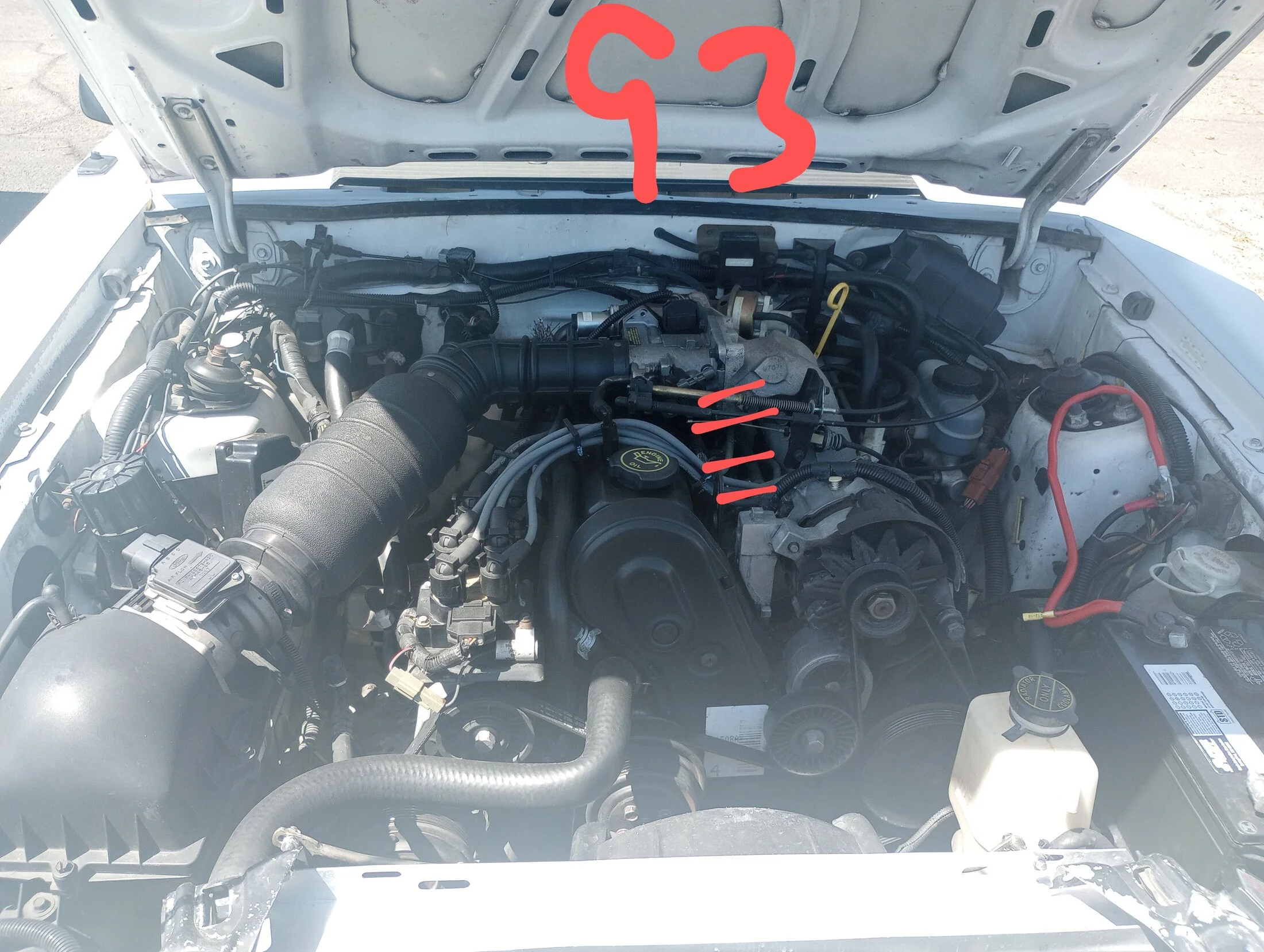

I also have an 87 2.3L Manual, and the Factory on that is 850. The only major difference with the Engines, is the 93 has the Dual Coil Packs, with 8 Spark Plugs, so that could be the reason for a lower 650 if that is correct Factory setting. No real knowledge on that, just guessing.

A bit more of an impressive look, however the extra 4 are definitely more of a pain in the ass to reach based on being located where the injectors are. ​
