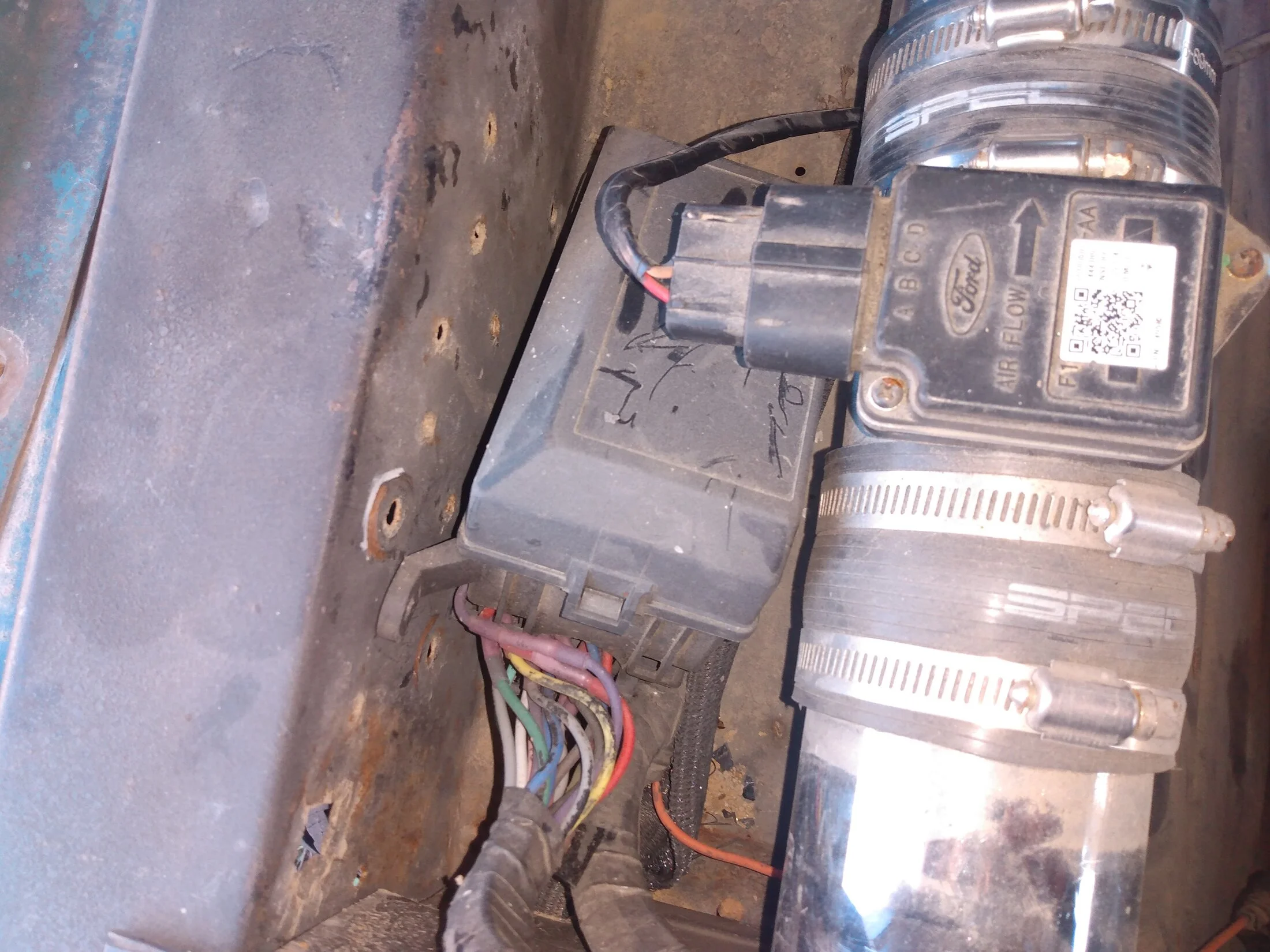

Need to know what mass air meter is on it as the stock one will not like those 22 lb/hr injectors. Stock was 19 lb/hr. It could have a calibrated MAF but d far as I know they were mostly for 24 lb/hr injectors.
Take a picture of the MAF then get a picture of the data tag on the MAF element and post them. Will look like this:

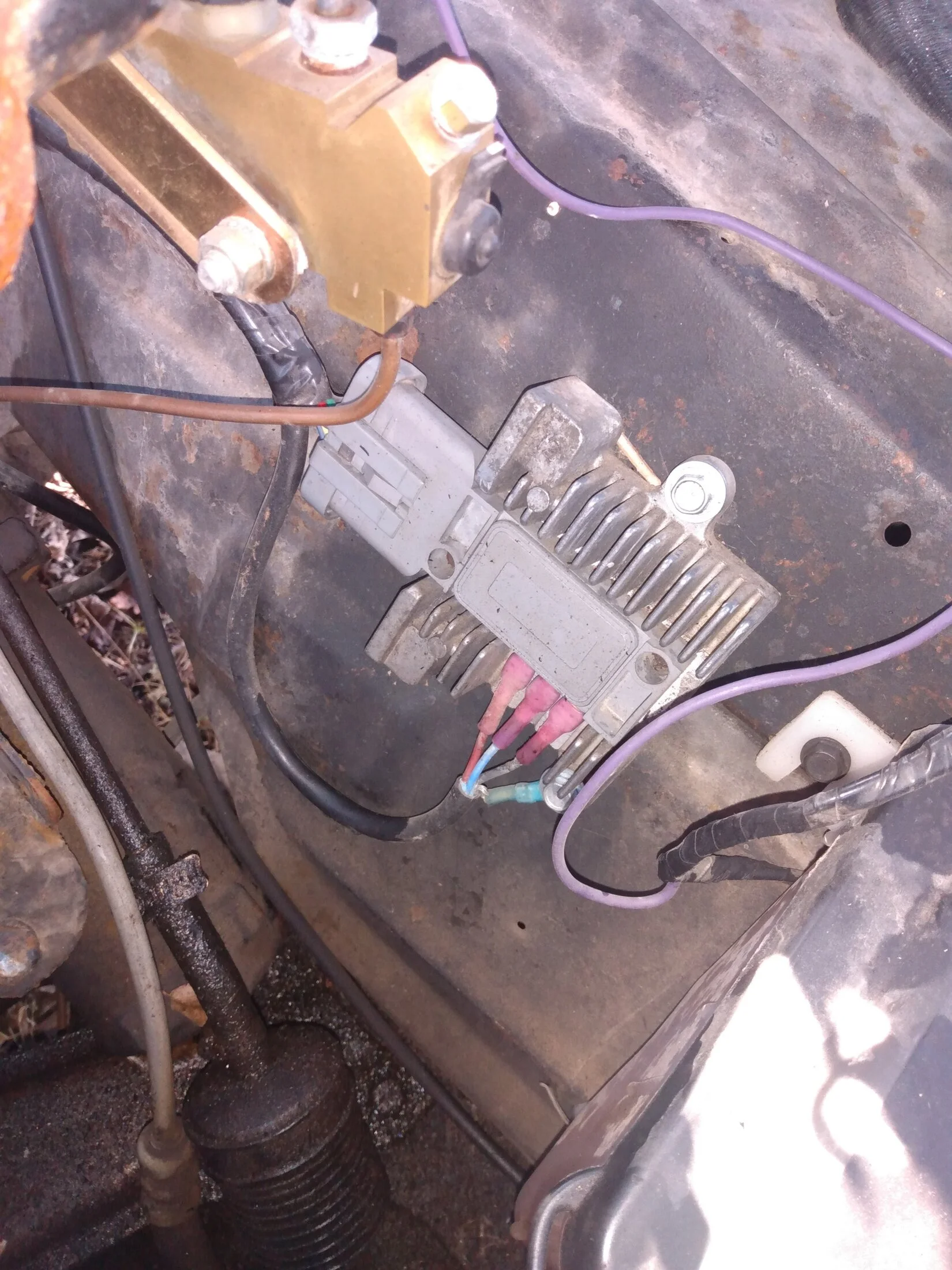

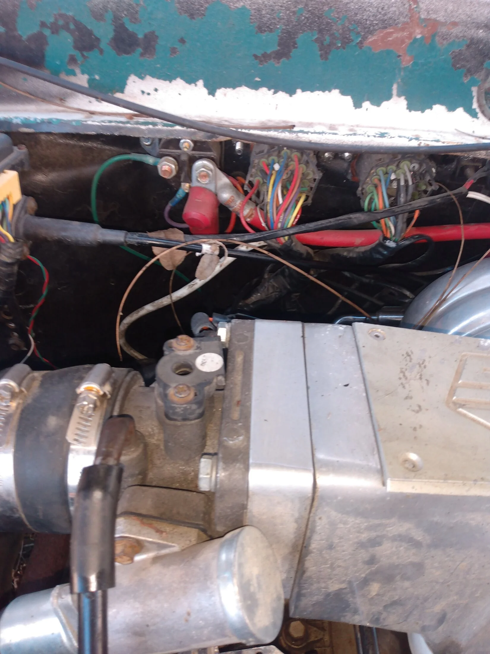

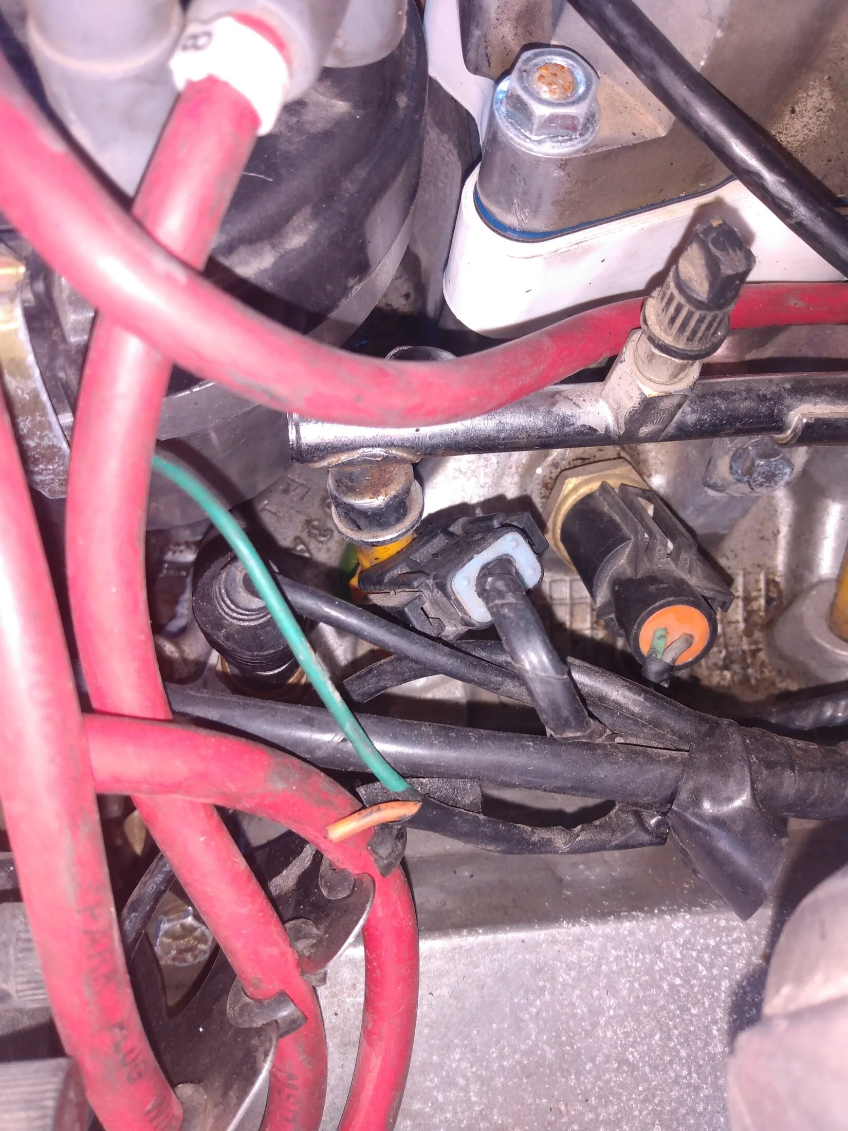

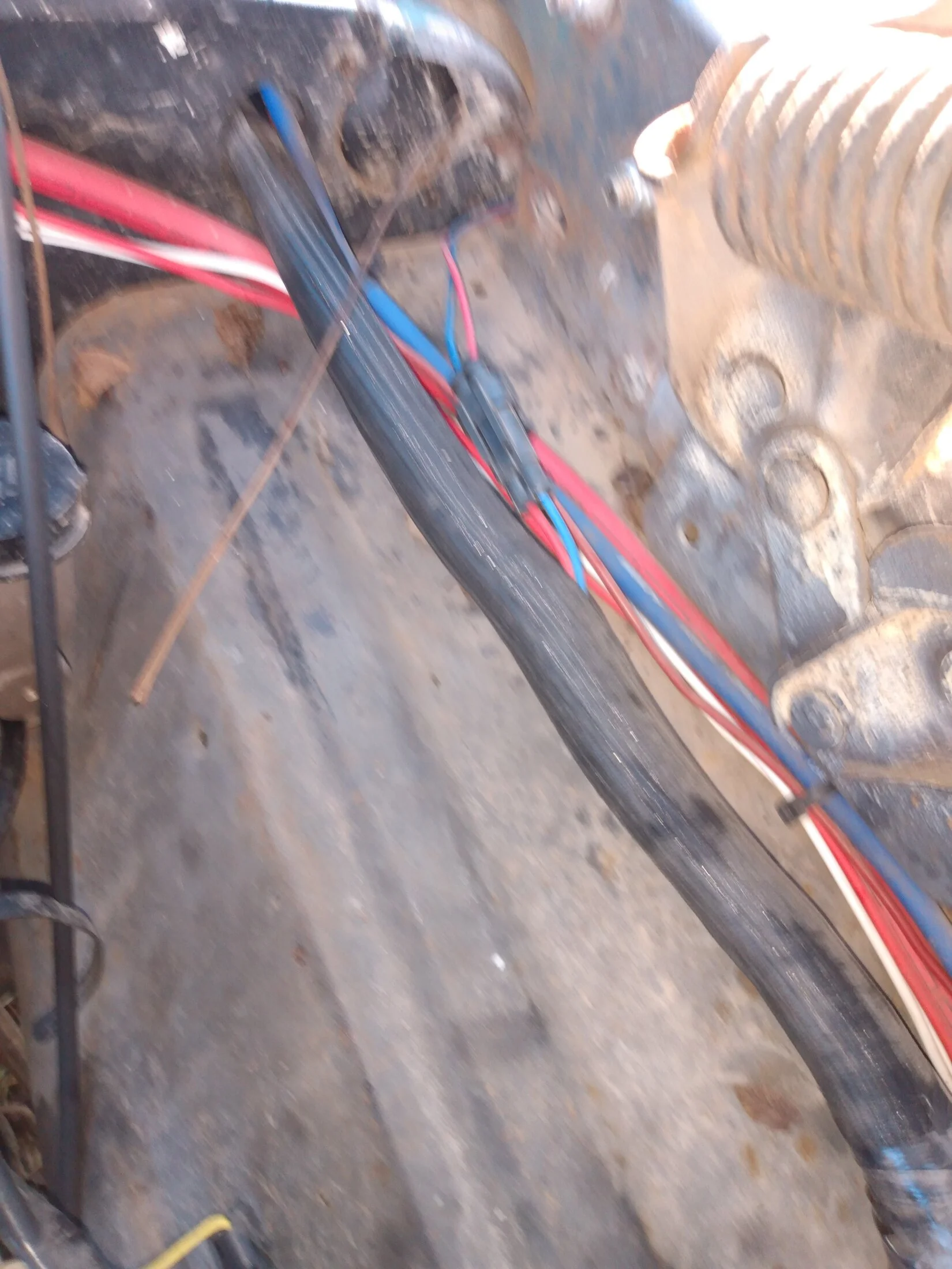

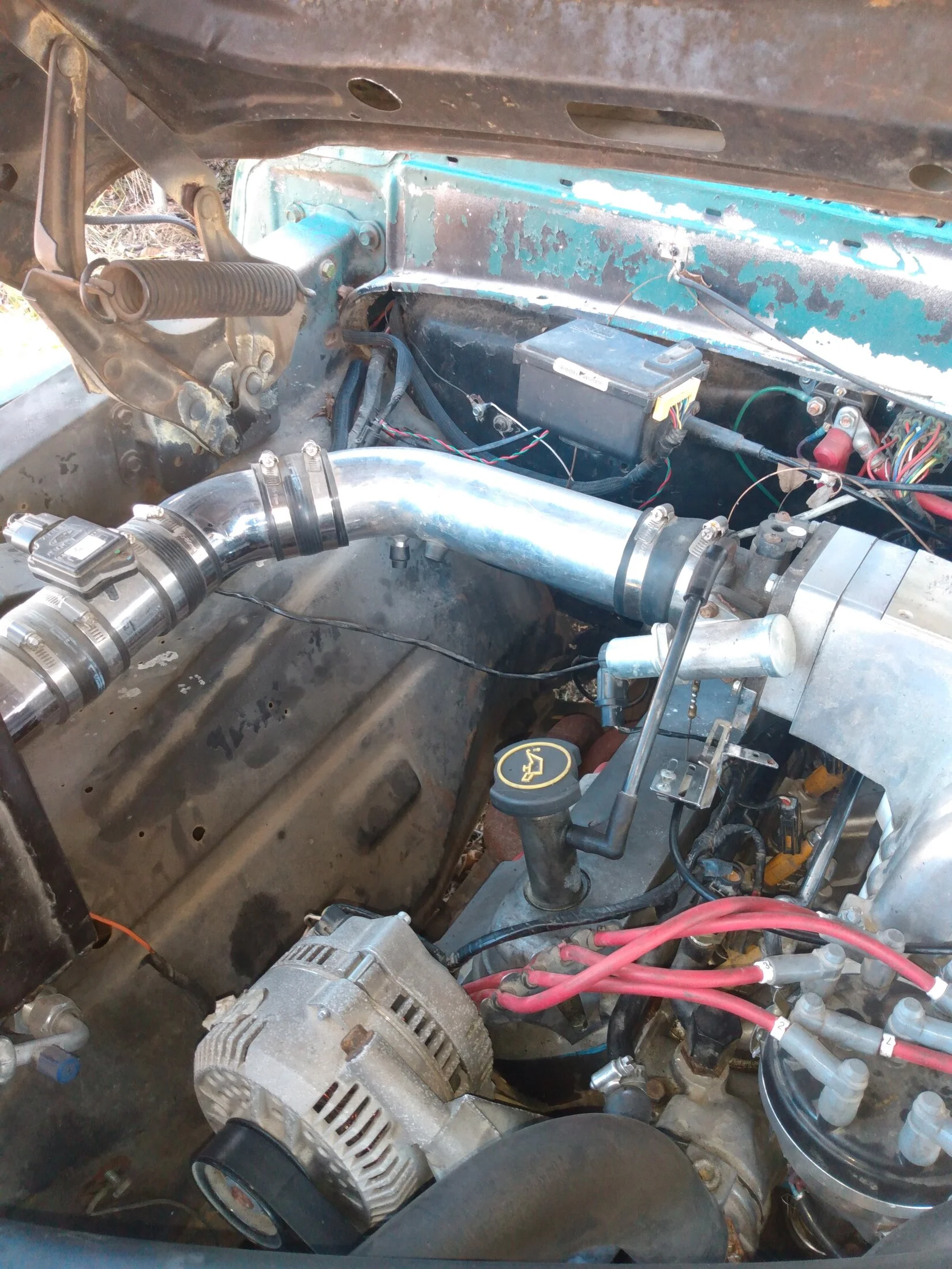

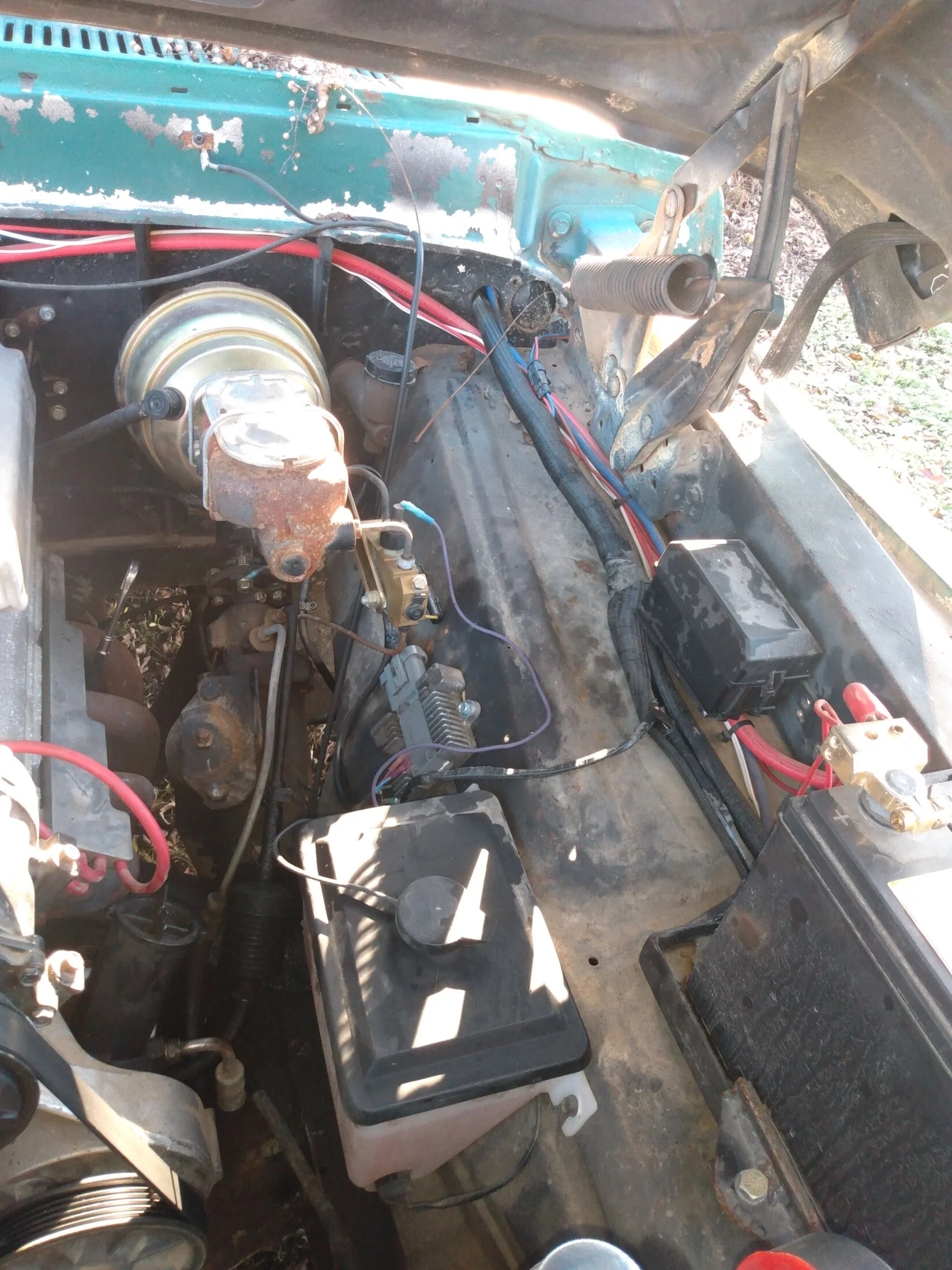

Hey. I've been sick for a couple of days. It's at my dad's house right now. He took some pics the other day for me. I don't know if they will help or not.

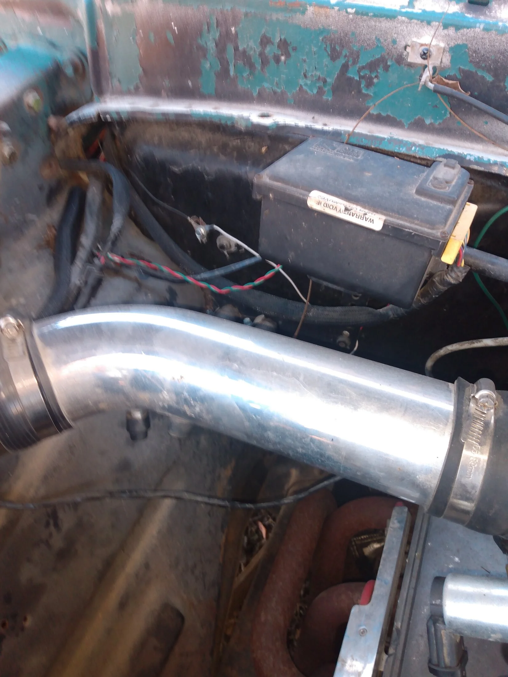

The second picture is the MAF. Need a better picture of the white label (less glare) and then peel the white label back and get a picture of the Ford part number. All I can read is F1......-AA. Need the rest of it to see what sensor is in the housing. On another note the injector tops are orange which is indicative of 19 lb/hr injectors so if the MAF is for 19 lb/hr then all of that is good.

Ok. Well I know that it is not inside a 55mm housing. So I guess my first question is what should I do? Stick with what I have and get the right size housing? Or should I upgrade the MAF and the injectors for the bigger housing? What would help me achieve my goal of running better, starting easier, and the best possible gas mileage?
If the motor is stock then just get the right size MAF and stick with the 19 lb/hr stock injectors. I’m not saying this will fix it but you need to have it mechanically correct first. Once you have that squared up then we can go down the road of troubleshooting the electronics.
