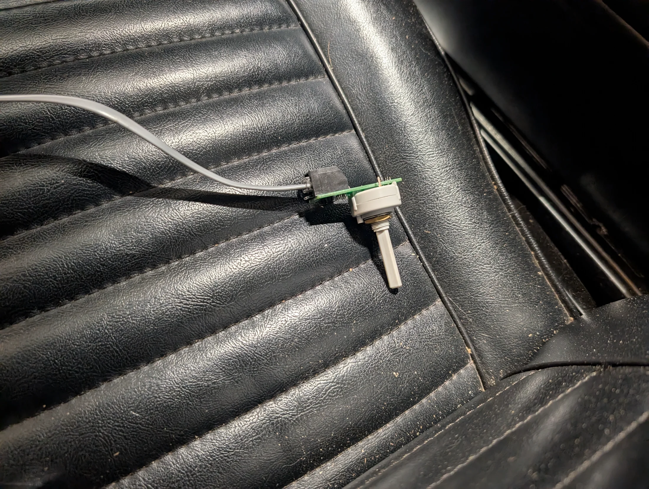

So you had a Tweecer on it and evidently the car was tuned and ran well. You pull the tweecer off and now it doesn't run well. Can you pop the tweecer back on and see if it runs right or did you change things since it was removed? Does it now have the stock MAF and injectors or a calibrated MAF and larger injectors? Basically is there anything in the motor that is not stock other than the GT40 heads?

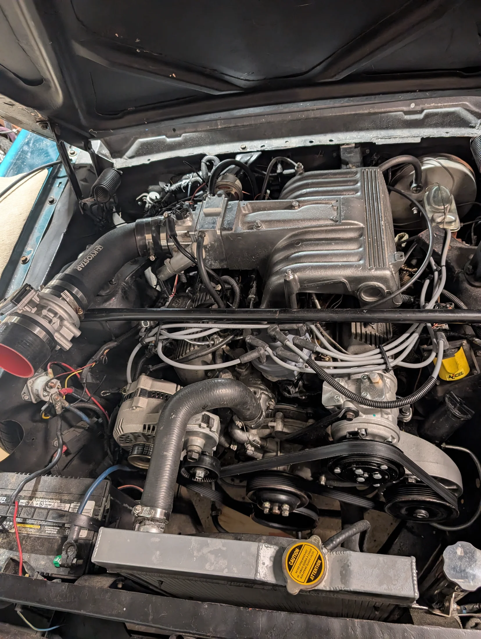

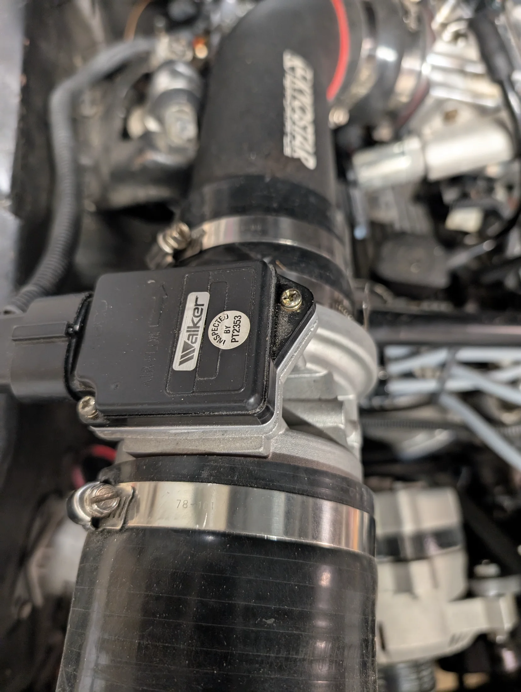

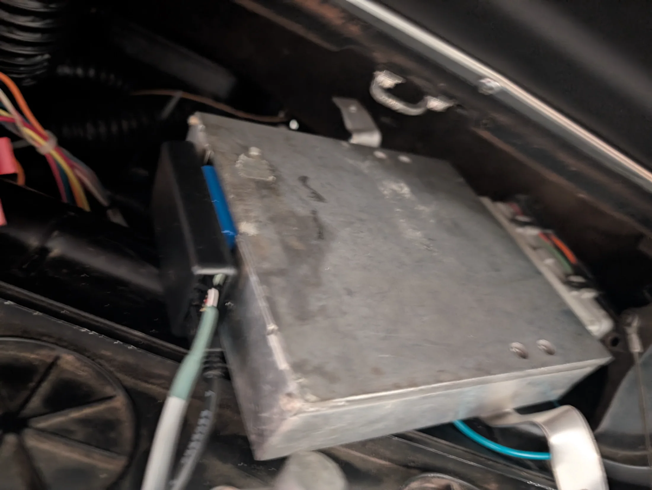

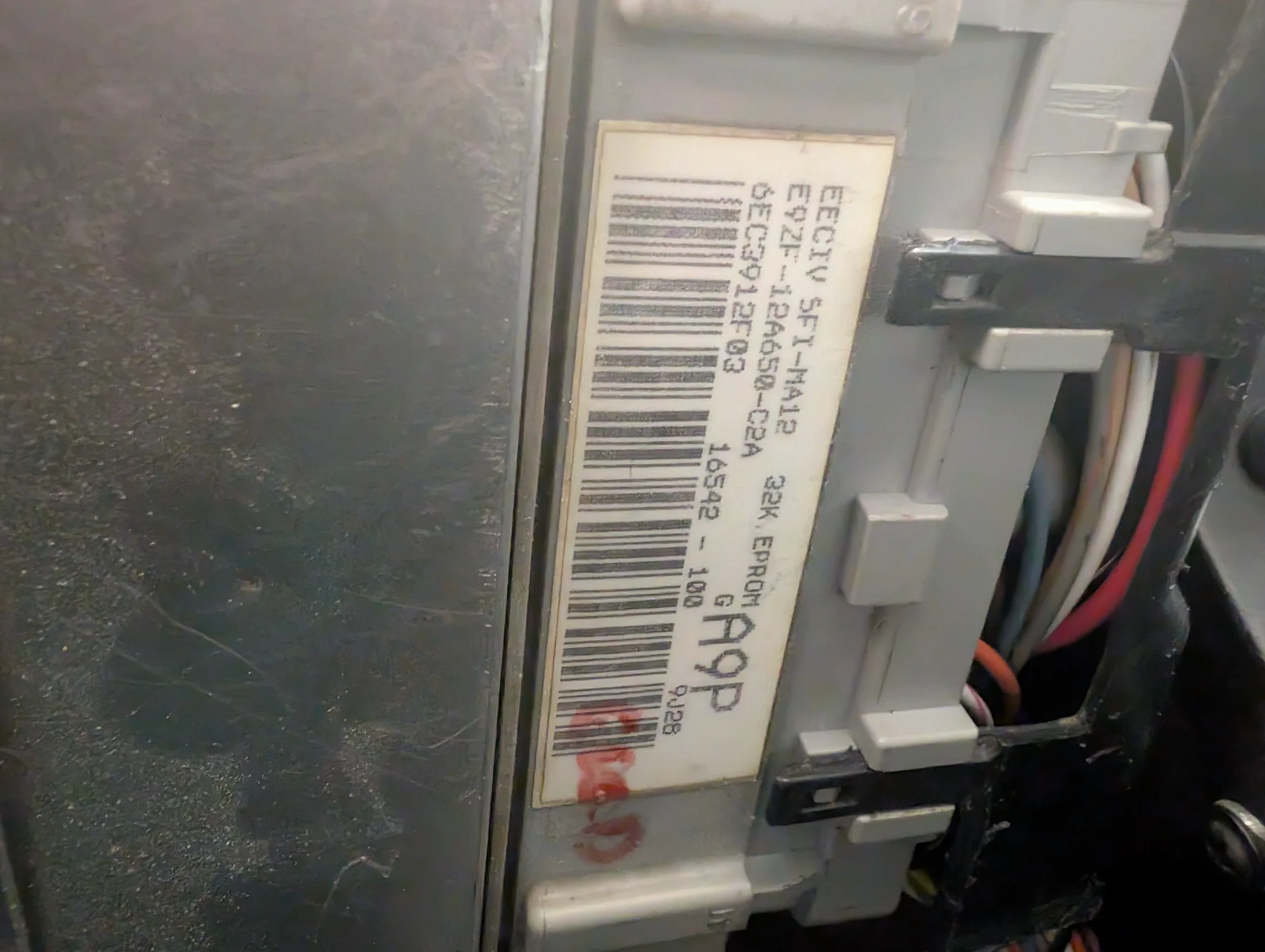

Car started running bad with the Tweecar still installed it ran decent then it didn't. Where to begin it's a 93 Cobra S VT block and GT40 heads fresh rebuilt with mild cam. Intake is off an Explore larger throttle body new mass air, JBA headers, painless wiring harness, A9P ECM, Tanks intake fuel pump, Tweecar tune but could never get that to run right or hook up. All in a 65 coupe. A smarter guy would have just put a carb on it and drove but after investing years and money here I am and here it sits. It ran decent before just idle issues now black smoke. Thanks for the help.

It never ran great but good now horrible with the Tweecar or Without. Only thing that makes it run great is priming the pump then pulling the relay. Car runs smooth until fuel runs out. Only thing I can figure is the ECM is firing all the injectors at once dumping fuel in every cylinder at once.
