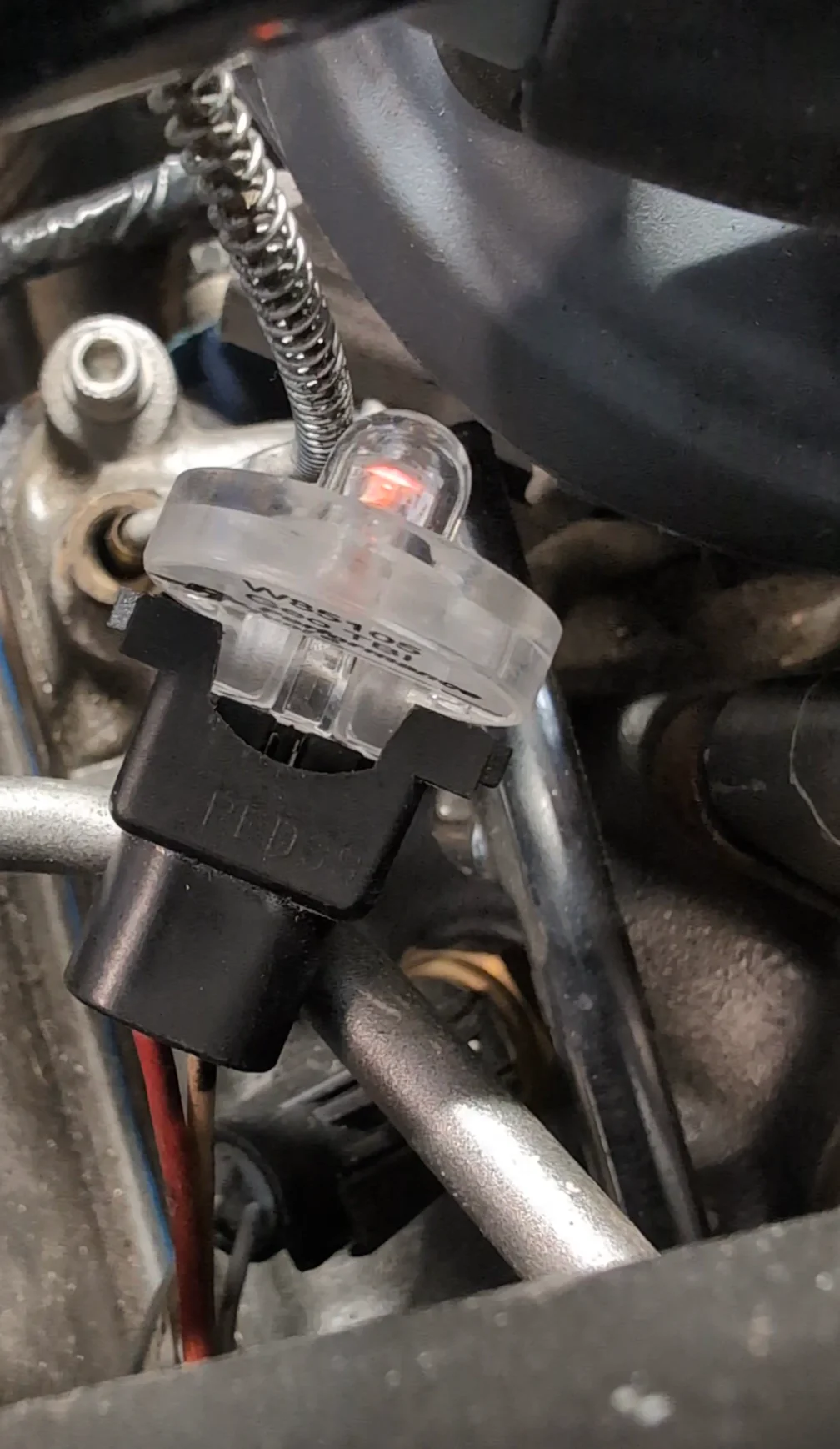

TPS is dead on 1.00 when closed and 4.00 full throttle. Noid light does not light up with key on but does when you crank the engine.

Imagine (if you can) the engine idling at 750 RPM.
That's 750 times in a minute the injector pulses, that's flashing really fast, injector stops pulsing when the engine stops turning even with the ignition switch turned to run position.
Pulsing is good.
Reactions: Noobz347

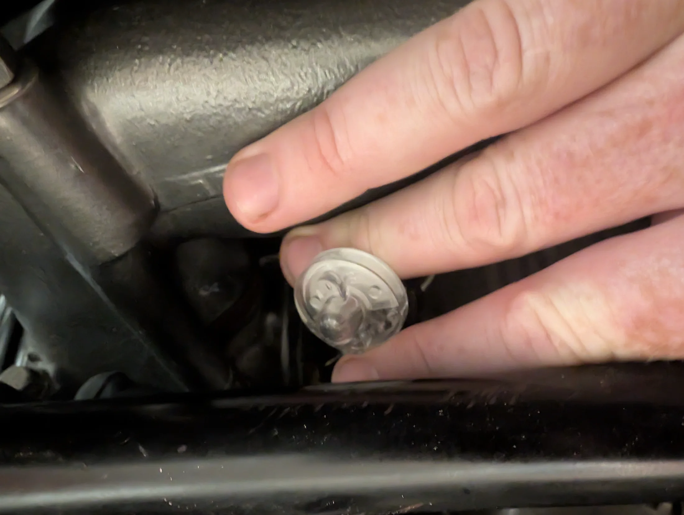

Well still no luck with fuel issue l. Replaced one leaky injector got car to hold fuel pressure now holds then slowly leaks down. Still dumping fuel in cylinders. Guess my only other option is to replace all the injectors.???
