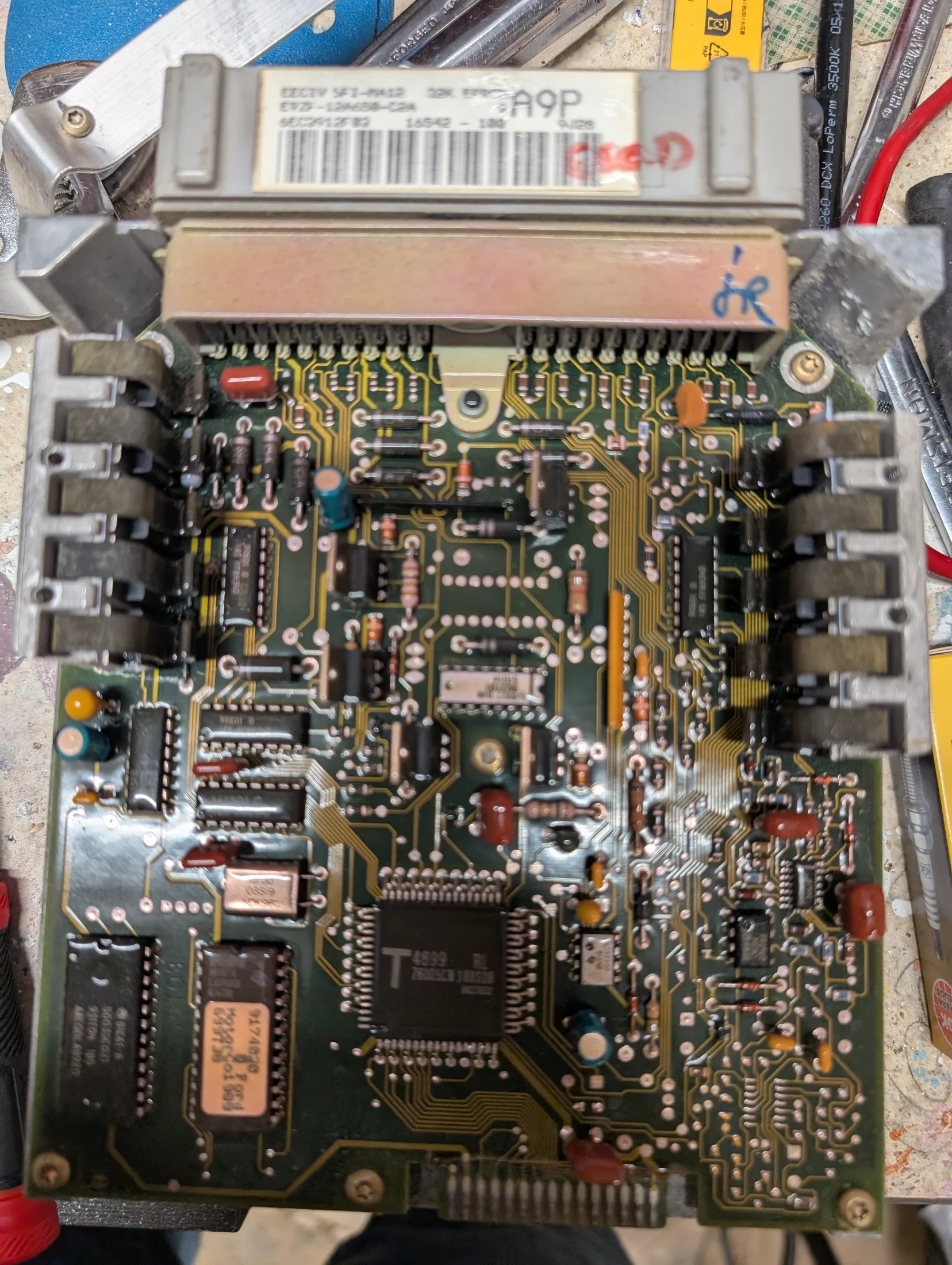

I know where things headed…or rather the ECU should be headed:
Was kinda hoping I would see a blown capacitor but all looks ok. How do I clear the KAM? I adjusted the TPS it is new also
Took the chip out just the ECU.
That, in itself, could be an issue. Whomever put that thing together, had a tune for it. Could be because of injectors, or sensors, MAF, cam or a number of other things.
The question is whether the chip and the tune that's is supposed to be on it, is still any good.
If it used to run with the chip in it then it [needs] the chip.
I bought the Tweecar to make it run better and to be able to look at vitals. Car was not built for tune it ran with or with the Tweecar before. Never could get the Tweecar to hook up right.
This is good to know.
So, you got the TwEECer to try and solve an issue that you didn't have?
Pull Key On Engine Off codes again. Don't start it and don't pull any relays.
