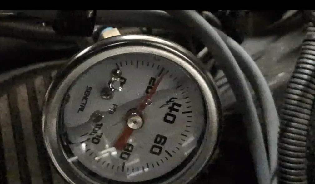

Jul 13, 2025
#105
  • Jul 13, 2025
  • #105

Should have 39 psig of pressure with the motor running and the vacuum disconnected from the FPR. That pressure is too low which will skew the fuel tables in the ECU.
My question again is "Are you talking about when you prime the pump and then shut the key off it holds pressure or that when running the pressure is steady and at the set point you adjusted the fuel pressure regulator to?"

When I prime the pump and turn off. It holds. When I start it sounds like it's running on 2 cylinders with black smoke. Switched Fuel pump relay thinking might be that no luck, put fresh gas maybe that no luck.

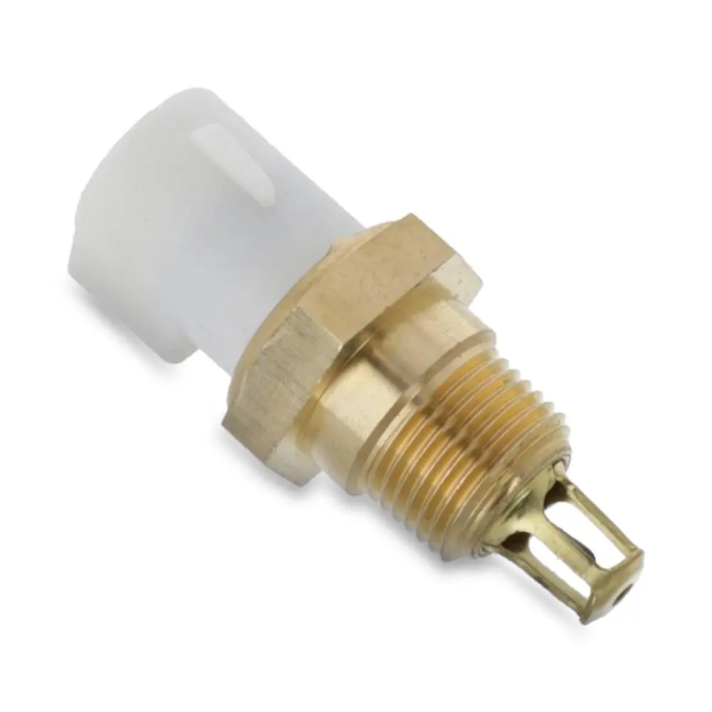

Have you checked your engine coolant temperature sensor. Its in the metal heater bypass lines that run behind where the thermostat is. I had one that had the intake air temperature sensor installed in that spot that ran like dog pi$$. They will plug into the same connector and they both have the same thread. IAT sensor has a little bulb thing on it and should be on the drivers side around cylinder 5 on the intake. The ECT sensor is in those metal pipes and should be a solid piece on the bottom. If the engine computer thinks its cold it'll run rich.

IAT
ECT
