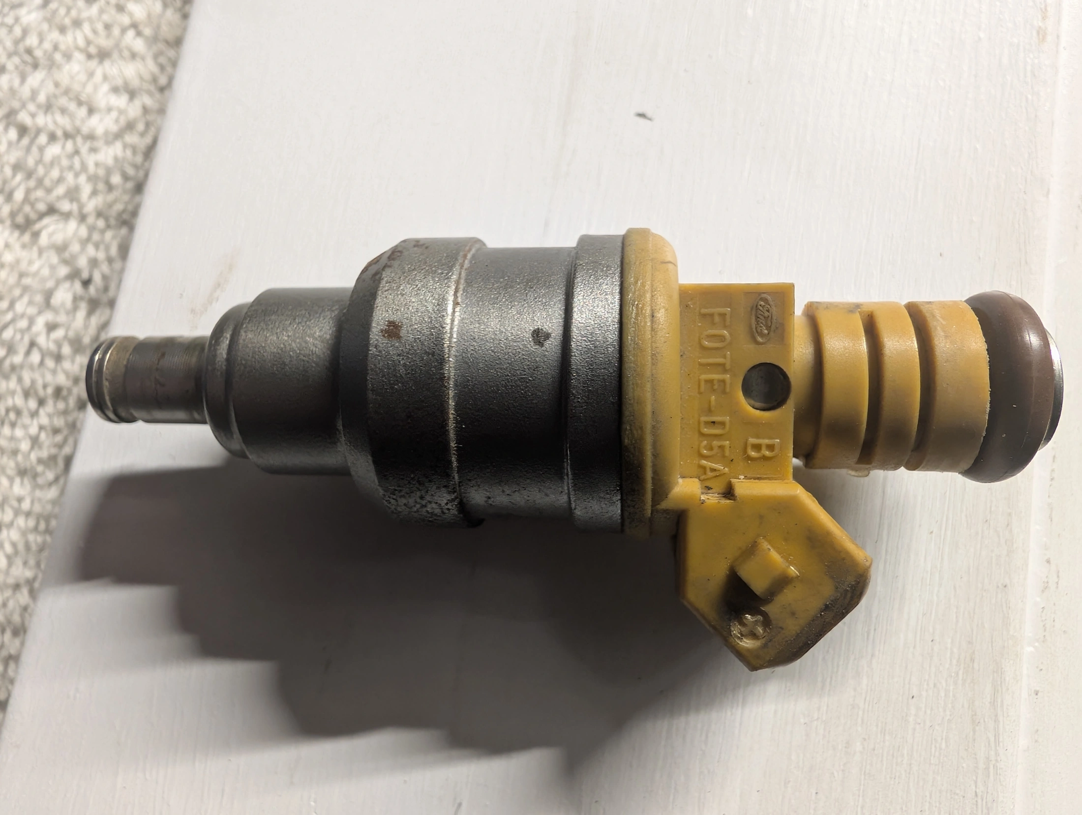

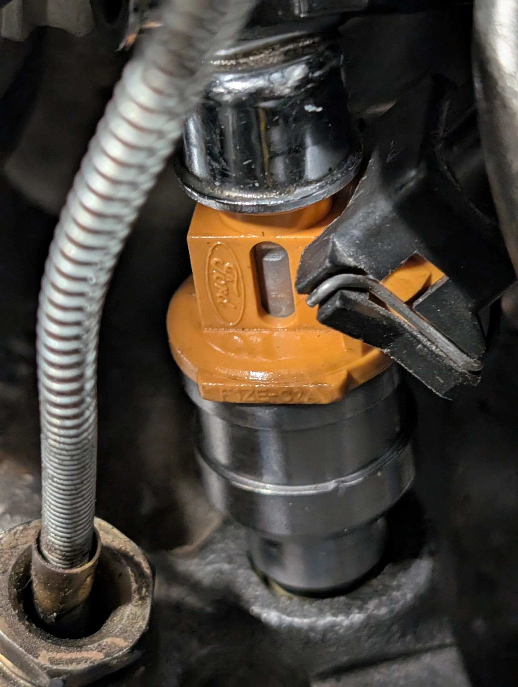

Well still no luck with fuel issue l. Replaced one leaky injector got car to hold fuel pressure now holds then slowly leaks down. Still dumping fuel in cylinders. Guess my only other option is to replace all the injectors.???
This needs to be resolved. This cannot happen. Check for stray voltage with the key in the [On] position and engine stopped. If you don't find anything on the electric end then yeah... Every one of those injectors is suspect.

I'll go back though... If you have injectors dumping gas into the cylinders with the engine off and fuel system pressurized then that is a huge problem.

Pretty sure Tanks Inc is a Walbro dealer so the pump should be good. What brand of injectors are they and where did you buy them? I would still pull them like Noobz is suggesting. I would be curious to know what they looked like.
I pulled the fuse to the injectors and car wouldn't run so pretty sure the problem is not with the injectors. Checked all the grounds and they look good. Guess the fuel pump is pushing too much fuel but the pressure is at around 25?

So let me start with saying I’m not busting your balls. Those injectors are junk. Lots of reviews on them with spray pattern issues, leaking, bad coils, etc.
You need to pull them and test them. If they are bad get your money back and buy some EV1 Bosch injectors.
