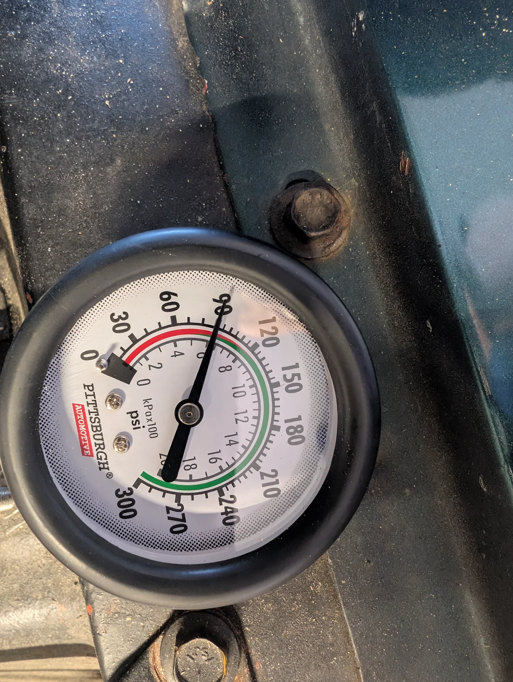

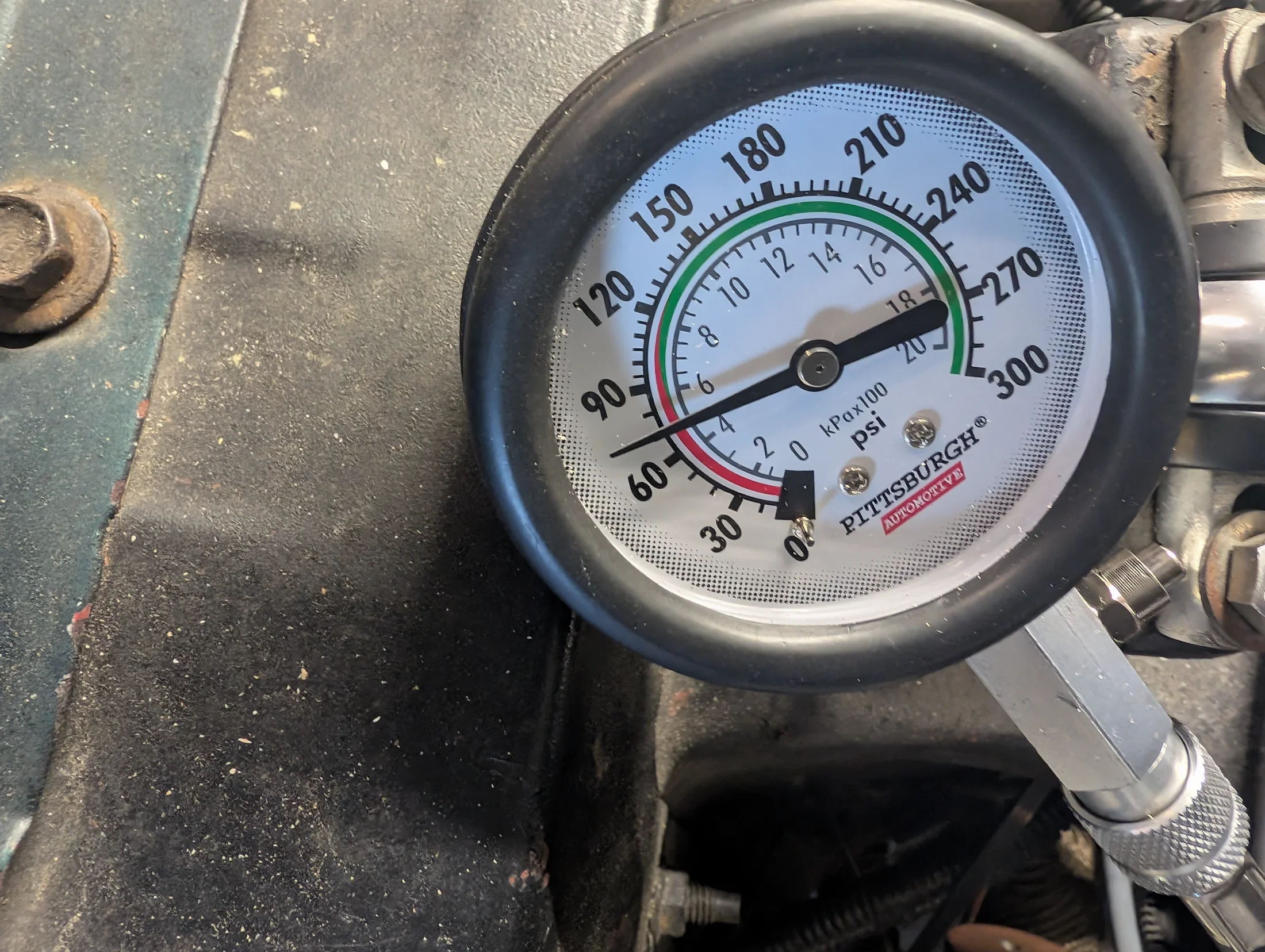

So I decided to do a compression test. Not looking too good. This is a fresh rebuilt engine. Any thoughts? Jump time?

You’re kinda between a rock and a hard space. You’re counting on a set of rebuilt injectors as good, and trying to diagnose what else could be the problem. While I’m no fan of parts swapping, you might bite the bullet and put a new set of injectors on it. Even at that compression level, the car should start and run. As @General karthief said, you’ve got to get some hours on the engine to verify the compression. Check the valve timing as was suggested before as well. Good luck.

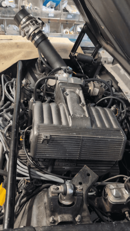

I am at my whits end boys. Brand new injectors, brand new ECU, brand new regulator, brand new engine. Still doing the same damn thing.

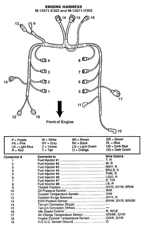

You have a 50 oz balancer and 50 oz flywheel on it as well, correct? Other quick think to check is to make sure you have the correct connectors on the injectors. Just want to make sure the correct color of wire corresponds to the correct injector.
Not saying you did anything wrong but there have been issues with the painless harnesses in the past with misprinted wires and wires not seated into the connectors all the way.
