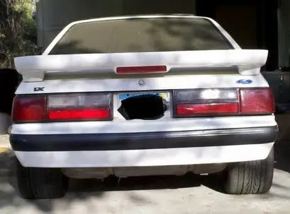

I'm currently working on restoring my 93 hatch and I want to convert it to 5-lug wheels and put disc brakes all around. I was wondering if I could just put the front brake assembly and complete rear axel in my car from a 94-98 gt mustang. I know the rear axel from those years are 1.5 inches wider than the fox mustang but will it still bolt in without issues and also I'm looking to put the fr500 wheels on my fox also and want to go with 17x9 in the front and 17x10.5 in the rear. Will those work with this combination?
