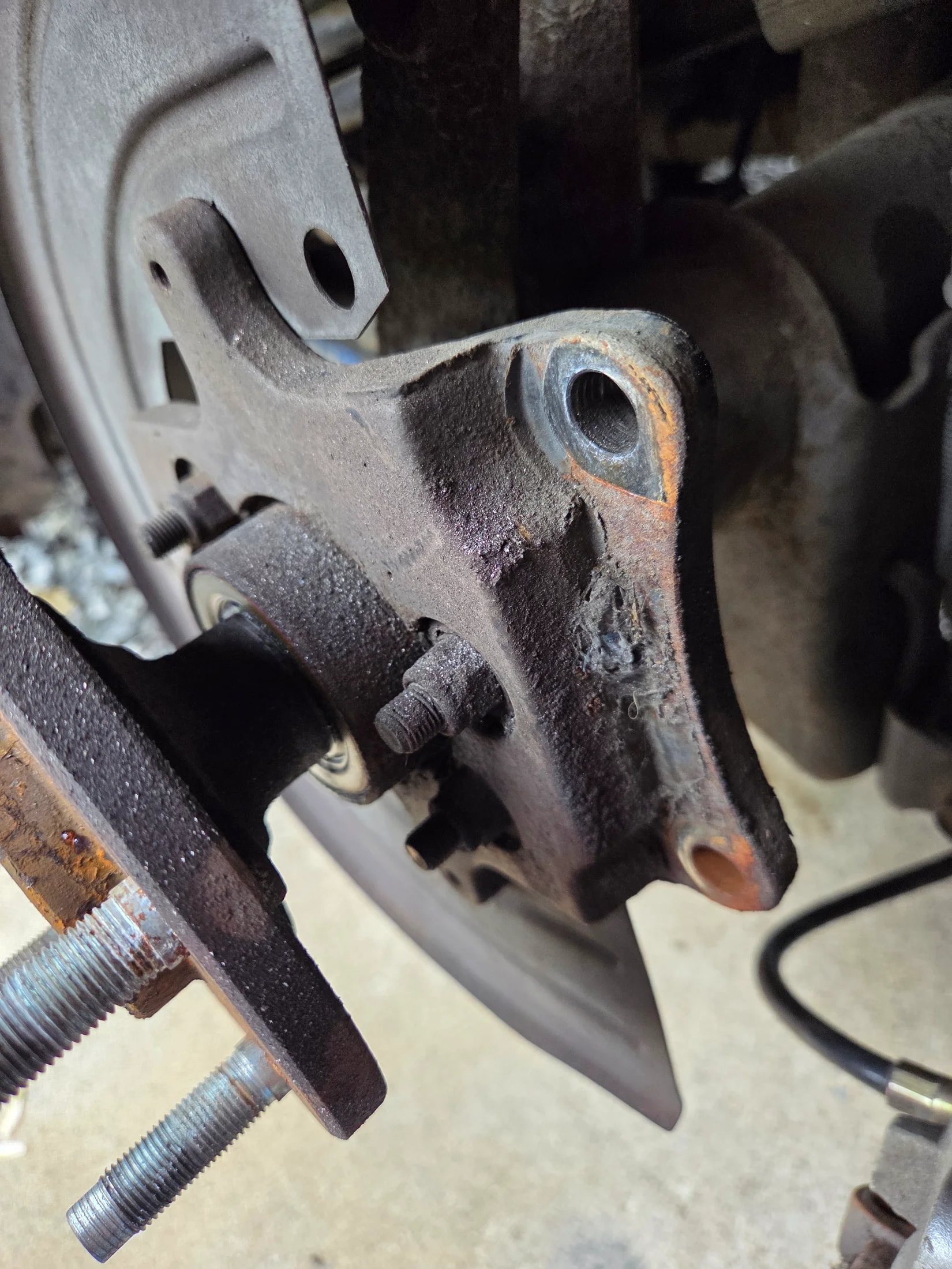

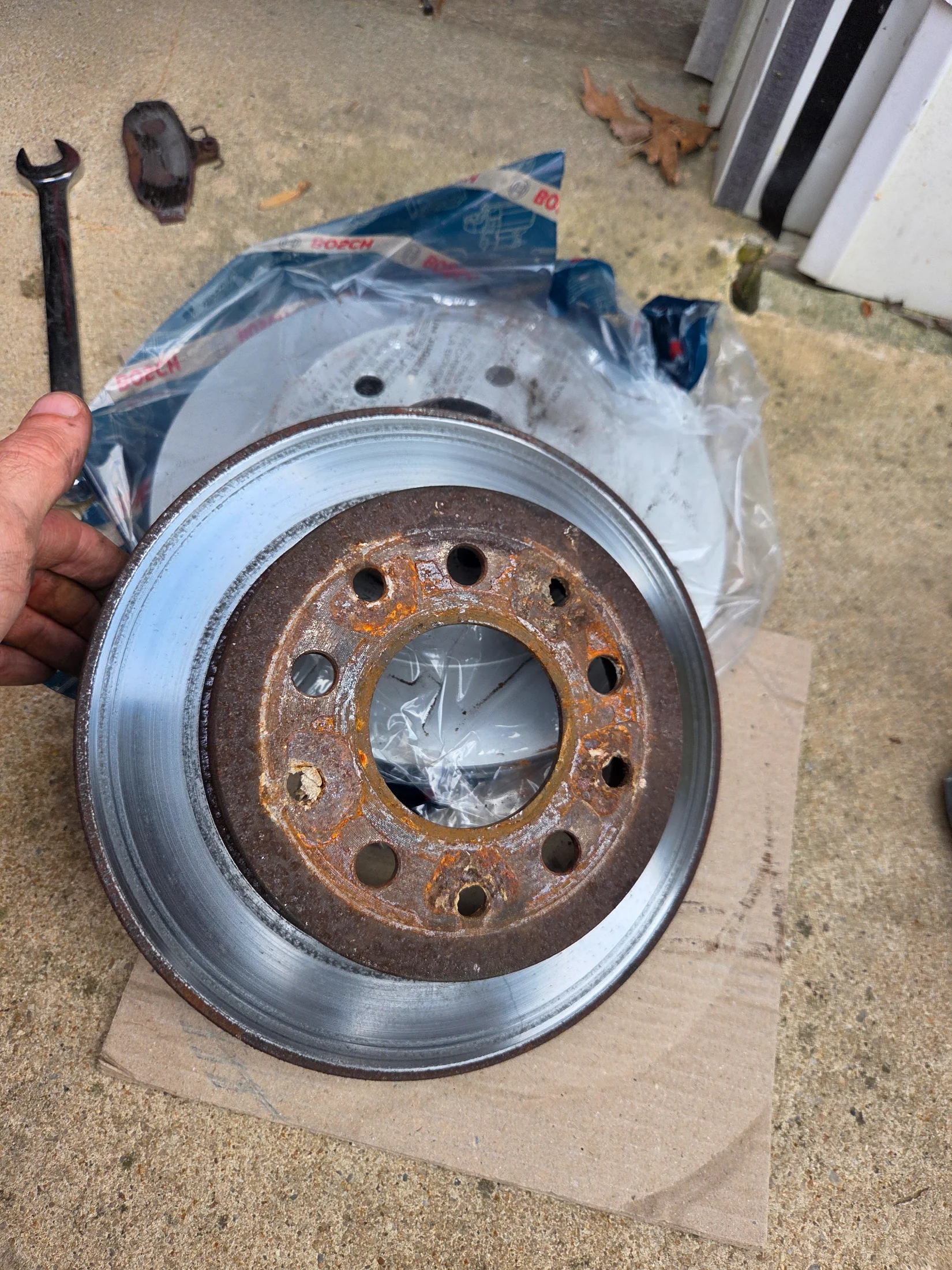

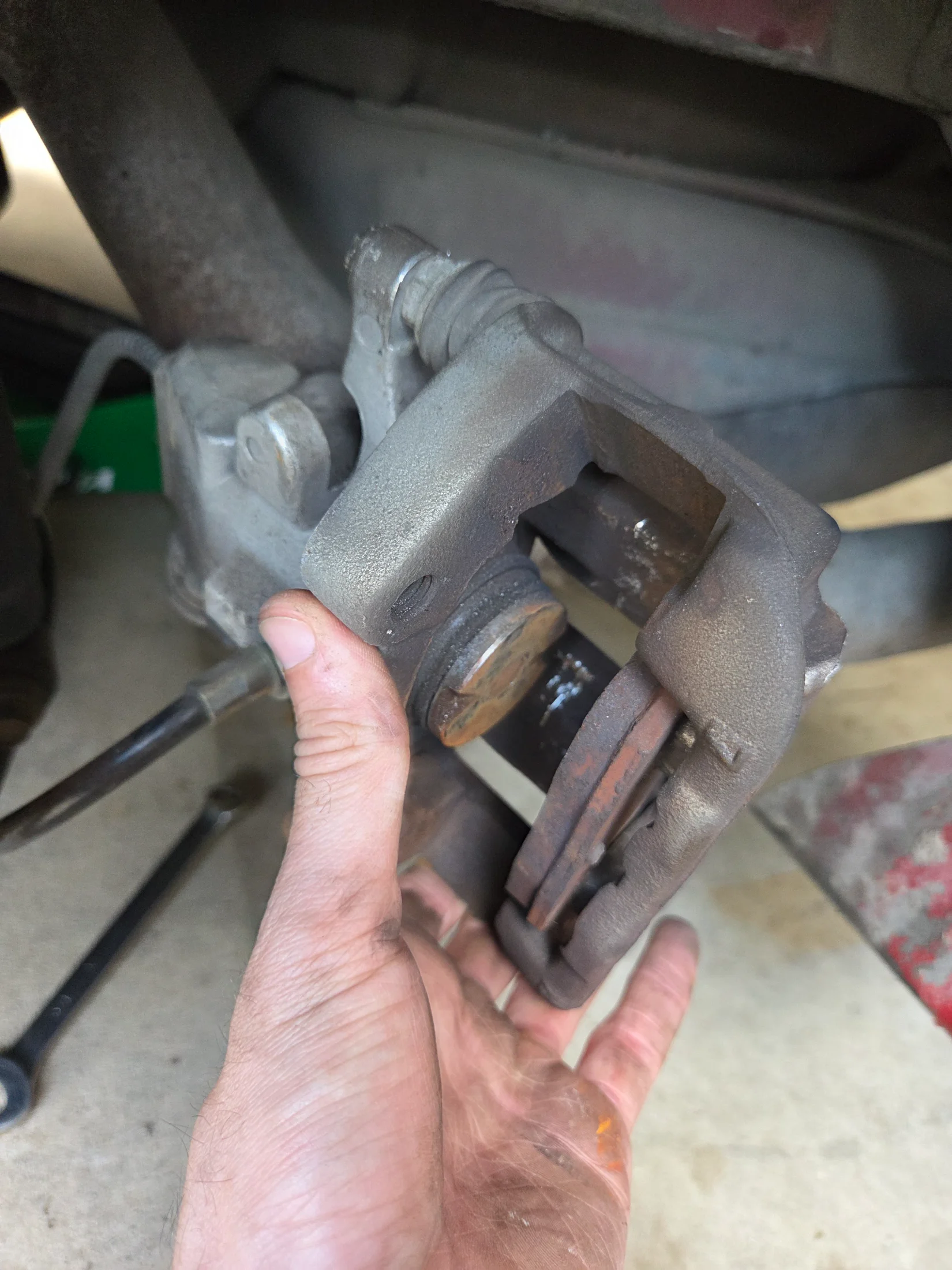

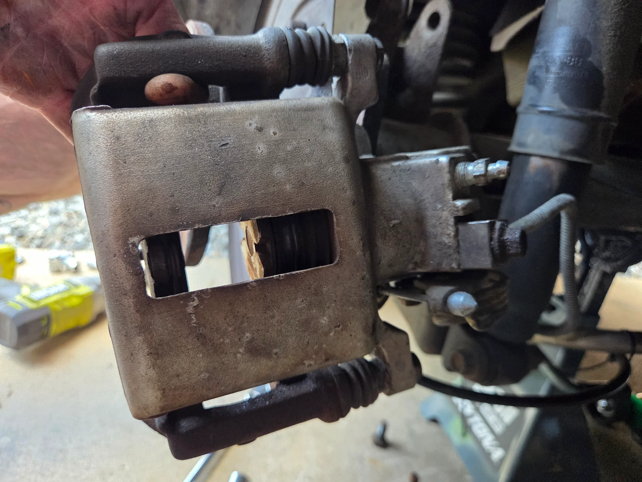

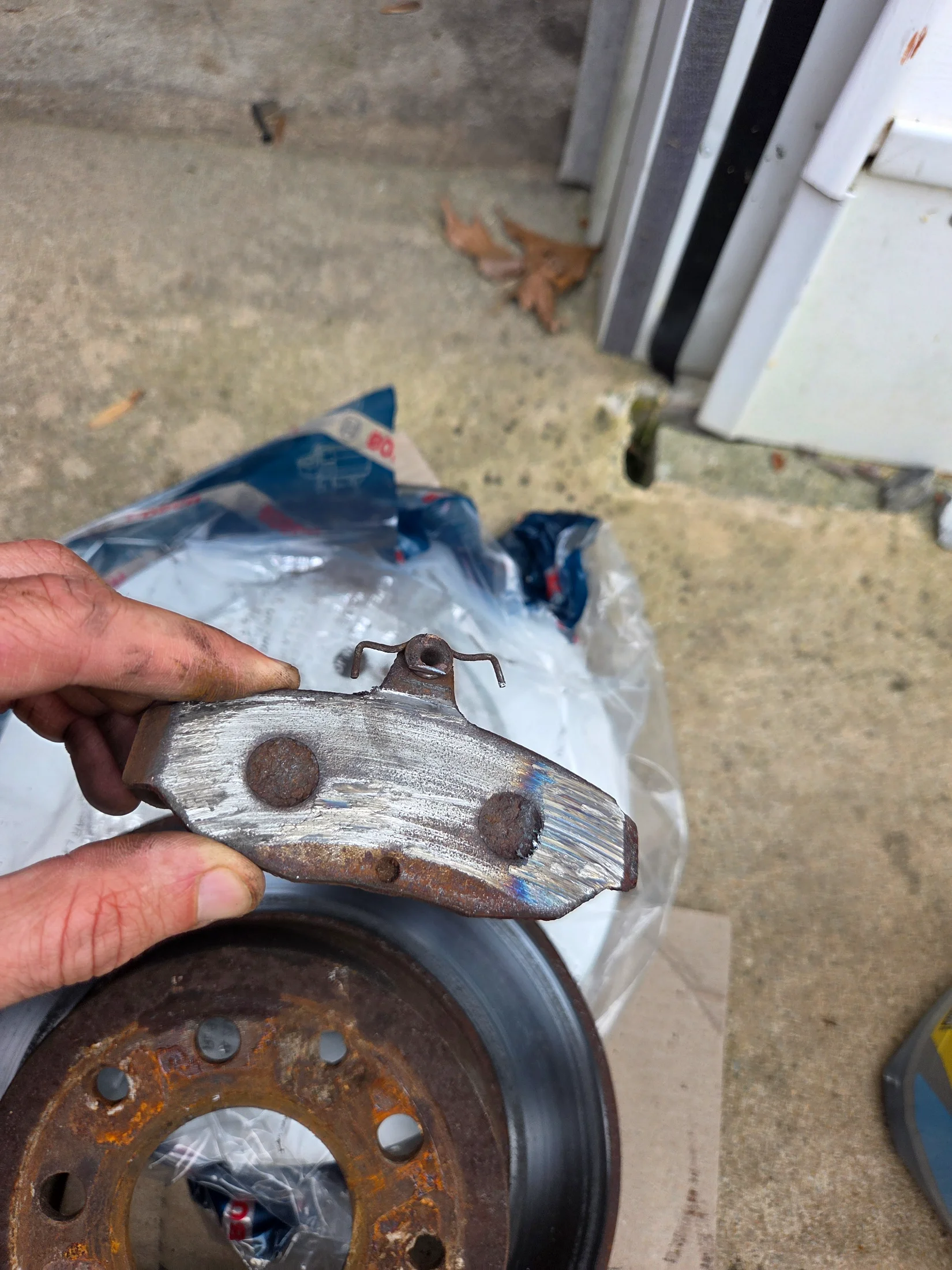

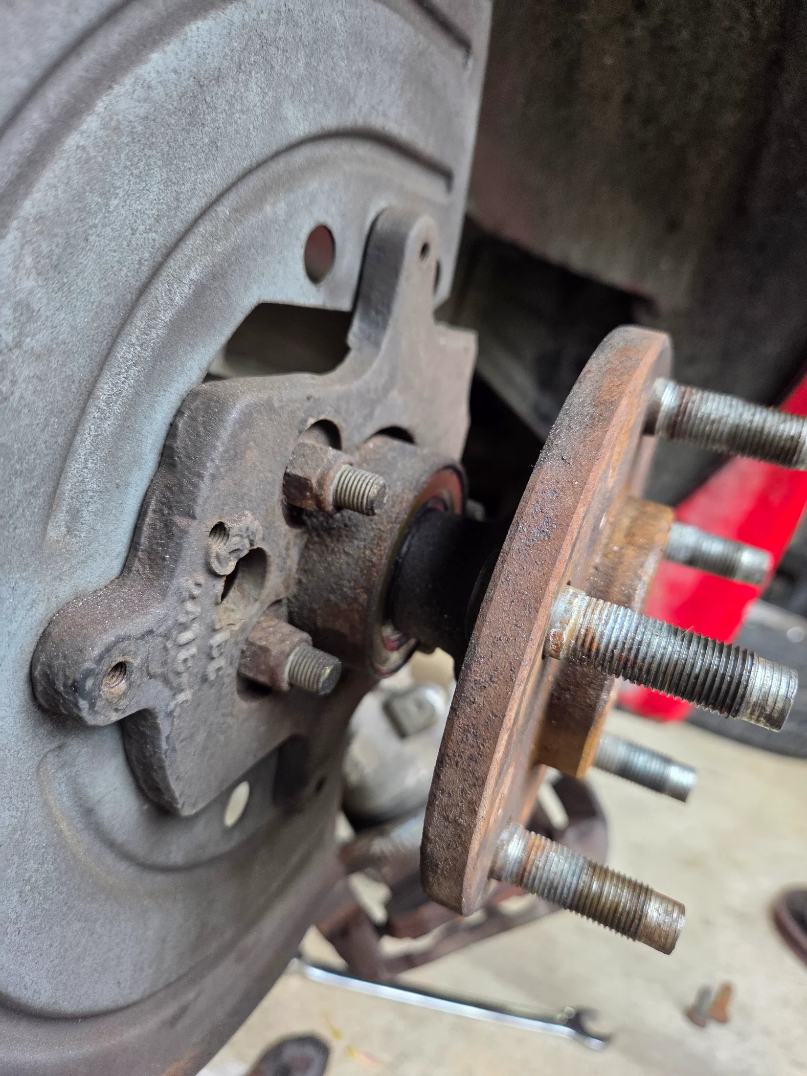

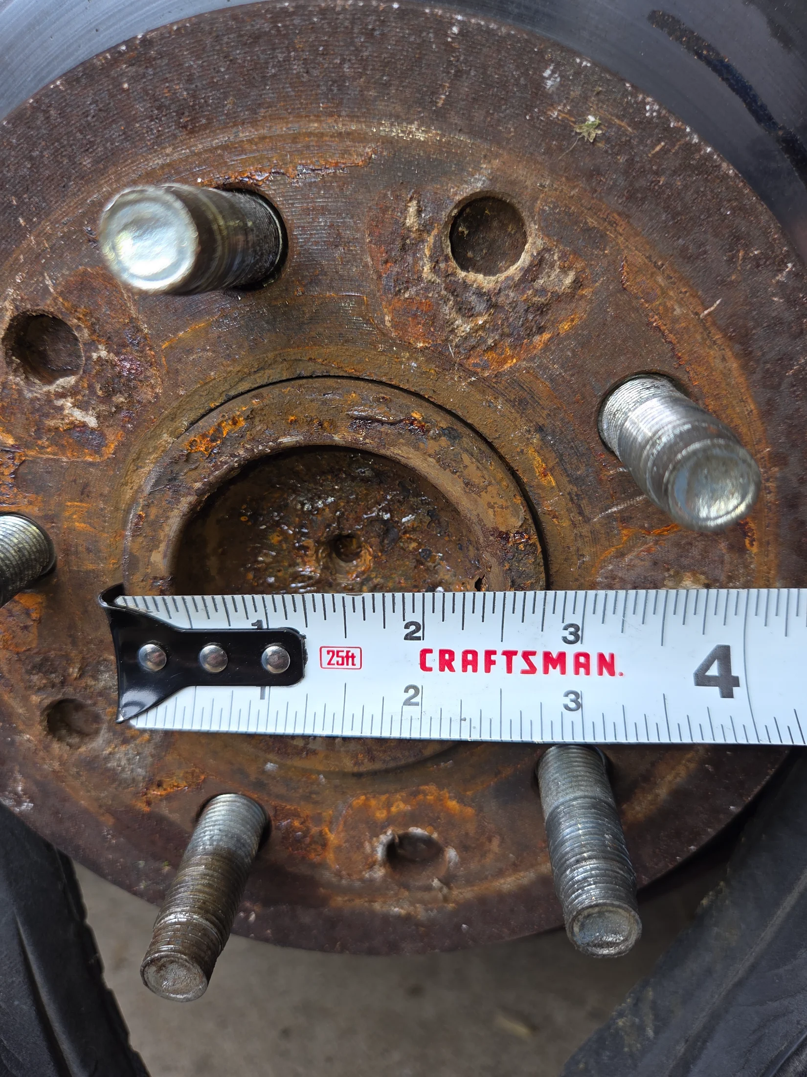

Hello all! First post here and I need some assistance. I bought my fox last March and its time to do the rear brakes. The problem is have is I don't know what i have. The rotors don't seem to match exactly to any setup I can find that is normal and have clearly been redrilled for the 5 lug bolt pattern. I also have adapter brackets on there.
I'm thinking that if I get the cobra 10" rear rotors and pads from LMR that it will work but I'm not certain what this adapter kit was designed for. Any insight would be appreciated!

94-04 Cobra rear brakes are 11.65” and V6/GT rear brakes are 10.5”.
With the double wheel stud pattern I would guess aftermarket like SSBC.
