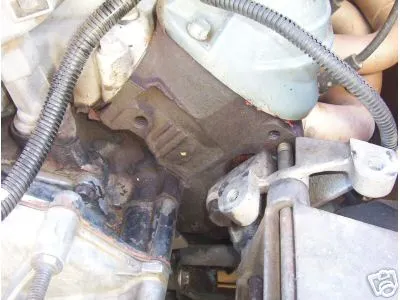

The lines will be on the FRONT of the head. Where the accessories bolt on. Not the headers. The front of the motor not the side. You get me. I will try to find a pic.
