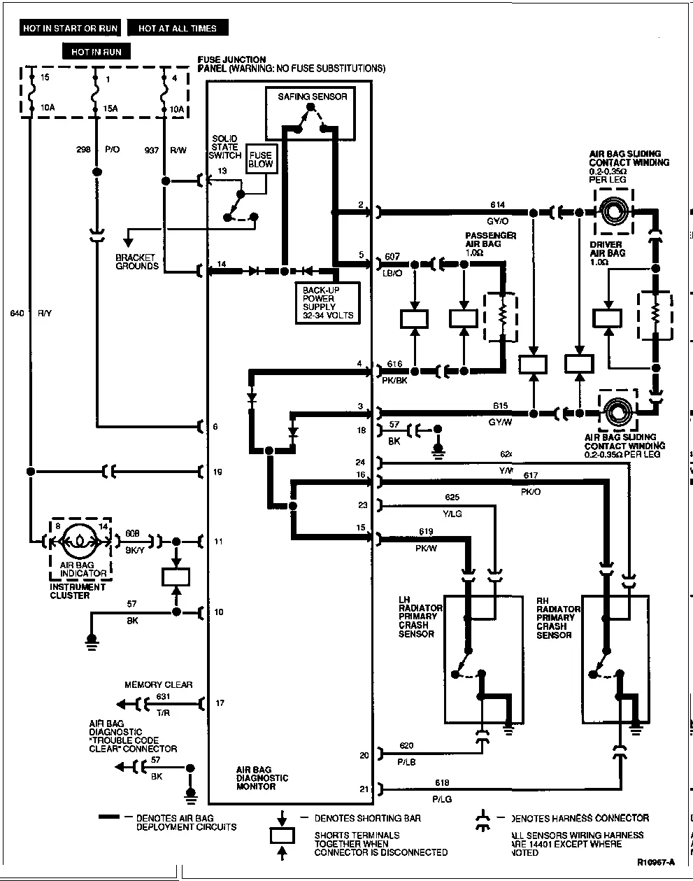

From the Veryuseful:
Admin Dude
Jan 4, 1985
43,353
21,554
Box behind Walmart
Jun 23, 2024
  • Jun 23, 2024
With this diagram and the one is the post above, I'm lead to believe that the battery backup is [integrated] into the [Airbag Diagnostic Module] and not separate. Could be the reason you're not finding it.

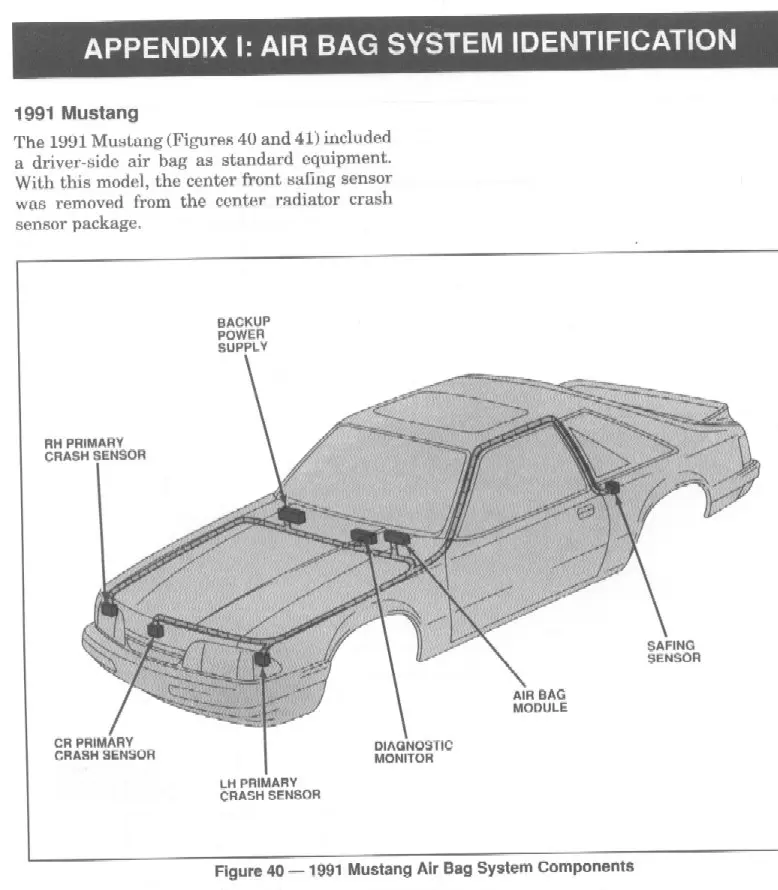

Here's an image that shows a separate module and its location:
Also from https://veryuseful.com/mustang

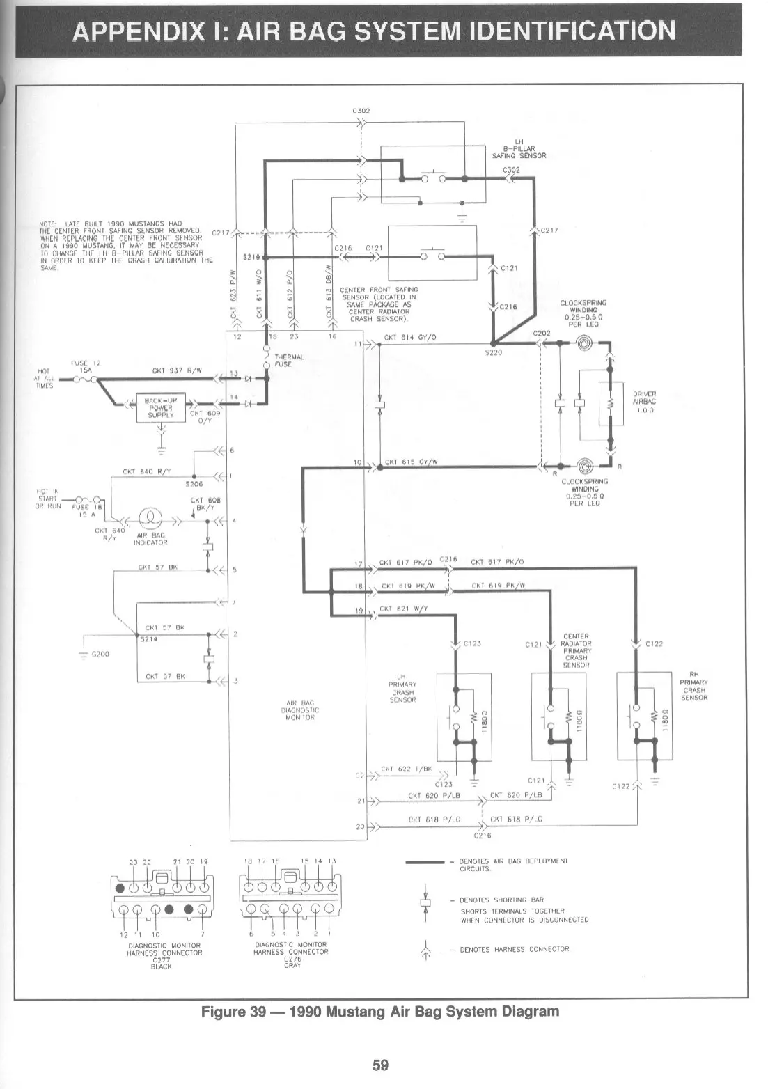

Here, it appears again:
From what I can tell, 90-91 had a separate battery backup while in 92+ they are integrated into the Diagnostic module.
