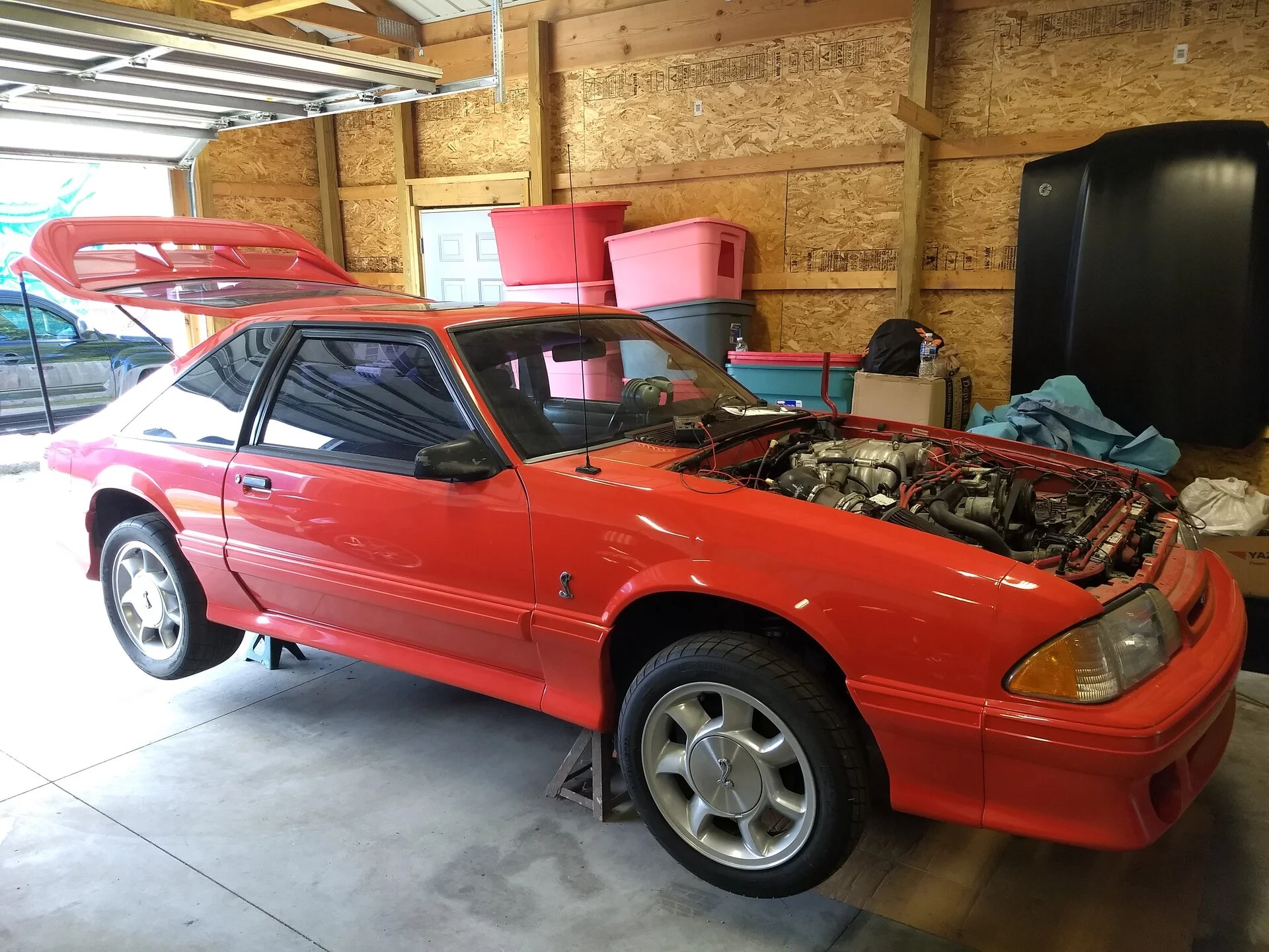

Owner (very close friend) has been battling this issue for over a year. Car will start and run for about 20secs,then die. With the key in the ON position, you pull a plug wire and put a plug in, it will NOT spark. You cycle the key back to OFF, the car will start,or throw spark at said plug EVERY time. If you pull the plug from the TFI module,and plug it back in, it will start or throw spark as well. There are no aftermarket electrical items hooked up to the car. We have tried two different ecu's, two different coils, and two different distributors. All three of these items were from my running,driving car so we know these parts are good. If you hook a dvm to the coil,and turn the car over,you can watch the voltage drop. We pulled codes as well, but IMO they wouldn't cause this issue. I can post those later if necessary. So,where do we begin?

To me it doesn't seem like a part because you have replaced with known good ones.I believe it's a wire or wire connector.start with coil connector/wires.

So,gang,I'd like to touch on this and hear some thoughts. The shop said it was the wrong oil pump shaft,which it was. However,how would the dizz not being seated all the way make the car shutoff? It has no way of knowing the installed height of the dizz. They claimed because the dizz was not locked down the timing was jumping back and forth causing the ecu to shut the car off.
My thoughts, since the 351 shaft does not fit into the 5.0 distributor hole it was riding on the end and slipping causing the distributor to stop/start turning and shut the car off.
My question is if it don't fit the distributor and fits the oil pump is the oil pump wrong?
