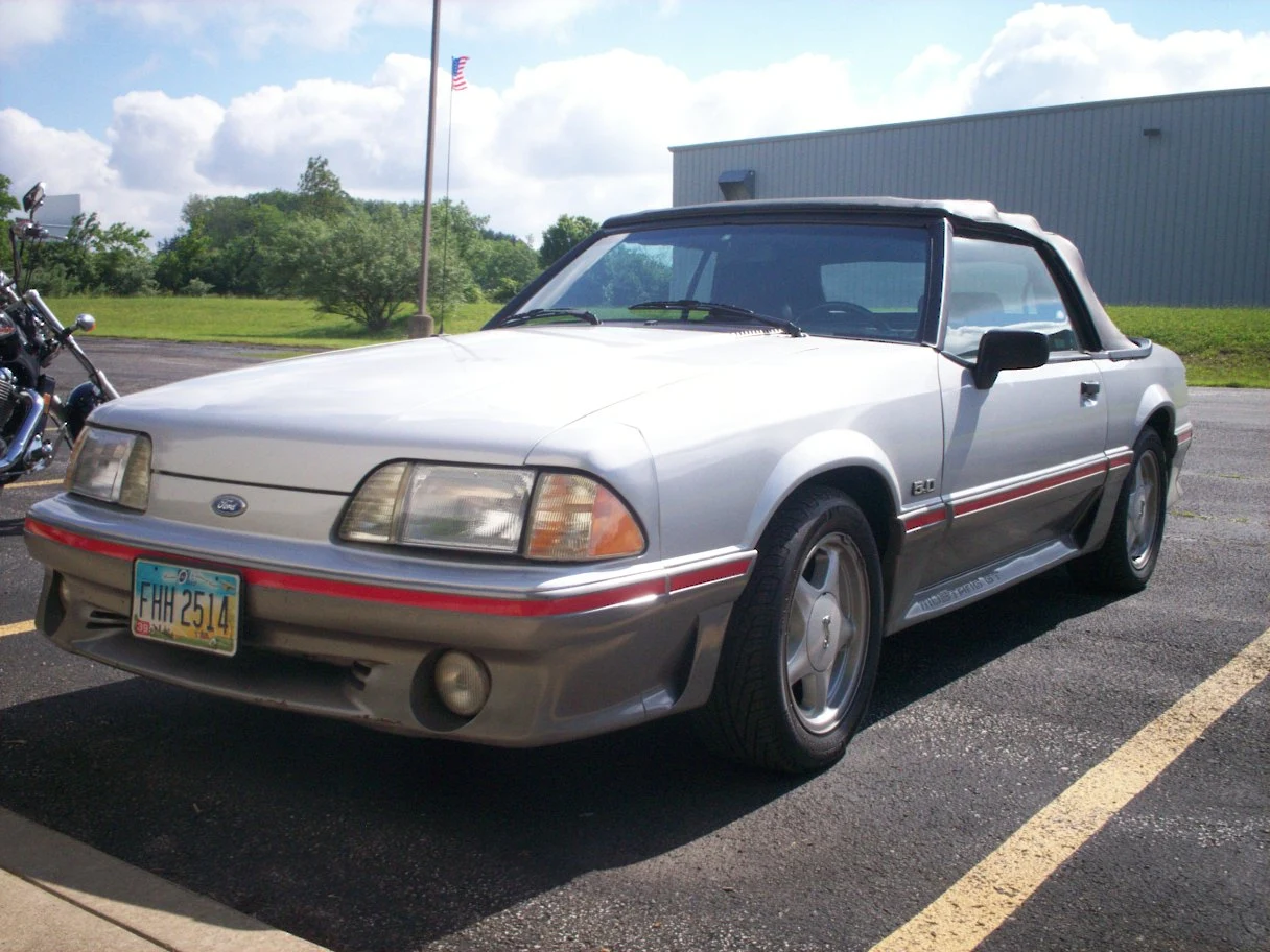

My 93 GT convertible has a beat up nose. Is it easier to replace it with new rubber or should I spend the 8+ hrs to fix it?
The nose is worse than the pics look. It has several gouges and the lower is swelled below the fog lights. I riveted a piece of sheet metal under neath each light to help.
If it is really trashed you should probably replace it. I don't think Cervini's offers a factory GT nose (although i could be wrong I suppose) but they do offer the stalker nose. I don't personally care for it, but Madspeed is right that they have top notch parts if you decide to go that route.
I know latemodel offers a reproduction GT nose, but I have no experience with the quality of it. You could probably find a used one in decent shape with a little bit of leg work.
What are your plans? If you are just doing a repaint of the nose then it might be worth it to try and save it. If you are doing the whole car, though, I wouldn't want to take the chance.
