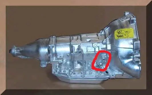

and last but not least...anyone have a pic on which ports I use for trans cooler?

Here's a picture of the ports you need to use for the trans cooler. The upper port is out to the cooler and the lower is the return.
Thank you sir for info...guessing your photo got deleted for some reason though???

Picture fixed, sorry bout that. hope it helps.

Fantastic..thanks!

TV cable came in mail yesterday, put car back on lift, raised her up, and getting ready to install it, and decided to take a peak at teh trans cooling hookups frompic you gave me.
Guess what? Those holes on this tranny are BLIND! The ports are there, along with threads, but like I said, holes are blind. So,next question...what gives with THAT???

Ohhh, well thats a new one to me. That isn't something i've come across before. I know there are special quick connect fittings that are used to hook up the stock cooler lines, but if the holes are blind these won't help you at all. At this point i might suggest that you call the shop that built trans and see what they have to say because I can see no reason for those holes to be blind. Sorry I couldn't help you, I'll keep tabs on the thread if you have any other questions.

Basically after determining that every single AOD ever, those cooling ports are present, that if mine were "blind" would have been a "lottery" type of situation, I examined the ports more closely.
Problem? Well, the shop that rebuilt it, had placed plastic plugs in the ports, and then painted it.
I'll be the first to admit that it would have been alot easier trying to find that out with tranny on the table, but I had put tranny in car before I had determined the above. So, trying to get a good line of site on the ports was difficult, even with car on a lift.
