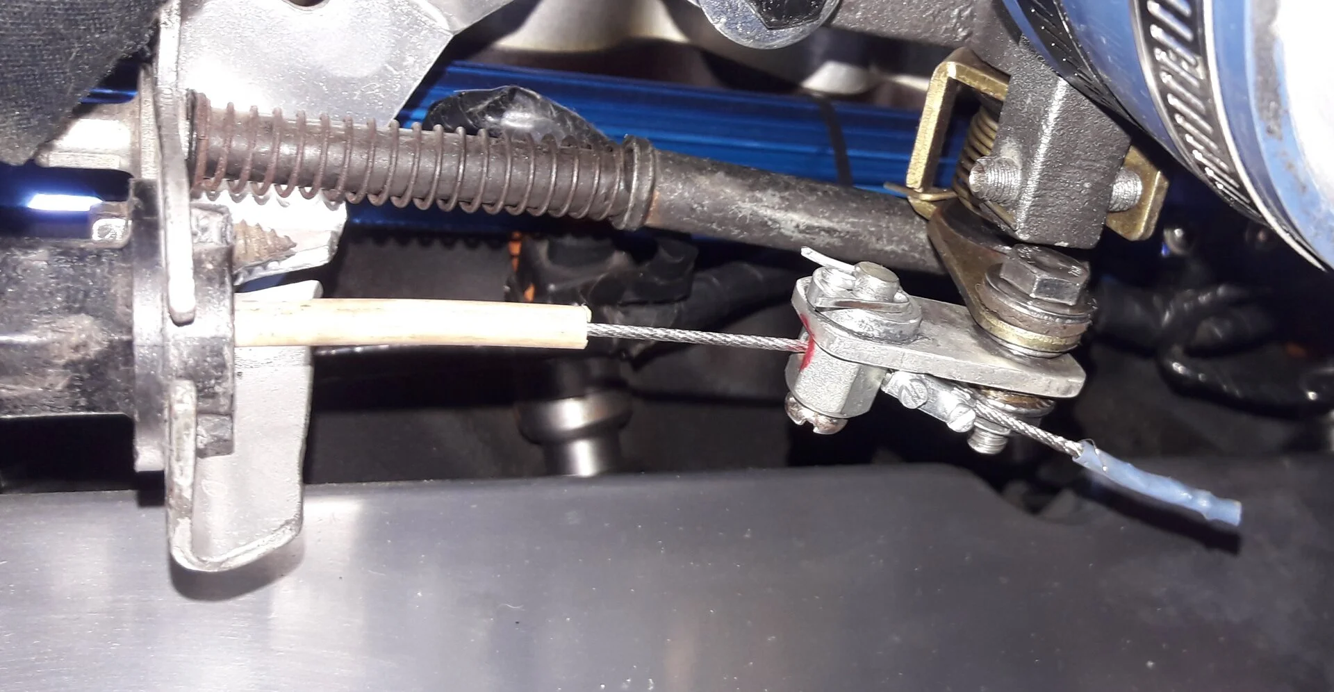

my Plastic Block was bad ..so i invented my own adjuster .. easy to adjust and works perfect :nice::nice: I have a rebuild AOD with some mods, PA Valve Body and TCI 10inch lock up Converter ..
