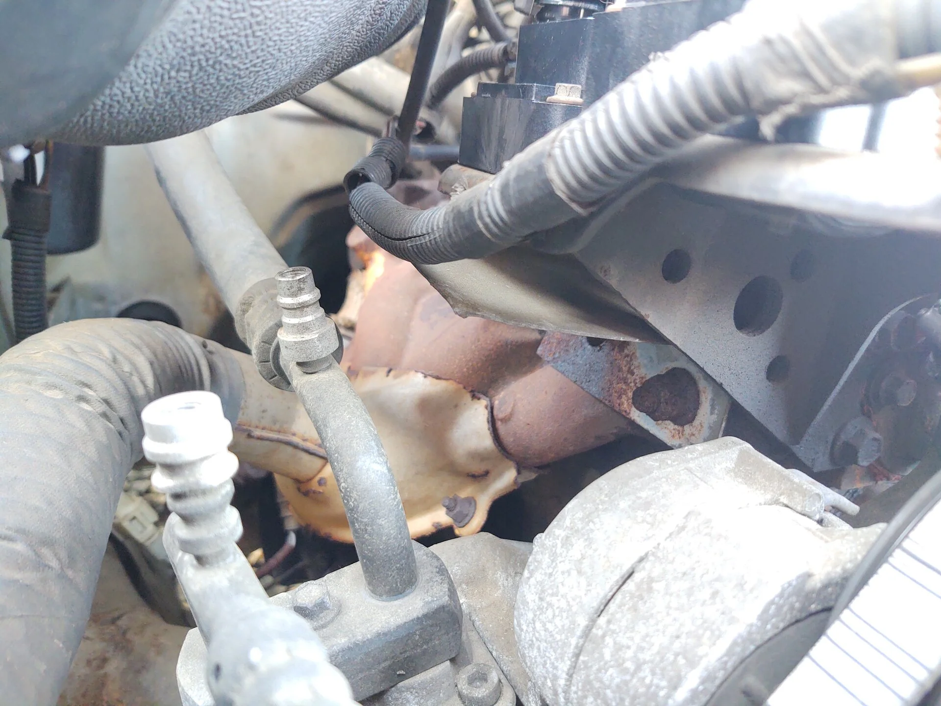

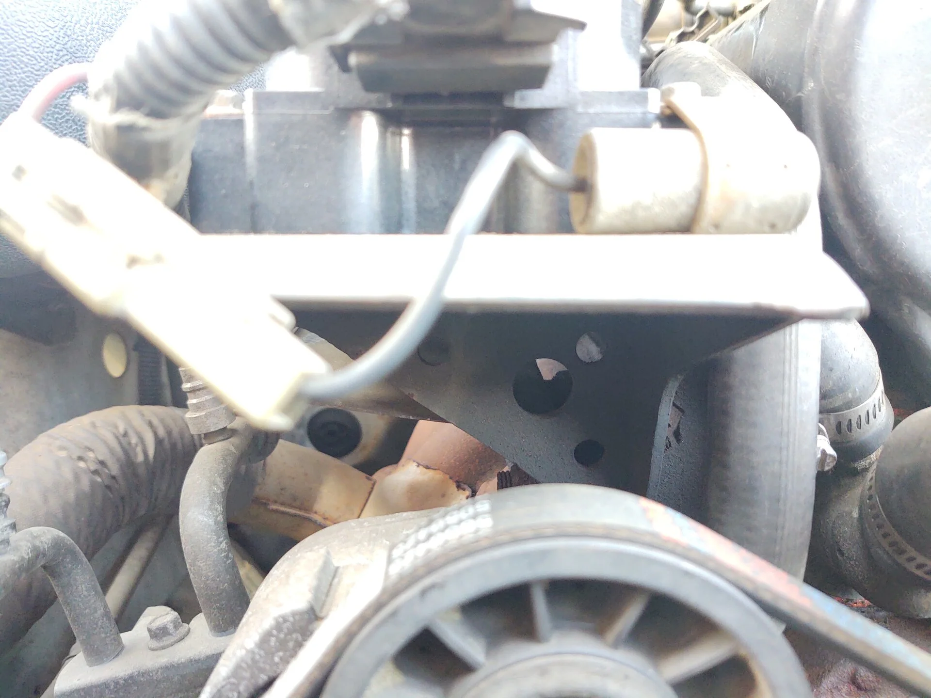

The location of the coil packs on the 2.3L is pretty undesirable - right above the exhaust manifold. There is a heat shield that should be in place, although it is rather small and crappy. I would make sure that it is in place, though, because heat kills ignition coils. Creating a larger heat shield or relocating the coil packs may be a good idea if they continue to cause problems.

Also, here are pics of my heat shield.
