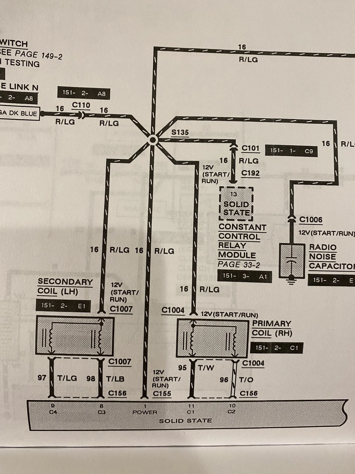

code 222 is loss of IDM signal usually indicating an open wire from the RH coil (primary)
You’ll want to test these wires (95&96) from the RH coil pack back to the ICM and see if you have continuity.

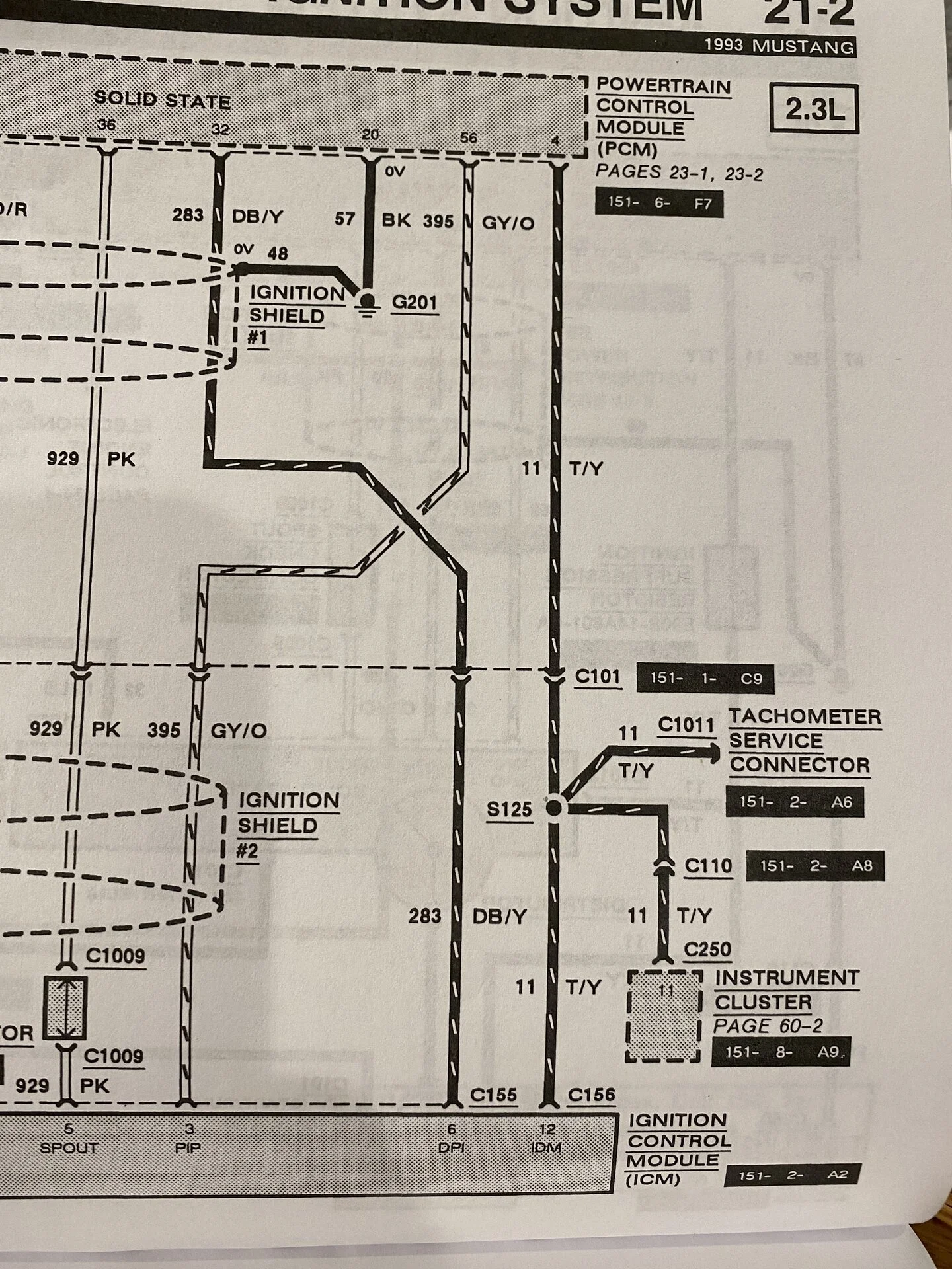

If you have them, test the signal IDM wire from the ICM back to the ECU. Pin 12 on the ICM to pin 4 on the ECU. Usually if this is bad you get a code 226
If those wires are all good, it may be a bad ICM
You can always check wire colors to verify right/left. According to the wire diagram the Left coil has Tan/Light Green and Tan/Light blue wires while the Right cols has Tan/white and Tan/Orange wires.
