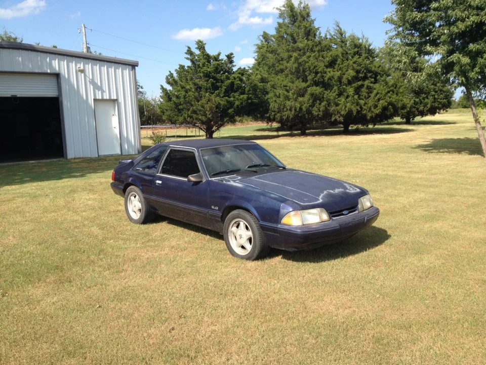

Hello all,
I recently became the proud owner of a completely stock 93 Hatchback. Attached is a picture of her in all her glory. Despite the neglected paint, the interior is decent and the engine is in great shape with only 54k miles.
Now, this isn't my daily driver. Rather, I bought it as a project to work on in the evenings and on weekends. My goal: To build a car that's fast, fun to drive, and also comfortable to ride in. I don't see myself ever taking it to the track, so weight reduction at the cost of comfort is not what I'm looking for here. That being said, I am looking to do quite a few things to the engine, but I want to keep the small block. Off the top of my head, I'm thinking subframe connectors, aluminum heads, intake manifold, cold air intake, fuel injectors, mass air flow, drivetrain, axles, brakes, cam, 5-lug conversion, new exhaust system, lowered suspension, and eventually forced induction, just to name a few off the top of my head. I know those aren't in the correct order at all, which is why I'm asking educated individuals such as yourselves for advice.
I know that a proper tune-up is first, so I've already done new spark plugs/wires and next will be an oil change with new filter, a new fuel filter, new antifreeze and a thermostat change. I'm also aware that subframe connectors need to happen as soon as possible, so I plan to slap those puppies on and reinforce the torque boxes next.
Now I've done days worth of research, and learned a lot of things, but I'm still unsure what needs to happen next. That's where you guys come in. My main question is this: what steps do I need to take to reach my goal? More specifically, what order do I need to do these upgrades in? And what else did I forget?

Your on the right track do subframes first then work on suspension mods, new bushings and so forth.
The 4 lug stuff will do just fine for now until you can afford the rims and tires for the swap.
How much of a budget do you have? Aluminum heads get pricey for good ones and depending on your goals there are great junk yard builds we can offer for good power. You can almost achieve 300rwhp from junk yard parts! Though some effort and time is required.
First thing to do is go from the front to the rear bumper and fix the things that are wrong and/or need preventative maintanence. I'd change all the fluids, filters, give it a tuneup and replace worn parts in the suspension, brakes, drivetrain,etc. Check the torque boxes for signs of damage and if they are torn install a set of battle boxes. Then I would address the suspension with subframe connectors, new poly sway bar link bushings. For driving and performance, an aftermarket MGW shifter, 3.55 or 3.73 gears, a cat back exhaust., K&N air filter, bump the timing to 12-14BTDC.
There are many choices for the suspension, brakes, engine, etc. Just remember the more you add performance parts, the farther away from a stock ride and driveability you'll get. These cars can turn into money pits very fast.
Make a plan and a goal of what you want the car to be. I'd recommend you do not remove things like the A/C, P/S, as you will regret it down the road.
Welcome and feel free to ask away. We;ve all been there and can help.
