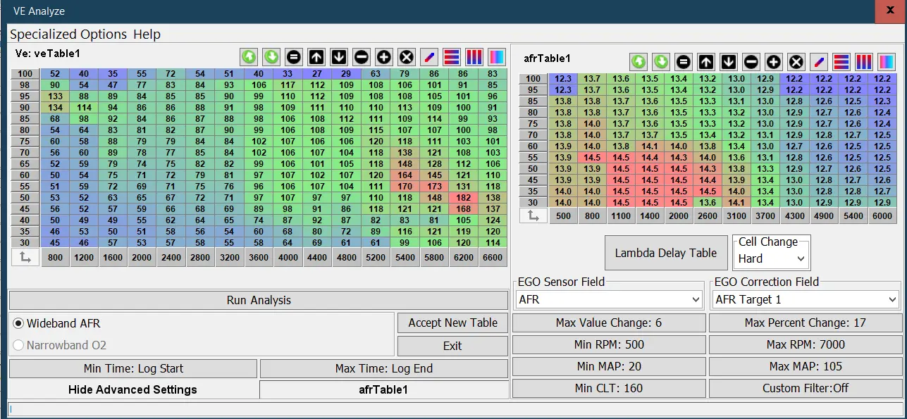

93 Mustang Ok built tune myself just wandering if there are any red flags in it.
X-cam34
Jun 22, 2025
84
27
28
ten
Time ok ? Afr targets ok? Car runs fine and pulls nice but i did all of this over two months and an extreme amount of google and the help of ai. Since it has taken so long i have done a lot and not sure if everything is gonna be good to go for daily drive or should i take it to a tuner... Almost done the first one is where the logs came from and the !2 is after ve tune on hard mode with these settings
