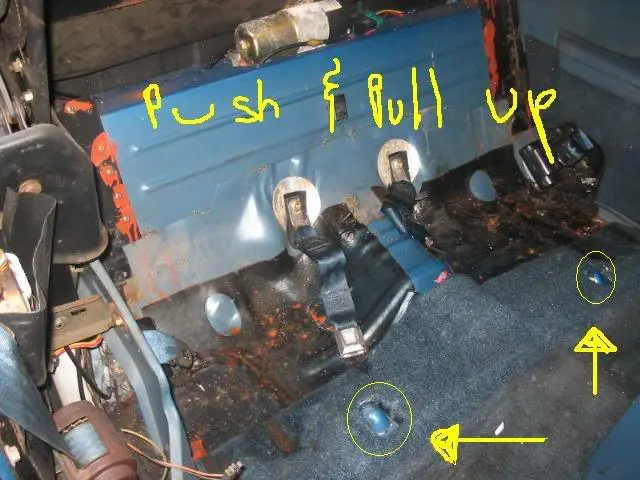

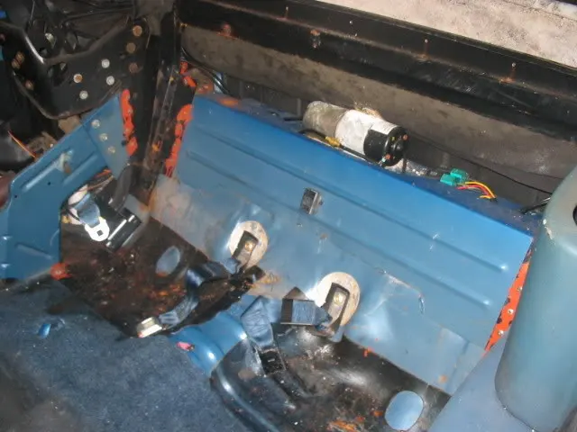

the nice thing is is that it will take you all of 5-10 mins to get them out..the bottom of the seat you just push in and pull up...it will slide right out..the top of it has two bolts on the bottom that were umm 5/8 i believe but dont quote me on that then there is i screw in the back and 2 in the front if i remember right..then pull switch cover off and pull the panel towards the front end of the car and then out...very simple
while your at it you mit as well check the other side.
I didn't know the seat came out that easy. lol Yea I'm goin to. THX
yeah its pretty stright foward..you will have easy access to your top motor while you have them out so check that out to..
makes it easier
notice the lil pink race car that was under my seat lol
And once you have the motor out, it takes 2 mins to pull the cover off and inspect the gears. The two most likely scenarios are that the bushings themselves took a dump, or that the race split. If it's the latter, what often happens is the motor makes noise but the window won't move. It's easier for the race to split than it is for the output shaft to drive the window upwards, so it takes the path of least resistance.
