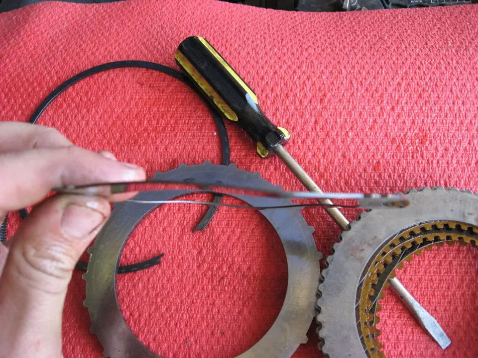

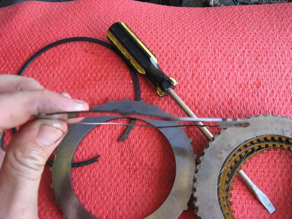

+1 for talking to dan at silverfox. He's good stuff. If it were "newly rebuilt" per the original clutches and steels you may want to get it rebuilt with some higher performance steels and clutches as well. I bought mine off a fresh rebuild and I was kind of surprised that my measly little 289 could warp the steels.
this is what happened to mine after a weekend of driving:
:o
