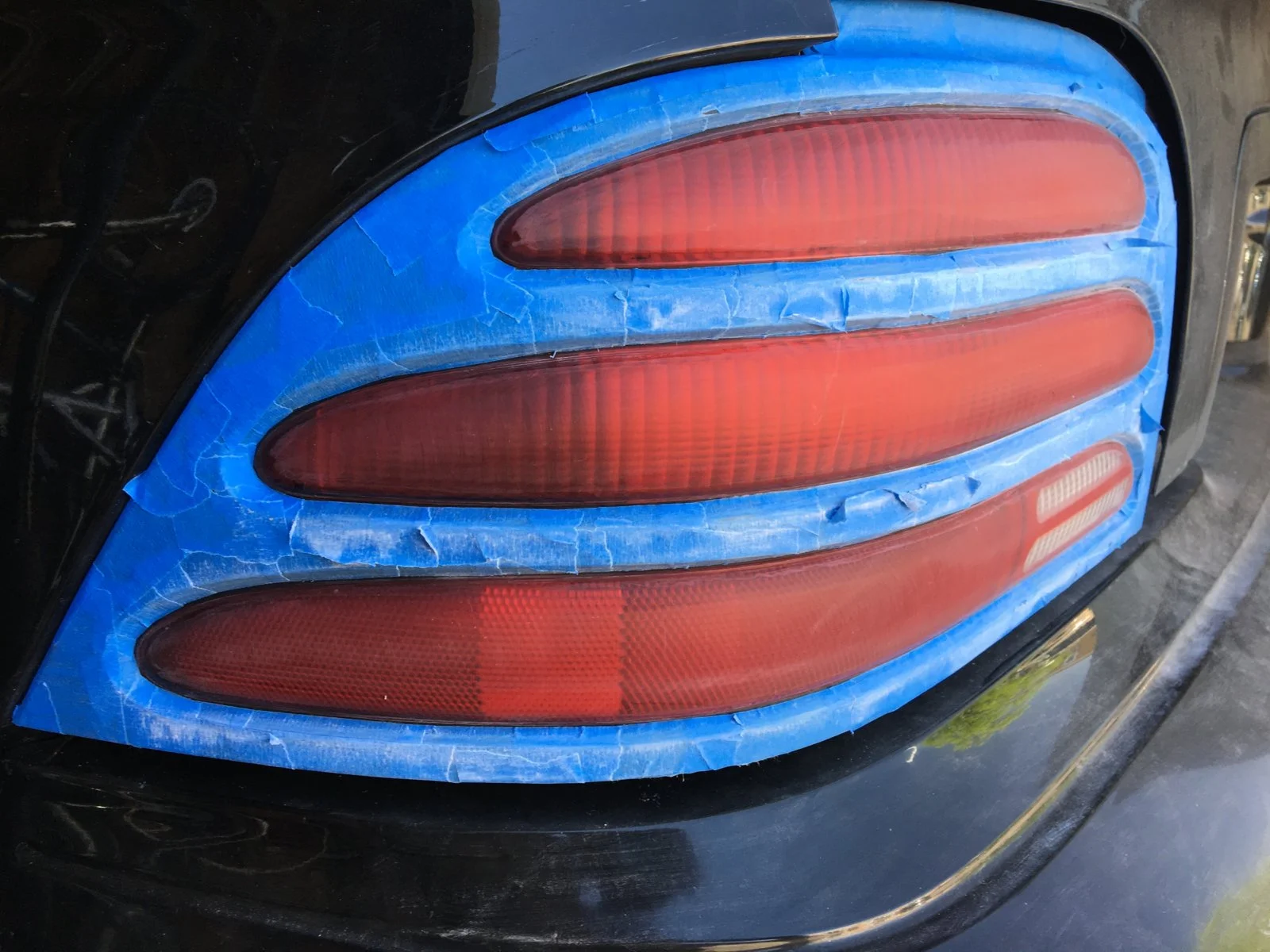

I opted to remove the tail light from the vehicle to prep the tail light, which consisted of cleaning with soap and water and taping the bezel. This also allowed me to clean all of the gunk that has been accumulating behind the tail light since 1994. You could probably get away without removing the tail light, but it's really simple to remove and this way allows you to work on a bench/couch/etc.

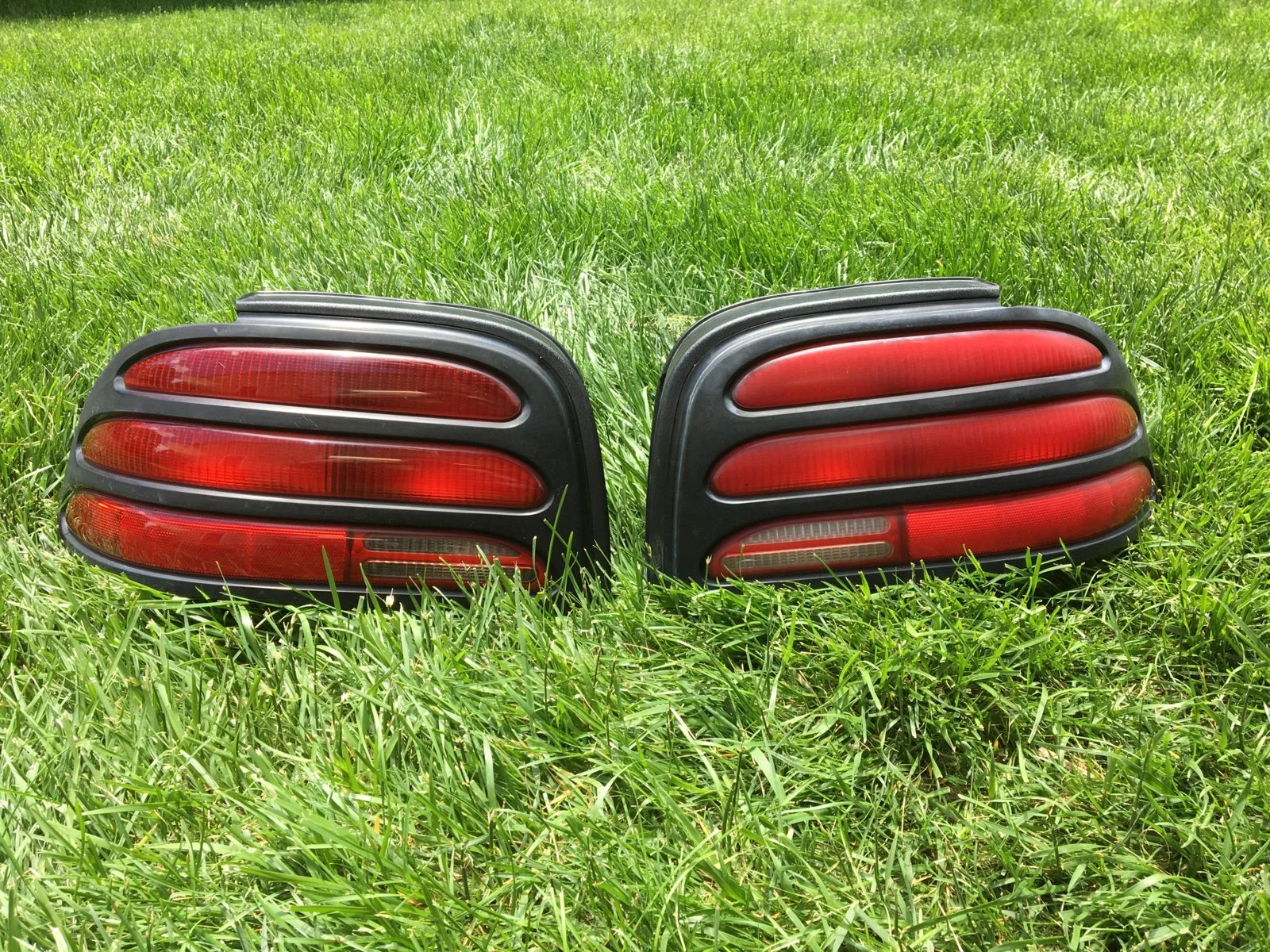

I took a side-by-side picture of the finished drivers side and unfinished passenger side for comparison purposes:
The contour of the tail light where the lens meets the bezel made it difficult to sand the 1/8" or so near the bezel. If you attempt to finish your own tail lights, I would also recommend doubling up the tape on the angled portion of the bezel between the individual lenses. The most time consuming part of the entire process was prepping the tail light.

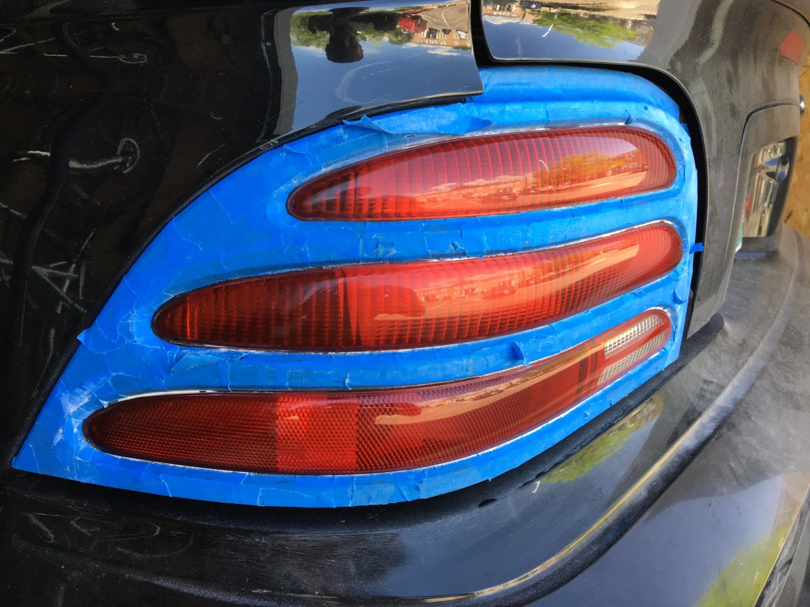

This is after the P500 (coarse) sanding:

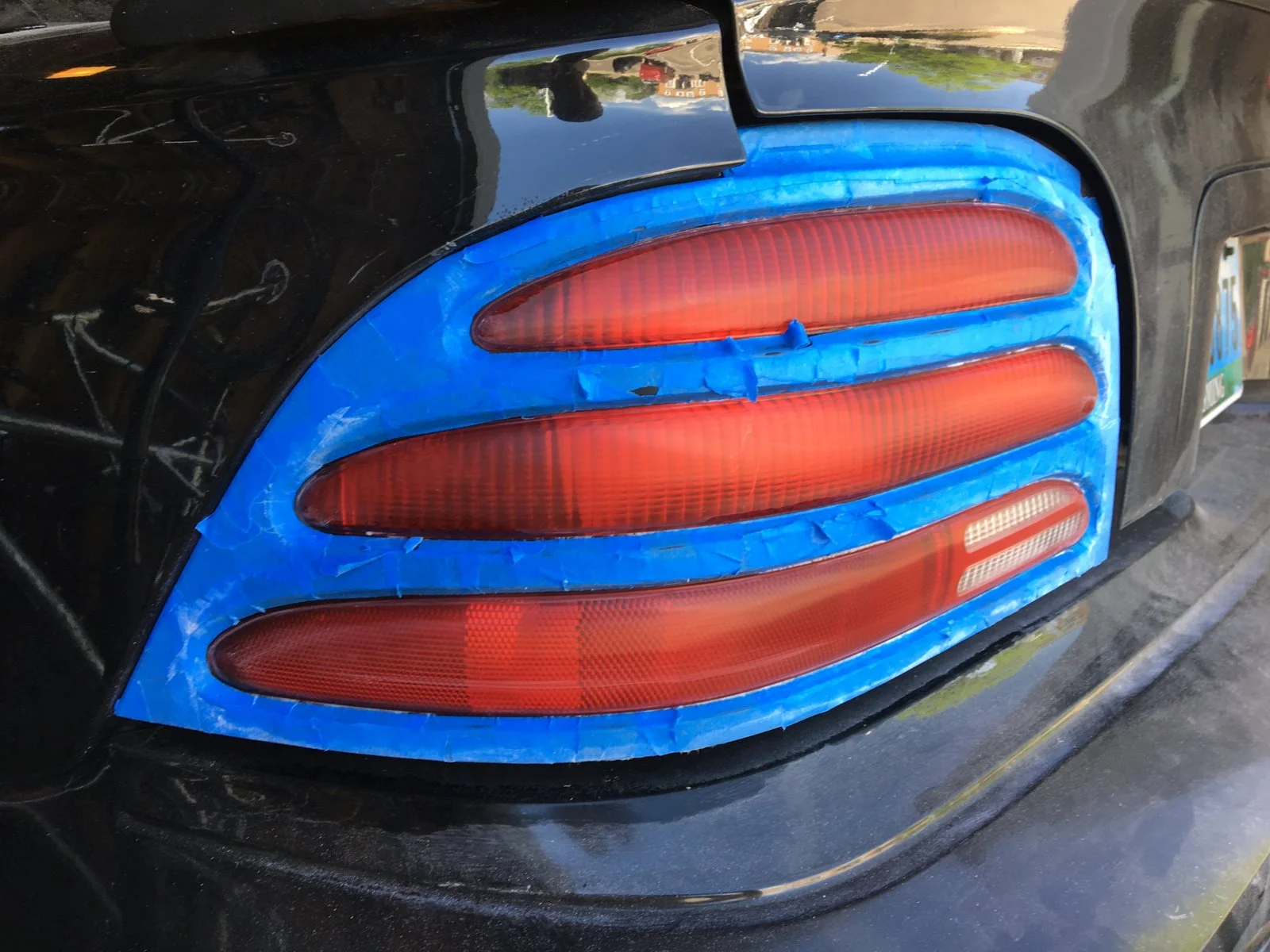

After the P800 (fine) sanding:

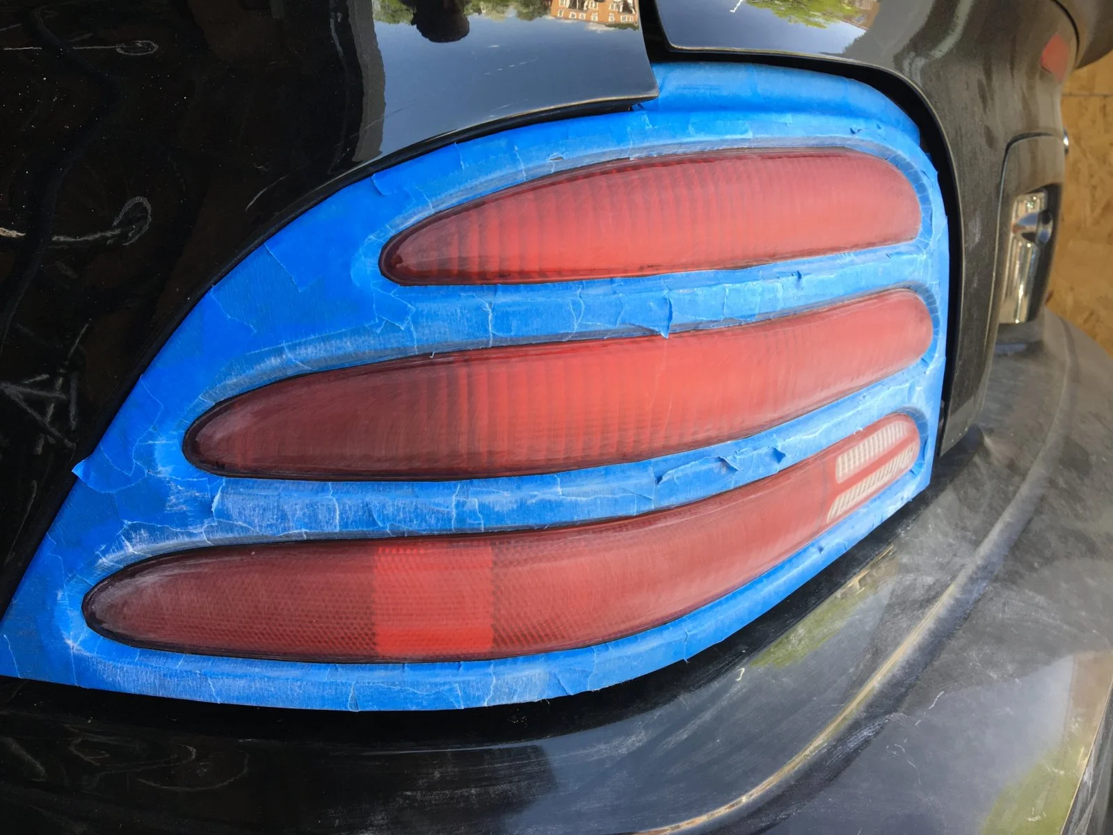

The third sanding step was conducted with a P3000 Trizact disc. According to the 3M website, this is a proprietary abrasive product that produces more consistent cuts compared to conventional sand paper. This is because it is manufactured in layers, so that as abrasive is worn off of the disc, new abrasive is exposed. That's what I read, anyhow. The Trizact disc is used wet:
