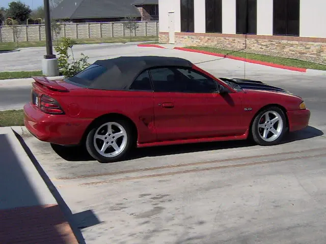

Not the best angle, but you get the idea.

Hey Nacho (95Vert),
I like the way your car looks with the metal piece around the license plate blacked out. I did mine the same, I think it looks more complete than just painting the taillight housings.
Thanks Glen. I also think it looks better, more complete, like you said. A lot of people were'nt sure how it would look, but after seeing my pic, they made up their mind. I like it, but now it needs a touch up.
