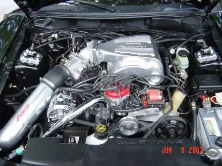

my eddy RPM2 manifolds fits under the stocker hood, barely, it does hit in one spot but can be fixed very easy. i also have 2 washers under the motor mounts, so without those i doubt it would hit. i have regular size VC's its the eddy chromes. fits, but not my much. i have magnum 1.6 rockers.
I use the AFM polished covers and they clear my comp magnum 1.6s and they just cleared the EGR tab on the Holley. BTW I dont use a spacer for the Holley. The oil fill tube is a tight fit with the AFM valve covers, but It still works.
95opal - Thanks for the pics man and info! Very helpful. Now you've opened up a few others.
We have nearly an identical set up (see below).
1. Whose strut tower brace are you using? and which model? I've tried half a dozen different ones with no luck. They all hit some where either on my Holley intake, the throttle body, or the AFM power pipe. I have a vert, so I REALLY notice that I no longer have the added strength.
2. Speaking of power pipes, is that the rubber reducer (where the 3" pipe meets the the throttle body) that came with you power pipe? Mine came with a different one, which is much bulkier. Due to the size it causes me even more trouble with the oil fill and strut tower brace.

I am using the Steeda STB.
I dont have the power pipe. I made my own with 4' tubing. Its a straight shot no bends. The fender apron was cut and modified so I could get my 95mm MAF inside the fender. The reducer for the throttle body was picked up at a local speed shop, its silicone and fairly thin so I just have enough room. You can get the reducers online or any local speed shop.
