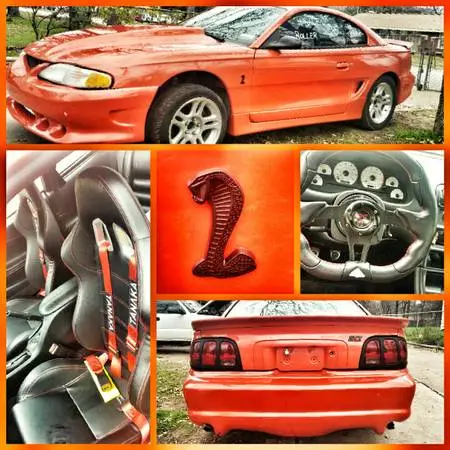

i just got a 94 cobra shell and i want to swap my 94 gt motor&tranny in it. will this be a straight swap or will this require any extra parts? i figure since i have a donor car of the same year this will be simple. will the car require any mods because it was stick?
