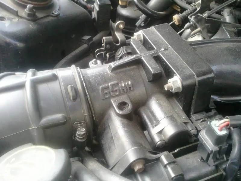

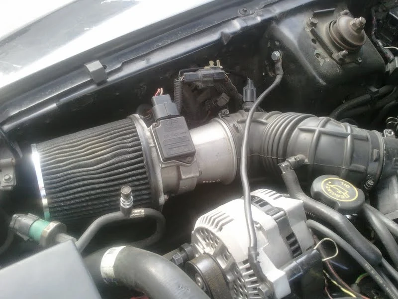

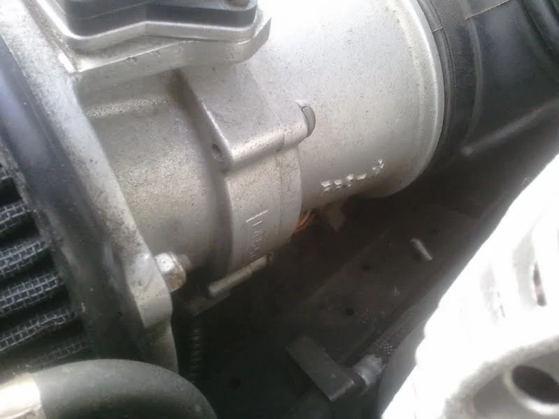

Update, car does not run when MAF is plugged. I figured out that the MAF sensor is for a stock air box set up, meanwhile I have a PRO-M (pn 14557/14556) Mass air Meter. I also discover that the Throttle body seems to be some off brand and has "65mm" on it. Could these components be the root source of my issues? Here are some pics of the setup.

I think I may know why this is messing up. Seems the Mass Air Flow sensor is a stock replacement. But I have a pro-m mass air meter. Could that be causing the issue? Also I have the stock tubing hooked up to it, so it is incomplete. Any ideas if this could be the root of the problem?
Yes.... well kinda. The car has always ran really rough, thus it went into a shop. The shop replaced the MAF sensor with a stock replacement from autozone. I have since taken the car back to my house due to the guy not having time to work on it. I didnt notice the "Pro-M" casting on the Mass Air Meter until just now. The unplugged maf issue is new (since replacing the MAF).
One thing the shop noticed was a dead injector. They replaced that, and the car does seem to have more power, but still running rough, and shutting off when warm.
I think the Pro-M MAF housing was intended to allow the install of the filter without using the stock air box. However, it may have originally had a MAF sensor specific to that application. IIRC the stock TB had 65 MM casting on it. How long have you had the car and did you ever give it a baseline tune, such as plugs, wires, rotor and cap. Code 111 is a pass code there is no code 10 (all codes are 3 digits) and 157 is a bad MAF.
I have had the car for a few years. It has been sitting and never really ran right. But I am trying to get it together for the summer. Yes I did change plugs, wires and the cap and rotor. I think the MAF I got is still under warranty from Autozone. Sounds like I should try to swap them out?
It could also be related to the cold air installation. Clear the codes and start it up with a piece of cardboard between the filter and the engine. I've seen open filters like that get messed up from the air coming off the fan. More likely it's a bad MAF though.

Yeah, that's exactly what I'm talking about. Some of those cold air setups direct air into the MAF at the wrong angle and it messes up the reading. The fan blowing on the filter aggravates the situation. You can also try reclocking the MAF so that the sample tube is at a different location relative to the filter. I would say tap into the MAF to see what reading you are getting, but if it won't run with the MAF plugged in, you really can't do that.

If I'm understanding your post correctly, the shop pulled the MAF element out of the Pro-M housing and replaced it with a stock MAF sensor element. I'm guessing that the Pro-M MAF the shop pulled out was tweaked for 24 lb/hr injectors, which is why the car ran before but rough. ...just my guess.
You might also check to see if your ECU was chipped. Someone might have done it correctly and changed the calibration for the Pro-M MAF and injectors (assuming you have higher flow injectors), and now the stock MAF is just incompatible with the cal.
Also, that 65mm TB looks like a ford racing throttle body. They're the only ones I can remember that cast the size into the body like that.
Good luck!
WhiteCobra I will check into the injectors when I get home. I was told it had 24lb injectors, but never verified myself by checking the color. Also how does one check the ECU? I think you are correct on the TB as well, I been researching and found that to be true as well. That being the case is it compatible with my setup? One last question (well 2) to check the injector top color will I need to pull the manifold?
