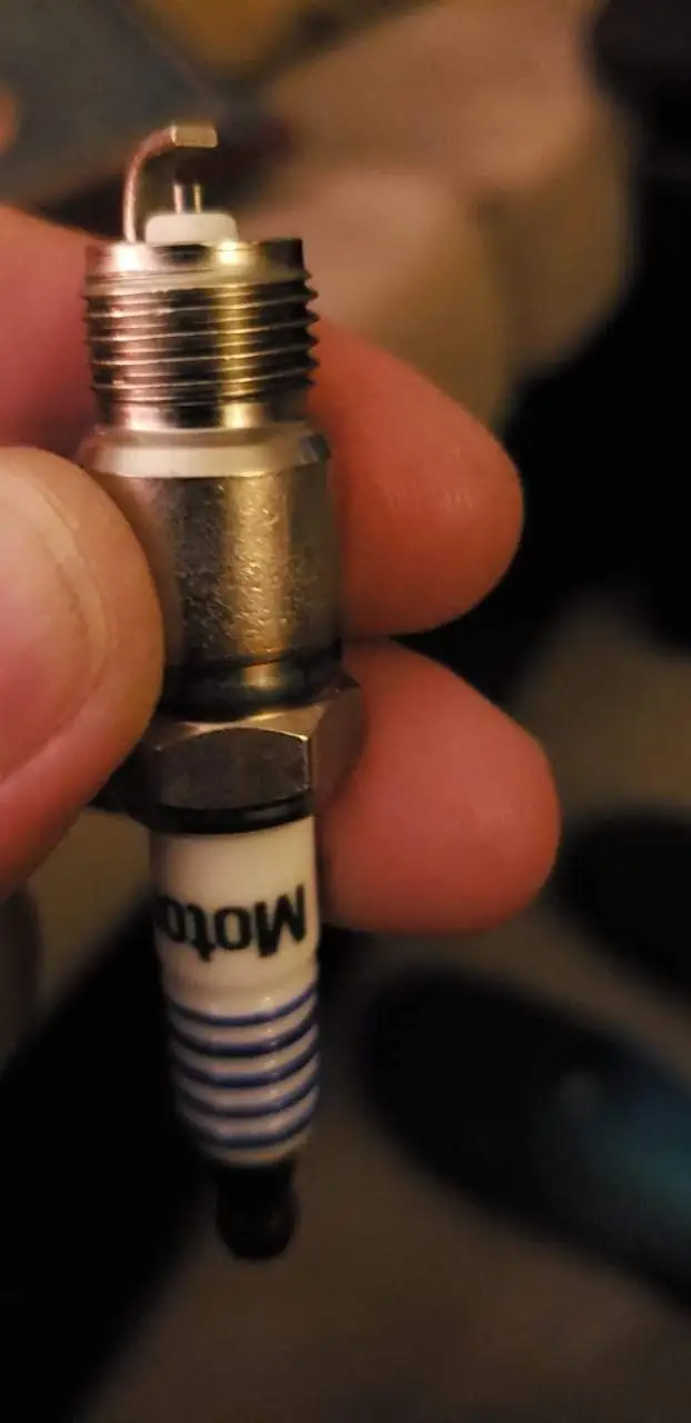

Hey guys just picked up screaming demon coil, live wires, cap, rotor and plugs. LMR says to gap them at .065... seems a little high. What is the magic #.
As big as you canho before you start experiencing misfiring.
In other words youmight have to experiment here and widen it up s bit at a time and then take for a test drive
