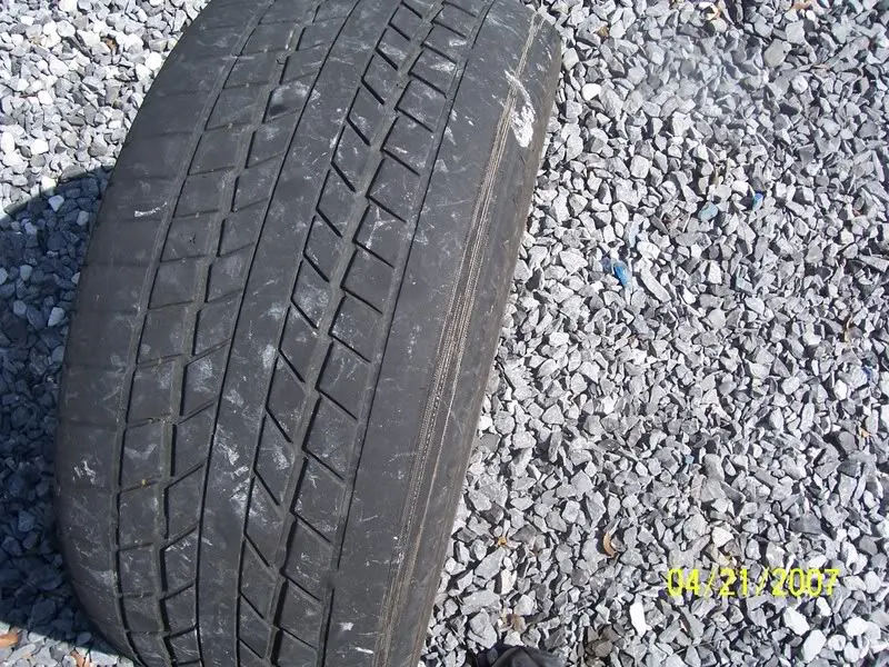

I dropped my car 2 inches and with the best alignment I could get on the stock plates this happened. Then they started showing metal, then one wore all the way through and leaked out over night.

It was caused by the alignment though. You could SEE the tires leaning in.
But I would like to check that one day. Just to make sure.
