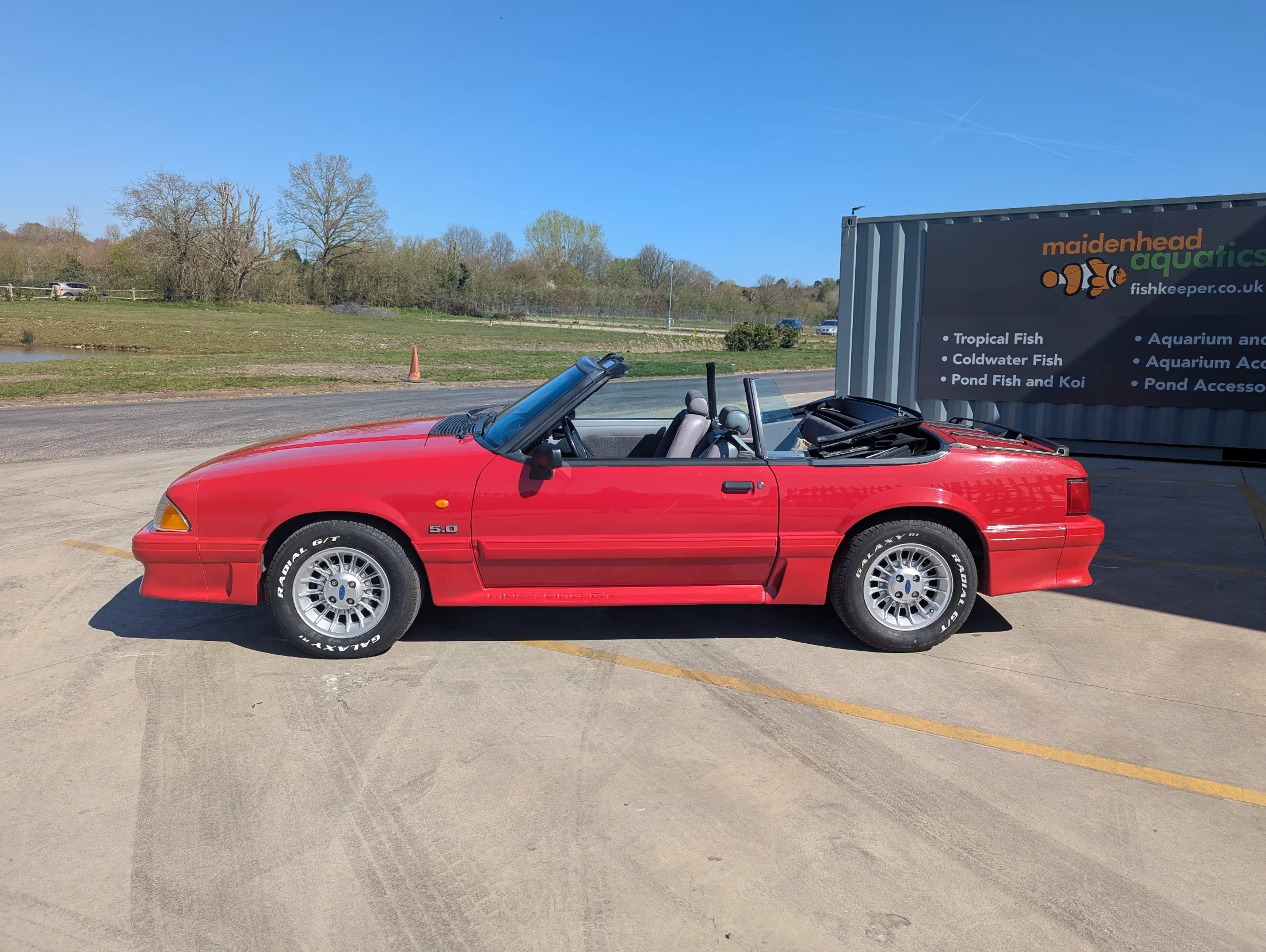

Hi folks. I've had front and back control arms, springs and shocks changed to improve the ride on my 1990 Vert - this has worked really well. Unfortunately my steering wheel now does not want to return to centre which feels odd and at times, dangerous (although the ride is way better). I've read this could be the new ball joints causing binding - I went with 'stock' LMR replacement control arms that came with the ball joints. Should I be replacing the ball joints with lower friction non-stock options? Thanks for any thoughts. PXL_20250406_111223305.MP.webp
Does the car track straight, but just the steering wheel is off center? Or do you mean the car doesn't track straight but goes in the direction the steering wheel is pointing? Maybe just needs a good alignment after all the work?
The former yes. It tracks straight but steering wheel is off centre. Also when straightening the steering wheel after a turn it feels like there is resistance to it returning to centre. If I didn't return it to centre myself the car would head to wherever the wheel is pointing

My guess is it needs a good alignment. If there's resistance to bring the wheel to center AND the car tracks straight but follows the where the steering wheel pointed, just sounds like alignment to me. Like the resistance you are feeling is you're basically 'turning' the car to center (the steering wheel center), if that makes sense.
Thanks, much appreciated. I also get some vibration on the steering wheel when braking - not heavy juddering or pulling to one side but some vibration - had put that down to the flexible nature of the beast and am installing a strut tower brace but I'm guessing alignment may contribute to that steering wheel vibration also?
The LMR stock replacement control arms are garbage. I had the same issue with them 8 years ago when I redid mine and it sounds like they haven't changed them a bit. They sent me 2 sets. Same issue with both of them. The ball joints were so tight you could hear the power steering pump beg for mercy when turning and the steering would not recenter itself. I bet if you take the tie rod off of the spindle and try to turn the spindle by hand you will have a hard time moving it. I ended up getting the Ford Racing ones and they worked perfectly, but they are no longer available from LMR. Swapping Moog ball joints in might fix it for you.

V helpful thanks. Going to ensure alignment has been done properly too

also given I am in the UK and even the US 'specialist garages' here don't see many Foxbodys do I need to find out the 'factory' caster settings/specs for them to adjust to? Thank you
Thanks - this might save me some money! Currently have no aftermarket caster plates on the car - presumably a reputable garage can still do what is necessary?
If its not lowered, just using OEM spec parts then yes should be a straight forward alignment that you can have done with your OEM strut plates.
Caster is what allows the car to "return to center" so you want a much as you can get.
If you end up needing a set of CC plates then Maximum Motorsports are the gold standard when it comes to this aftermarket part. Also, if you go this route they have suggested alignment specs in the installation instructions.
This is what I would set it to if it is completely stock:
As much positive caster as you can get with the same amount on both sides. So if one side is 3 and one is 4 then set them both to 3.
0.5 to 1.0 negative camber, again equal amounts on both sides.
1/16th-inch total toe in

THANK YOU - MOOG BALL JOINTS HAVE COMPLETELY SORTED IT!!!
