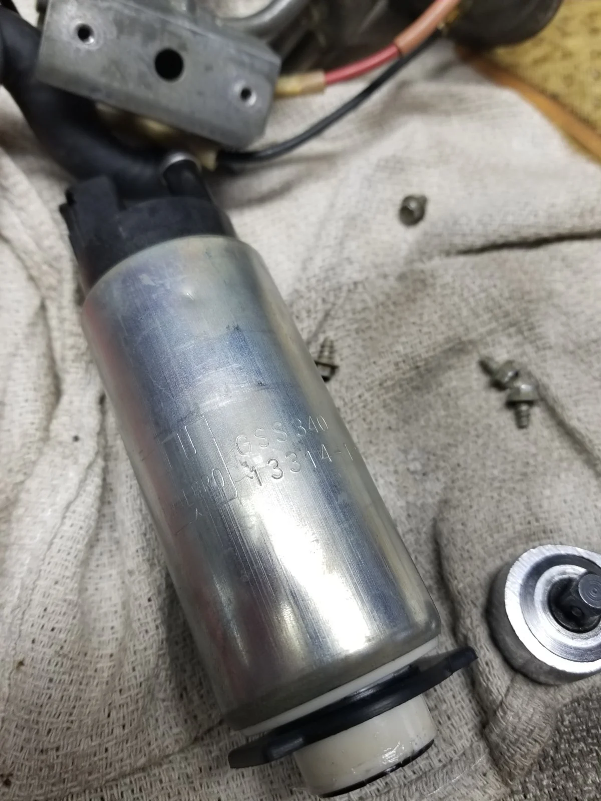

Just a quick little update. I was taking my old fuel pump out So I could put in my new 340LPH pump only to find out that there is already a walbro GSS340 in their. I saw it and was like, no way!
Apparently it's been replaced at some point in time and it's been running on the stock wiring. Now what do I do hahah?
