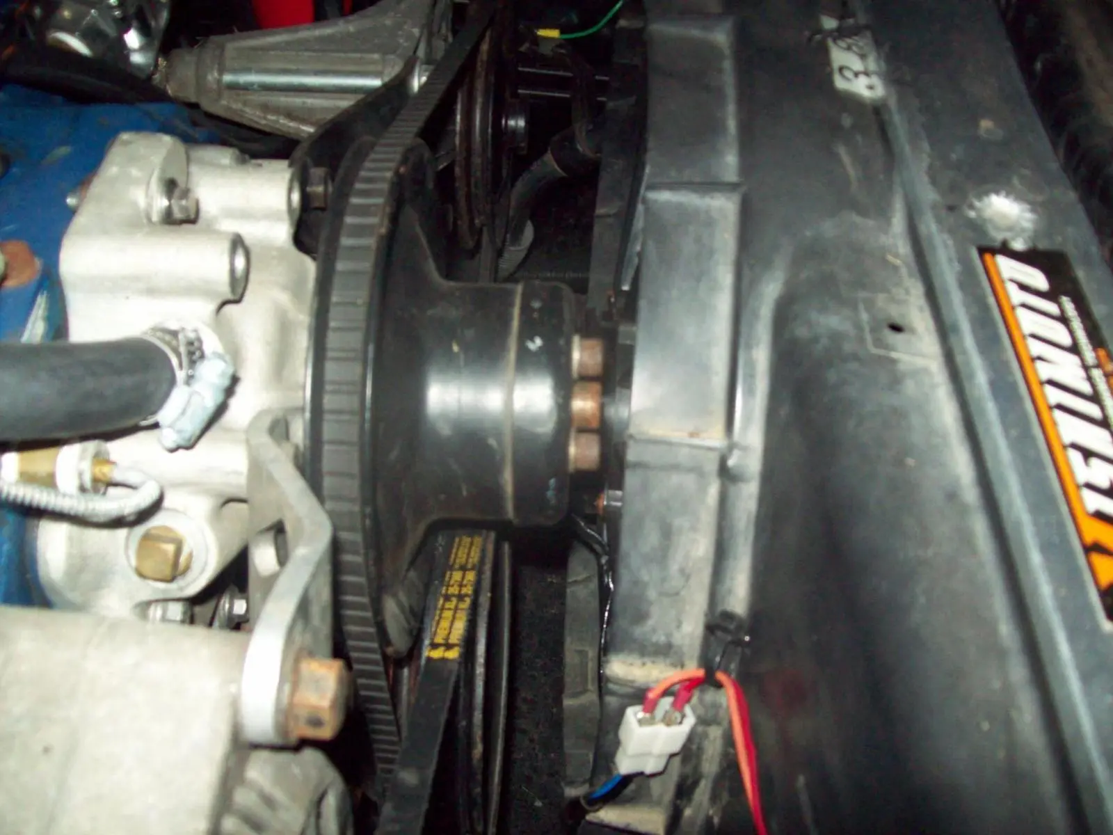

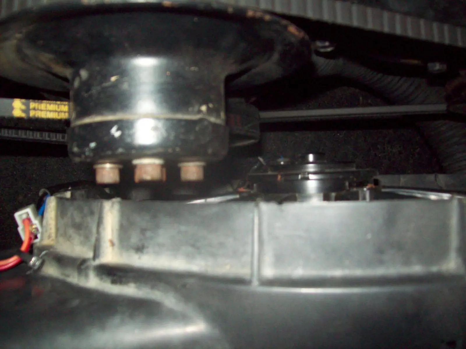

Ok guys here's the situation. I am needing some kind of setup to keep my 94 cool. I know there are other forums out there for this, but I am running a 351C in mine so clearance is a big issue. The fan+shroud cannot be any larger than factory because it simply will not fit. Right now I am running the factory shroud and a 3000CFM fan and it does good on the road, but heats up in traffic, and at red lights. I have a aluminum radiator and even did an old dirt track trick, where you drill 3 holes in the thermostat, which did help but not enough to make me feel at ease in traffic. Any suggestions on something that is as small, if not smaller than stock?

If you could trim and make it fit, a Viper fan or Mark VIII fan might help. Even trimmed, the latter is thick, which could be a problem depth-wise. Without seeing pics of the set-up or knowing exactly how hot the car is running, it's tough to make suggestions. The stock fan should have held up ok. Is it set to come on earlier than the stock settings (which are quite high)? Is it cutting out?

HISSIN50 I'll try in get a pic of how much room I have between the pulleys and fan.

The temp is usually in the low-mid 90's this time of year, but it was doing it in the mid 80's too after driving a bit and getting into traffic. Here are some pics of the clearance I have.......they aren't too good, I work 3rd shift and it rained all day today so I didn't get to snap any pics until late this afternoon, but they will give you an idea.
