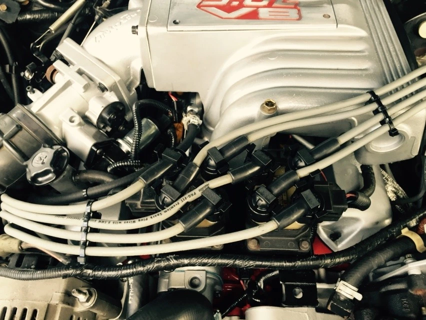

Ultimately, its an OBD 2 5.0 1995 Mustang, something the factory never ever made. And, I got to use the coil assemblies, and not a distributor.
I also want to make clear, the body harness and dash harness stuff is all factory v6, the only modifications to the car were moving around pins at the PCM connector.
And if you are wondering, I needed to repurpose some of the other circuits to make room for things like #7/#8 injectors and coil. I just deleted the rear O2 sensors, and reused their circuits to make the injectors and coils work.
The engine looks completely factory, there is not one single wire there that shouldn't be. I wanted it to look like it was built that way, and can't stand when people fish extra wires through the engine compartment. Anyway, if there is interest in this swap, i'll throw up more information.

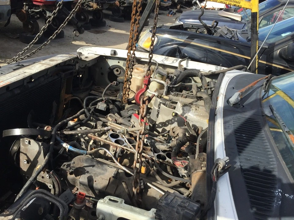

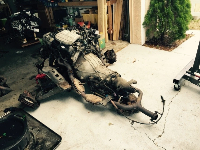

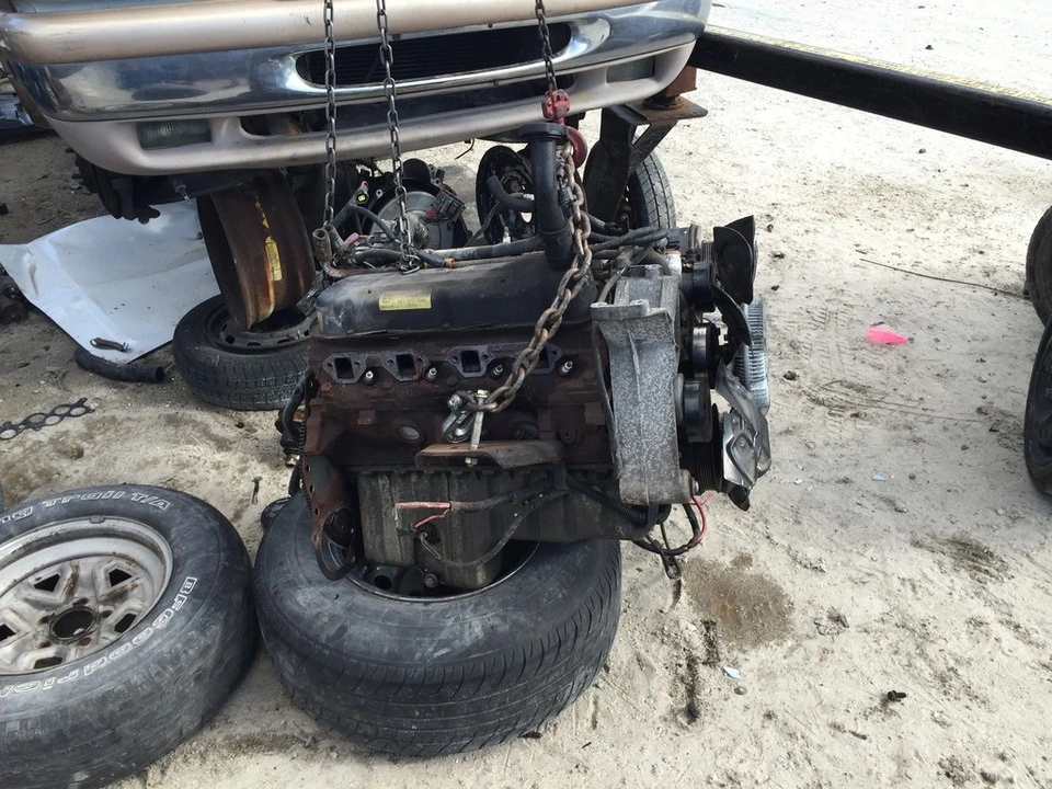

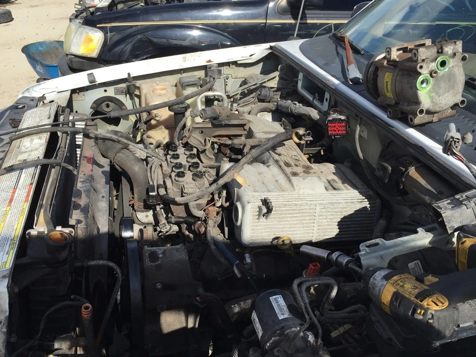

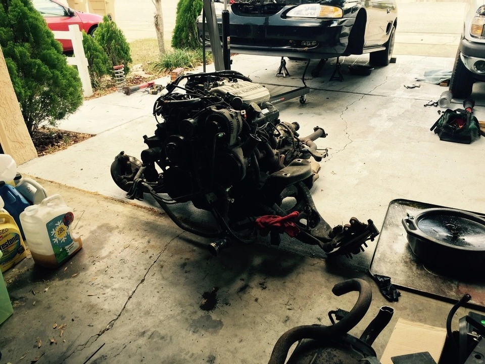

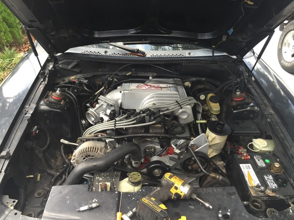

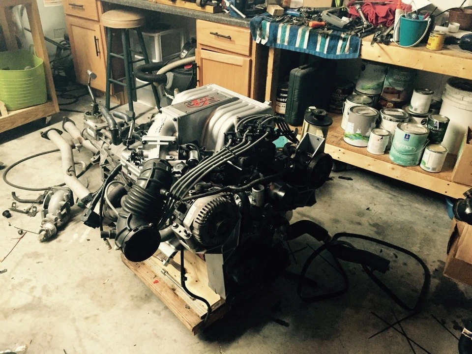

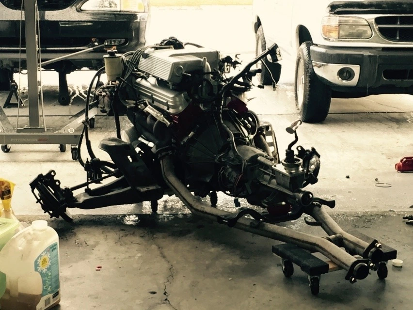

Alright, so it all began with a 1996 Donor from an Explorer from the JY. I will get more in depth as I go, but here is just a whole bunch of pictures!

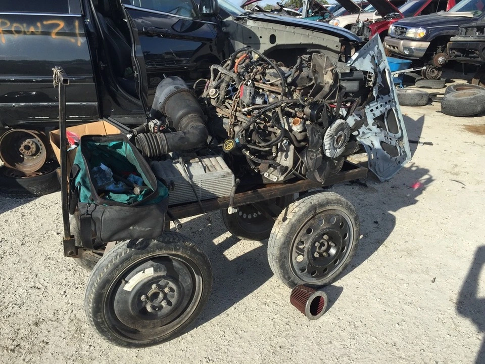

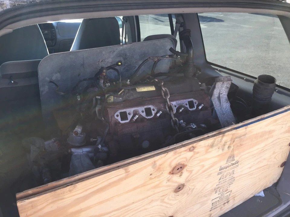

I couldn't find anyone to go with me to give me a hand, so I just did it myself. Shoved it into the back of my Wife's explorer.
Took the thing home and began dis-assembly. Notice that the Explorer uses an engine driven fan, this is something I will have to overcome later, (as of writing this it is taken care of) but the PCM will not operate the Mustang's electric fans.

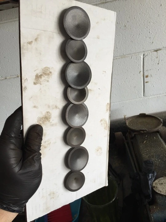

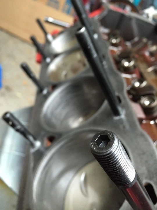

The engine was in pretty good shape, judging by the cross hatching on the cylinder walls, but I did end up honing the cylinders. More pictures of that to follow...

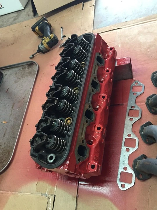

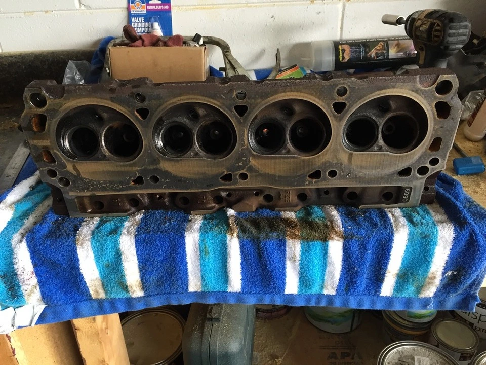

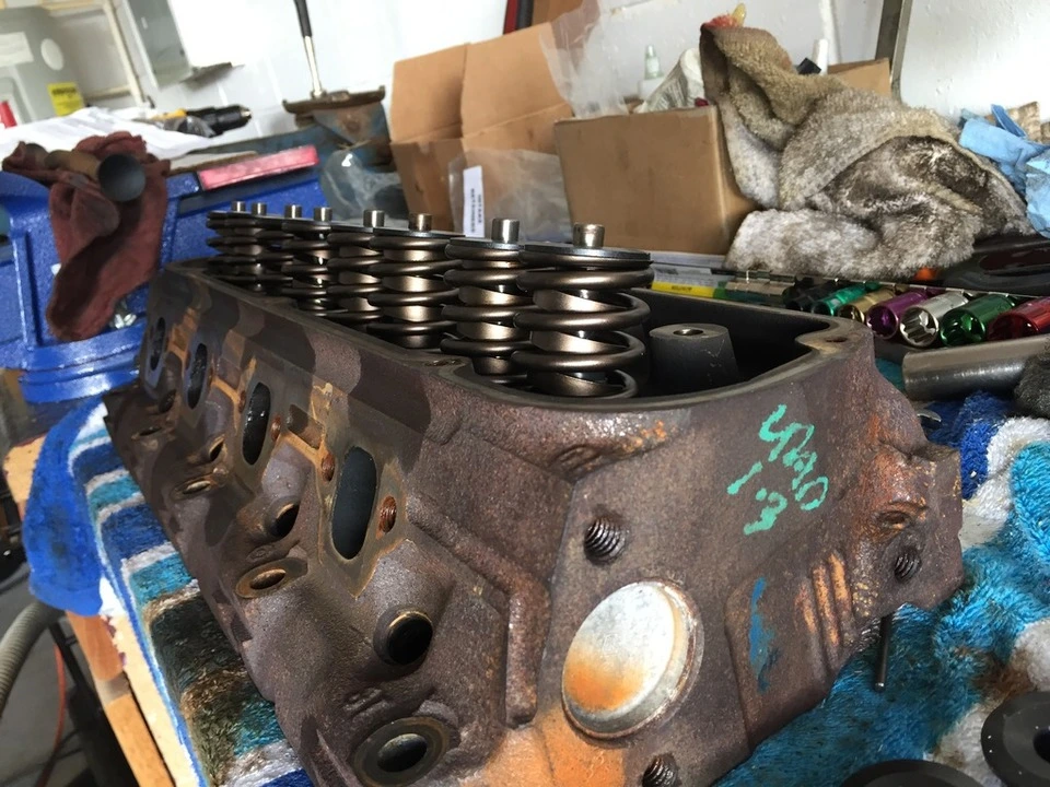

3 Bar - GT40 heads. I did not want to deal with the spark plug issues on the P heads.

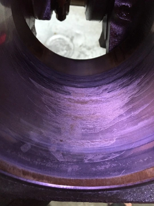

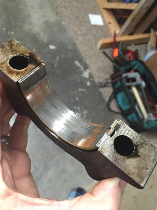

I was going to repaint the block and whatnot and pretty much stab it in the car, but it did need rings and bearings.
This came out easily with the hone, does anyone know what that looks like may have caused this? My thoughts were at some point water sat in that cylinder, given that it is not perpendicular to the piston.

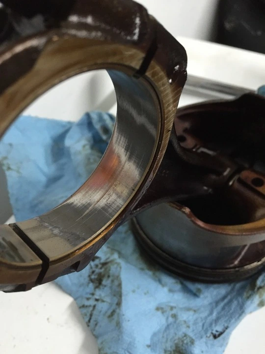

I replaced the Main and Rod bearings with Clevite parts. The rods got 270* groove bearings. The pistons got Mahle moly rings. I broke one ring during assembly and had to buy a whole new set. /lame

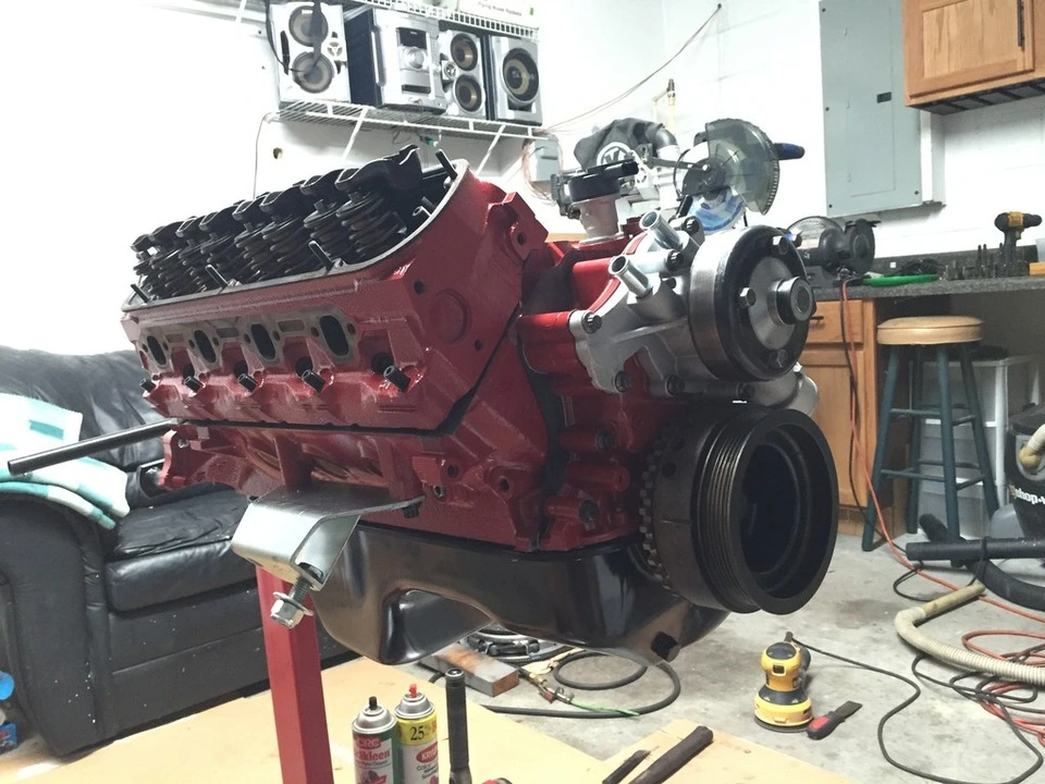

Here is a shot of the motor mostly assembled. Engine got a Ford Racing Cast Iron flywheel and an Exedy 400HP clutch. I also opted for a set of aluminum Fox valve covers, I've always liked the look of them.

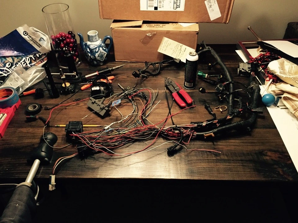

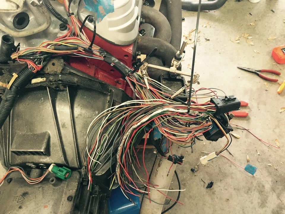

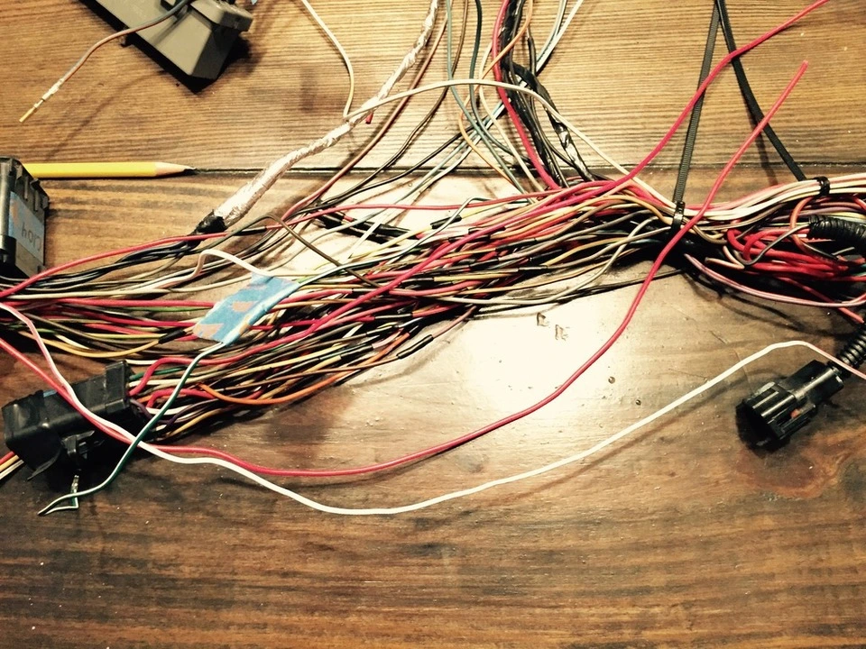

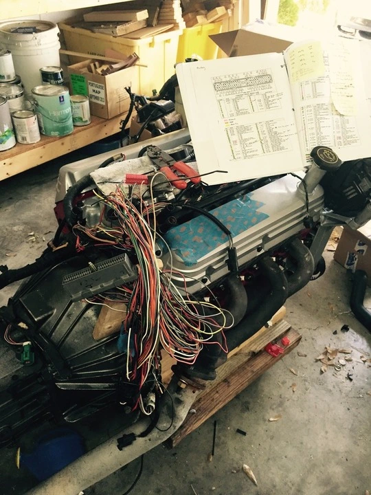

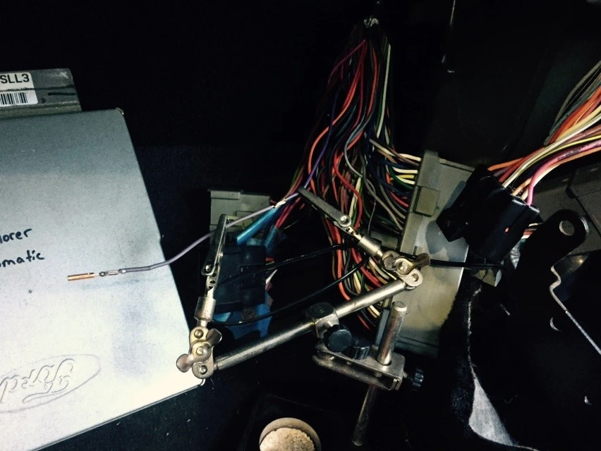

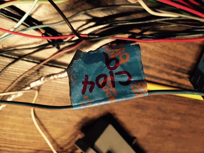

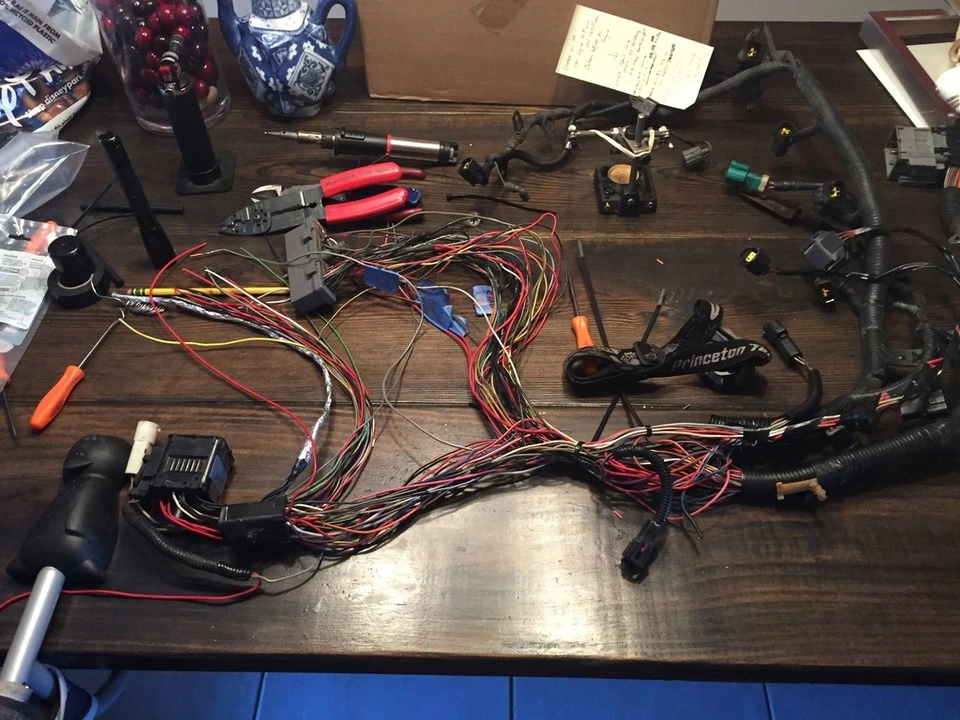

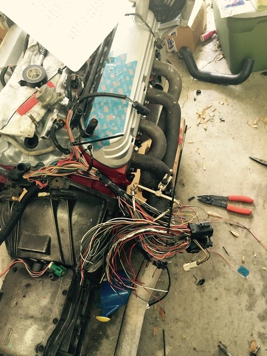

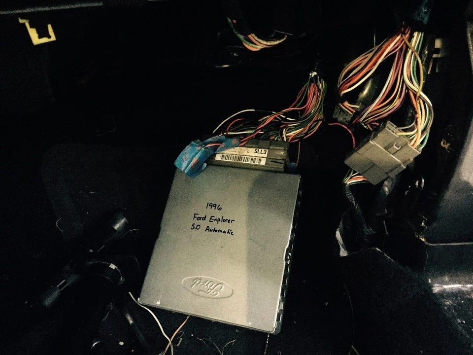

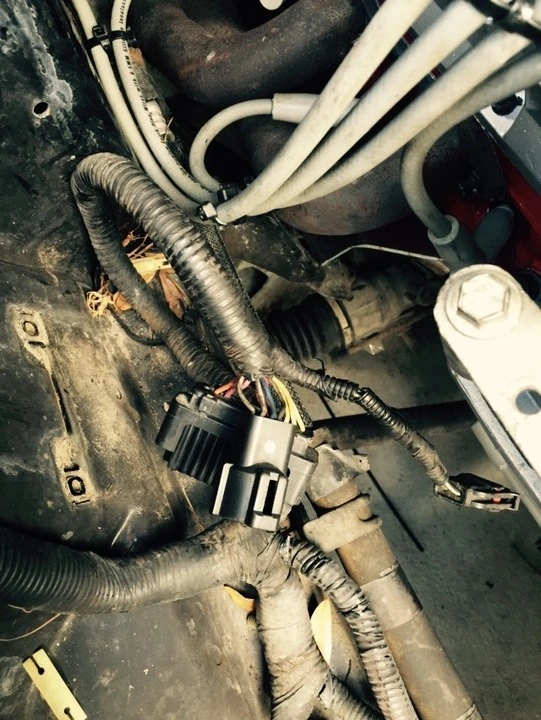

I need to go into the details of the wiring, but for now I will throw the pictures up here. I modified the harness to work with the T5 and made it to connect to the Mustang's body harness without modifying the Body harness.
Harness jumper at former Ignition Module location.
PCM connector pin location was modified. Some things were removed/repurposed/moved to a new location.

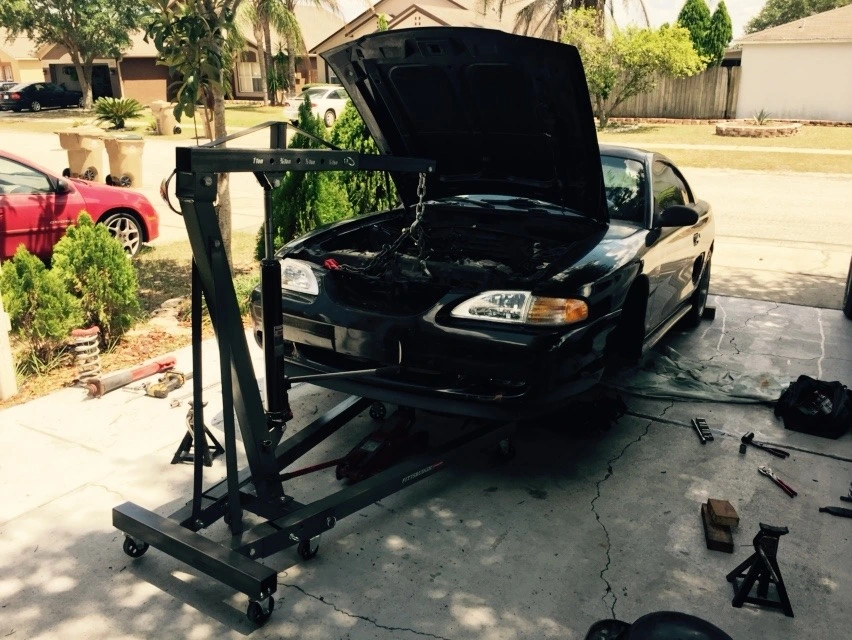

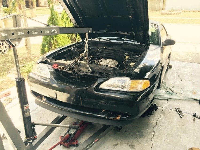

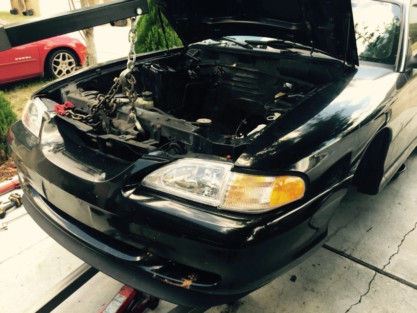

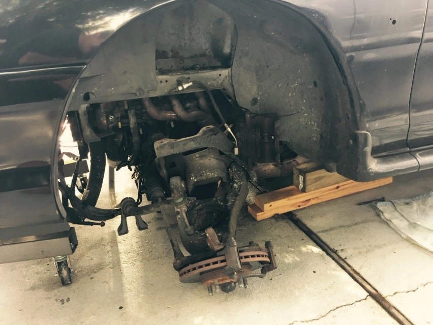

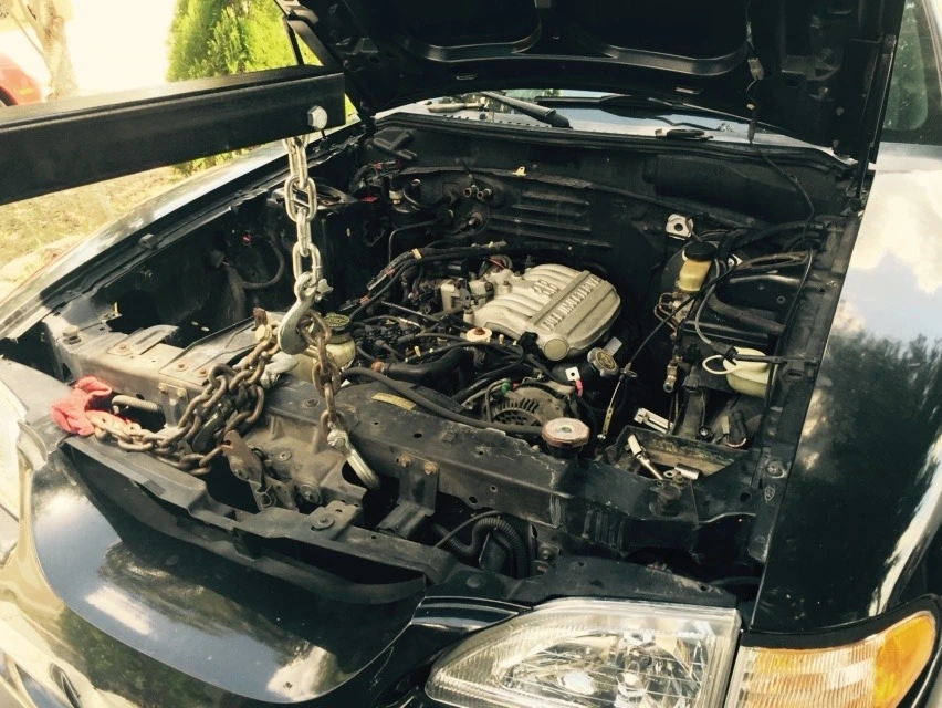

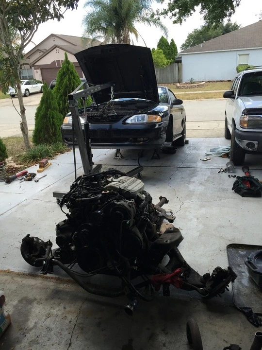

And the Swap -- I decided to do it this way after spending so much time previous to this on Mark VIIIs, this way was easier when swapping an entire drive train.
First Start!

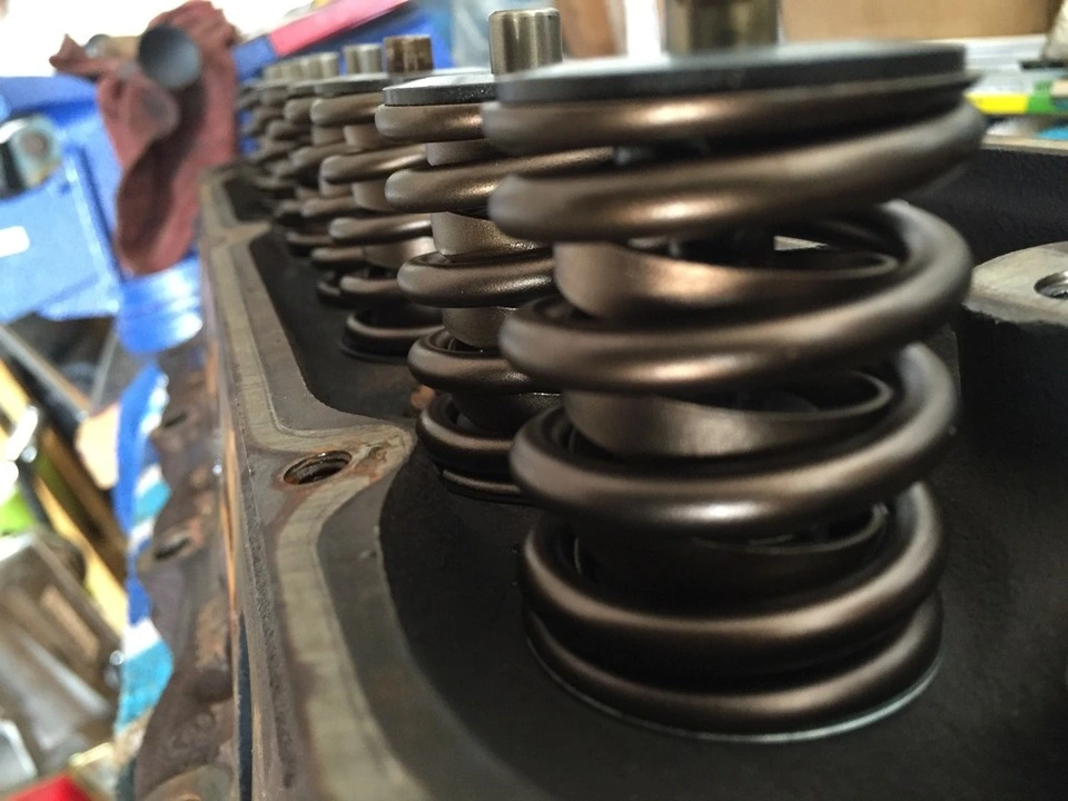

TFS Stage 1 Cam with TFS valve spring kit

Explorer PCM - Code SLL3
