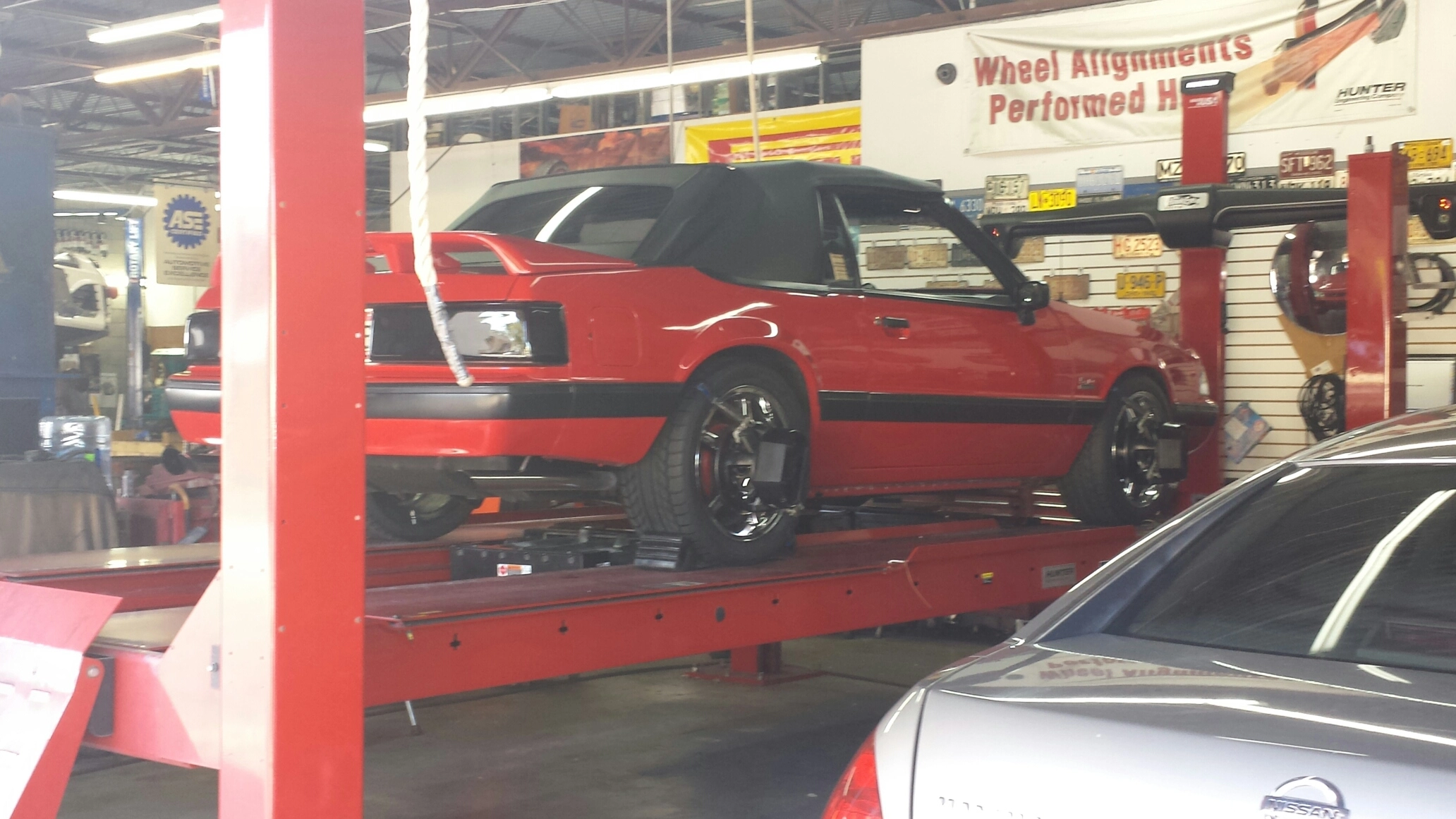

Recently, I thought I'd try a different tire size up front on my 9" SVT Anniversary wheels to combat rubbing. These front tires are 245/40-17's. They're slightly lower profile than my previous 245/45's, but are still plenty wide enough to fill out the 9" rim. As you can see my car sits pretty low. No rubbing whatsoever on the tires. The wheels however do rub a little on the a-arm at full lock. No too bad though.
I'm running 275/40 drag radials on the back.
With 245/40's up front and 275/40's ut back it gives the vert stance a nice rake IMO.

My car isn't lowered and don't plan on lowering it. Still I was worried the 17x9 rims were too wide since I had some 15x8 wheels when I first bought the car and the rim was rubbing on the front a-arm. I'm currently running a 245/50/16 on the rear which is the same as the 245/45/17 except for the sidewall width. Thanks Onefine88 for posting the pic. Looks like those 275/40/17 fit the rear well. Since my car isn't lowered and after playing around with a tire calculator I'm thinking 245/45/17 on front and 275/40/17 rear. This would give me a 25.7 inch tire diameter on both ends. I still think the front tire is too wide but the rims are 9 inches wide and that limits tire width choice. I'm thinking if there is a tubular a-arm upgrade the will give more clearance on the front so I don't have to put in rack limiters to limit my travel. Thanks for the response guys you both have been helpful.
mikestang63, what rims are those? I was just going to verify the offsets. Looks good though. I guess I was worried for nothing. Can't wait to pop the clutch with some real meats on the back. That's over an inch wider that what I have right now.
